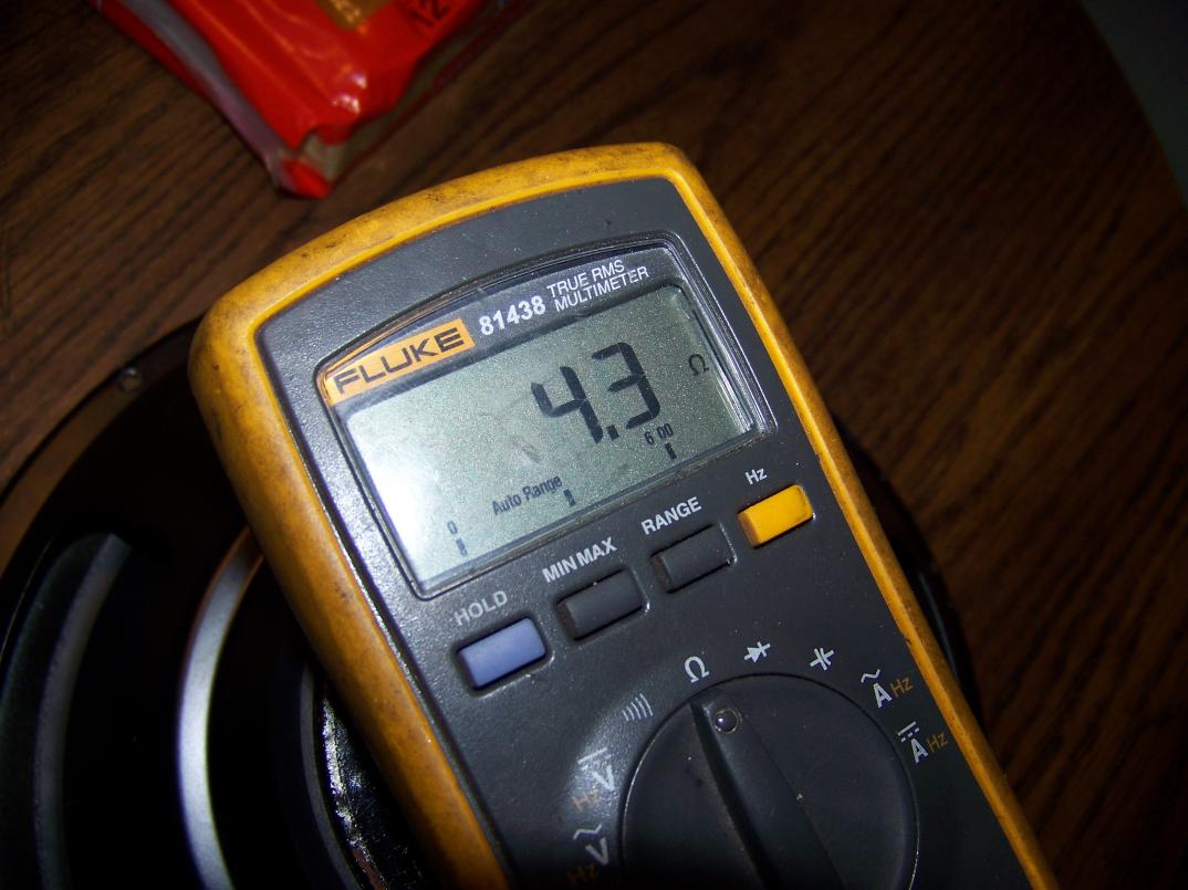

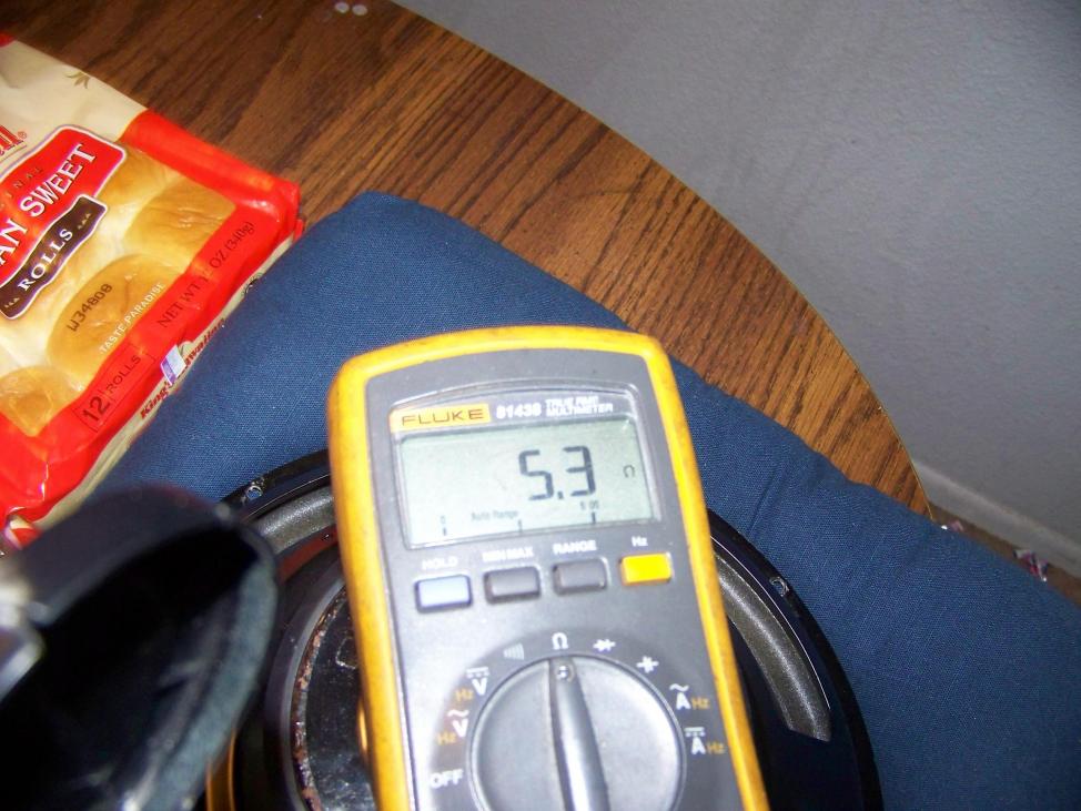

just thought I would put up some picture to help explain about the impedance reading, I took 2 pictures of my subs readings the first is on the table and the second is on a cushion (actually changes the position of the coil in relation to the magnet) this is a 4 ohm sub. think of it like a light bulb, the lower the impedance (or the thicker and shorter the coil or fillament is) the brighter the bulb will be (or more the sub will move) and the more watts of power the sub or light will consume. 4 ohms for a speaker in a car is like 60 watt bulbs in a house its pretty standard, however in many cases a 40 or 100 watt bulb will be fine in the same sense you may find or use an 8 ohm speaker (or even a dual 2 ohm sub, which is common in competition since dual 2 ohm voice coils wired in parallel is 1 ohm and that will pull some serious power from an amp, and usually some smoke too if it cant handle it!!! )
