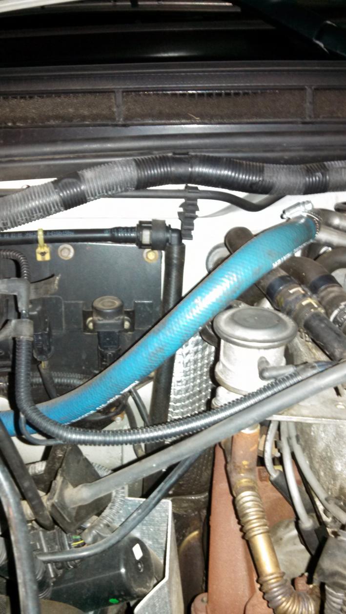

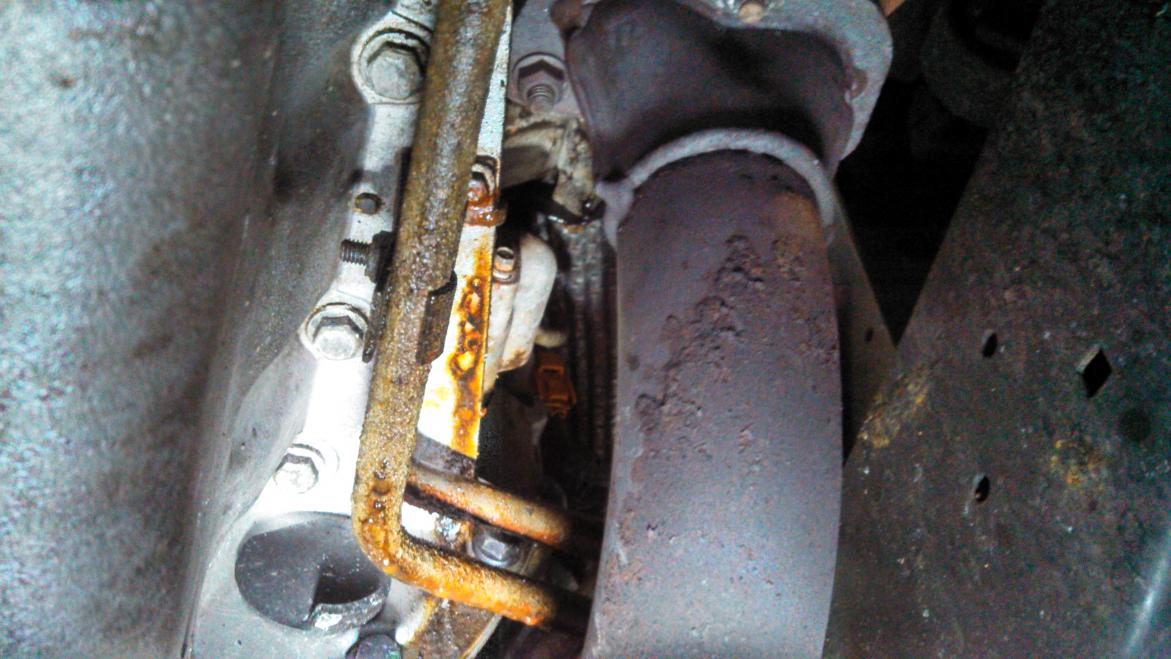

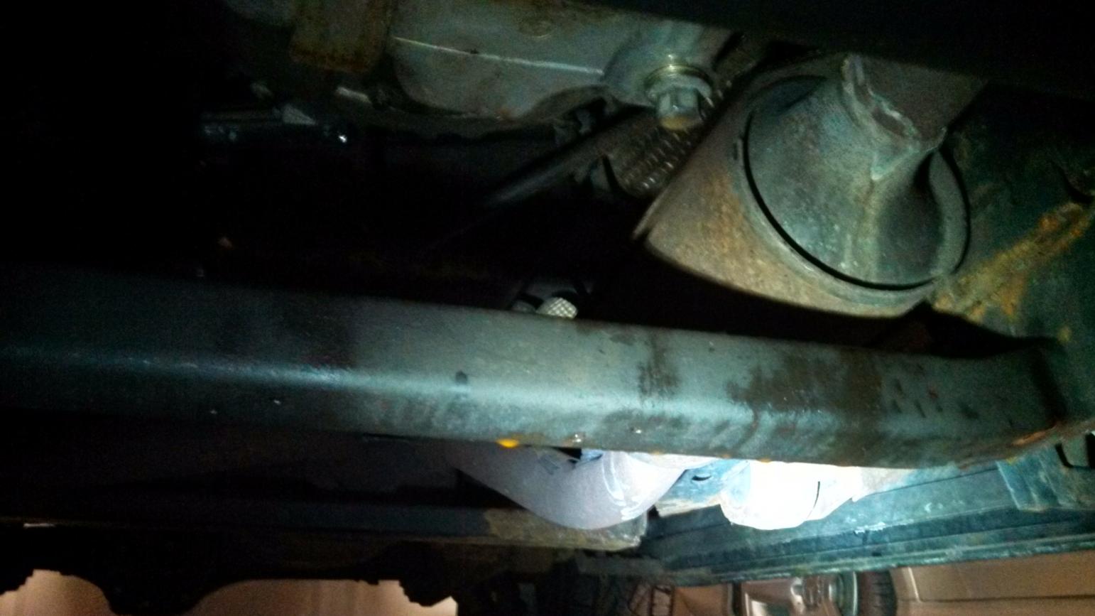

Okay, Update. Now keep in mind that I am somewhat mechanically inclined, but never owned a Land Rover so as you might be able to discern by the hour that I'm posting this, I am **** when it comes to my cars. I found a potential lead on the the coolant leak. I crawled under the car and found a cross member that had a few coolant drips on it as well as some lines above it that looked like they had some fluids on them as well (I think I need to change the oil pan and trans gaskets as well). It appears that the fluid is orangish coolant. I also found a non-stock hose (blue). I'm feeling that this is some type of trans cooler line leak? Please advise. Thanks again guys, I am so appreciative of forums that offer advice on fixes vs. my last forum which basically could only advise taking the car to the dealer, degree of window tint, and which rims were the ballerist.

Ok.. You may get lucky. You may not. That could be either the heater hoses, valley pan gasket, or the heads. Remember.. These things like to leak at the front or back of the head gaskets... There isn't a whole lot of gasket material there. I believe my 02 may be leaking similarly.. albeit not as bad.. but on the left side. Still haven't determined if it's the valley pan or head yet. I'm leaning towards headgasket because I am a pessimist.
I just got home from work btw.. I all morning poking the rover with sticks looking for broken stuff. Lol
