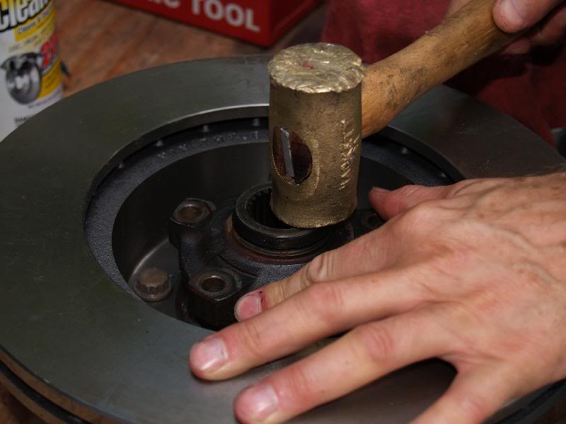

I would have some new grease seals ready to install. You will have to pull the axles on the rear to get the rotors off. Re-pack all of the wheel bearings and inspect them well. Might have a bearing on its way out. I would change the diff fluid out while you have it up. This is not a 1 hour project. The brakes are a little time consuming. You will have to pull the drive flange, take off the wheel bearings and hubs, put the hubs back in a rim to break the rotors, clean, re-grease and re-assemble everything. Torque to specs and use thread lock everywhere it calls for it. That is just brakes

Read the shop manual, but in simple terms
Remove the caliper (hang it out of the way with stiff wire) (13mm 12pt socket) On refit use Loctite 270
Remove the drive flange (17mm socket) On refit use Loctite 270
Remove the hub nut (52mm)
Pull the hub off
If you have an impact wrench use a 13mm (I think) 12pt socket. If no impact, do as others suggest and stick the hub in a wheel and have at it. On refit use Loctite 270

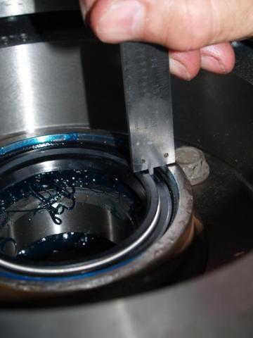

The RTC3511 seal get's recessed 4mm.
The front drive flange works well to recess it evenly, but don't go too far.
