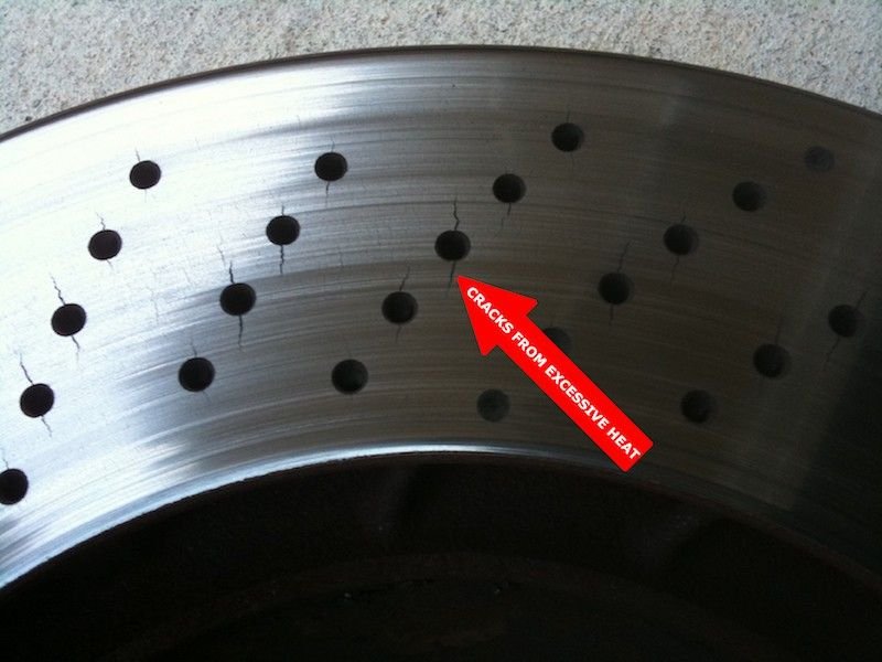

Originally Posted by Gripen
Eventual cracking. The drill holes are big stress risers for the brake rotor. Over time, the thermal cycles that a rotor experiences will cause cracks to develop around and through the drill holes.
Did anyone experience such issues on a D2 or is this just a theoretical assumption?

Not sure if anybody has had it on a DII, but there are enough Porsches, Miata and other sports cars out there that are a lot lighter cracking their drilled rotors.

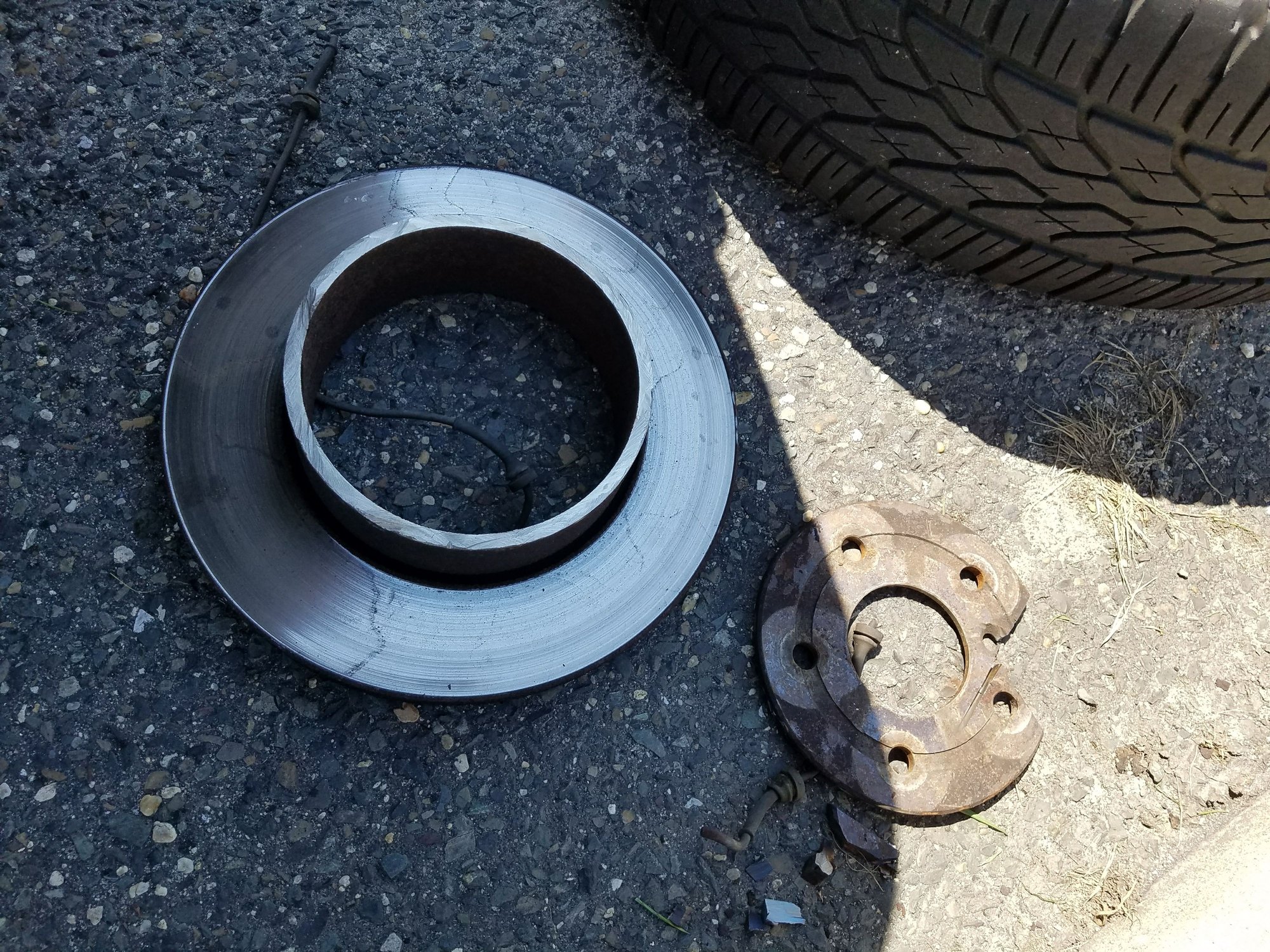

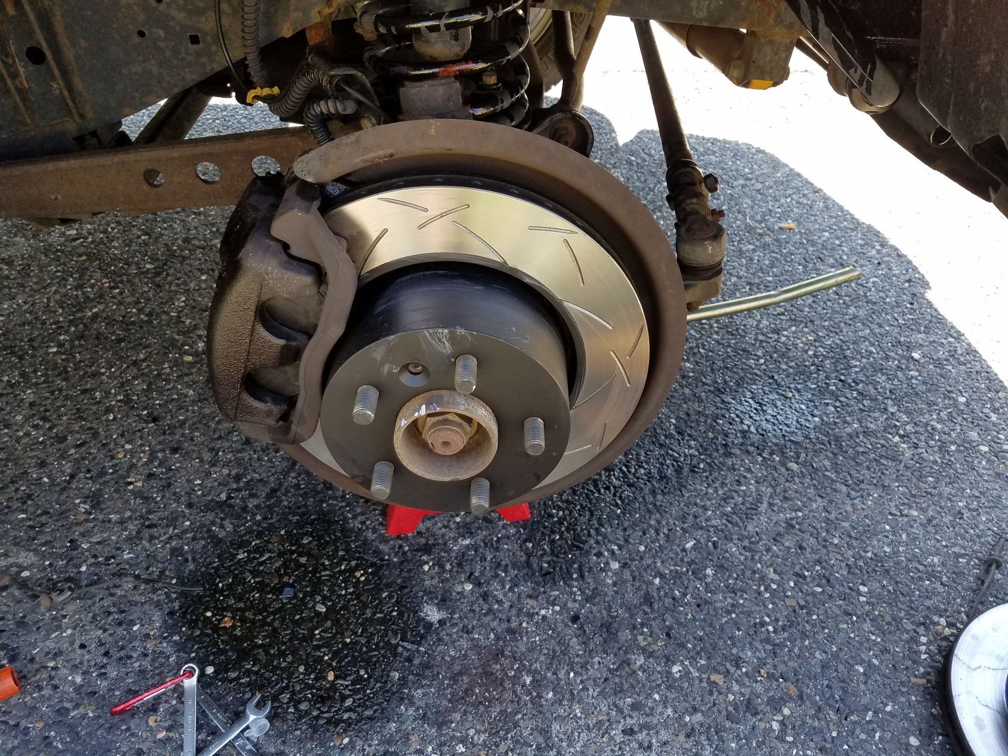

These are mine.. DBA (Disc Brakes Australia). The small slots keep the pads from forming gas between the rotor and the pads, and they look good.
It took a grinder to get one off too.

As much as anything, the cause of cracks is cheap metal being used. Any rotor will fail once it is exceeds it failure point. Plenty of Porsche rotors crack, on the race track, where it is expected and not a big deal. My GL450 is nearly 3 tons and I drive the **** out of it, with drilled rotors, no issues. A short time on the track in my 911 can cause cracks.
The issue is not holes or slots, its the quality of the rotor, how you drive and your expectations.
