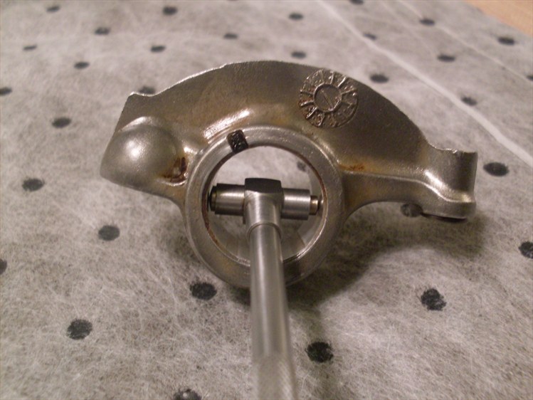

04 Disco- 92,000 (head gasket changed by LR at 60,000)
here's the chain of events-
- ses light comes on
- since i dont have a code reader and busy with work i waited a week to get to mechanic
- after a week of solid ses light, i start the engine, light starts to flash & misfire. i drive directly to LR dealership
- LR diagnosis: 1 bad coil pack "suggest" i replace both while they are in there. LR labor is outrageous (but you already knew that)
- Drive disco to independant import place. they tell me that i need both coil packs (fine, their parts and labor were 70% less than LR)
- After replacing coil packs, truck still misfired and back fired they said.
- spent a day checking valves and etc.
-Problem found... BROKEN ROCKER ARM
My question, seeing that the truck has had regular LR service from the PO
and even though i waited a week to get the ses checked out, how the heck did it go from 1 coil pack failure to broken rocker arm?
not to say that LR wouldn't have had the same results but i'm wondering if i should have just let LR replace the coil pack for the $$$$ and i could have saved at least $
Unfortunately, my tools consist of those used for building sets and houses. Maybe i outta invest in more wrenches

I don't think I would let Land Rover do anything to my truck. I'm not even so sure they know what the heck they're doing, as sad as that sounds. Always best to find an indy shop with people who really love and care about what they do. What did changing the coil packs do? Any change at all? I suppose with a misfire code and nothing strange going on with the plug in that cylinder that would be at least a logical place to look after checking the resistance in the plug wires, the coil's the next step down the line. I don't think the outcome would have been any different if Land Rover had the same suggested diagnosis to begin with unless they tested the coil packs and determined that they were good. They probably would have ended up finding it, maybe sooner, maybe later but their labor AND parts costs are absolutely over-the-friggin-moon outrageous and ridiculous!!! I highly doubt they would have saved you anything, money or trouble.

Rover dealer are the "WORST" possible place to go have an issue delt with.
They called it wrong, it was never a coil pack. Then again you are at fault, why wait a week to get the codes read, any parts store will do it for free.
A rock shaft and arms is an easy fix. If you want some help, send me your number and I can walk you thru it.

Mike is right, I changed my rocker arms and shafts a few weeks ago. Mine were just worn out, not broken but, my engine is a little quieter now. It really isn't hard to do and you can get the parts for just a couple hundred dollars. You can get them from DAP, they have the rocker shafts for I think, $44.50 each and the rocker arms for $7.50 each. and the plenum gasket for $12.66 http://dap-inc.com
You may want to get new plug wires while you're at it if you haven't done them yet as you have to remove the plenum to get to the top two bolts on your valve covers. As I posted before, if you do this be careful of the steel inserts in the v/c gaskets if they have been in there a long time, two of mine fell out of the rubber gasket and right down into the lifter valley. I noticed they were missing and couldn't find all of them. So if they're not still in the gasket, not on top of the head, and not on the floor they may be in your engine. Also, I couldn't physically SEE them in there I just had to fish them out with a magnet. Hope this helps you.

well... rocker arm was replaced but when i picked it up from the shop, they said there still was a tick and suggested i do the BG service to clean out all the carbon.
(thanks PO for not using premium...)
however after driving the truck about 12 miles, ses and misfire again. also no oil registered on the dip stick.
I had the truck towed back to the shop and they told me the same rocker arm broke again, and that i need a valve job.
Now if LR, who told me they replaced the head gasket at 60,000 just replaced the gasket and moved on, then well, i get it.
I'll give them a call on monday, but im sure they will be just as rude as when i called them the first time to ask about service that they did for the PO. Which apparently was regular since it was a lease
I do keep a little $ aside. Since im more of a jack of all trades, master of none and wood is a little more forgiving then the aluminum that powers my way to work in the morning.

The shafts being worn may well have lowered oil pressure, so other engine parts are likely worn heavily as well, like main bearings. You are seeing just part of the problem. Thicker oil won't help at this point. You could also have a slipped sleeve thrown into the mix that is also ticking.
These can all be fixed, and there are posts and write ups on this site to guide you. along with the shop manuals. But you need tools, and a place to work, leave engine torn apart, etc. And $1000 is a very common figure to burn thru on a new-to-me Rover with minimal problems.
