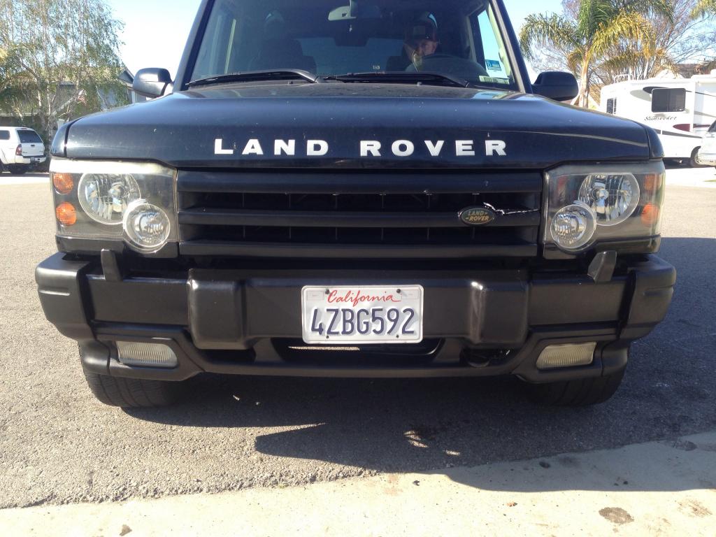

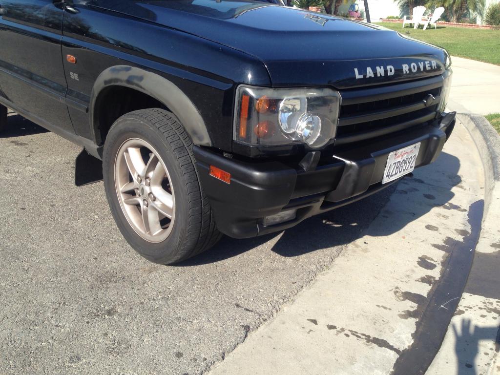

Here is my friends 03 with a D1 front bumper. It looks a little better in the photos as there is a slight gap at the top which shows the water bottle. It bolted up direct with no modification.
I stand corrected. Actually, that looks really good. I might have to look into one to replace my cracked bumper.
