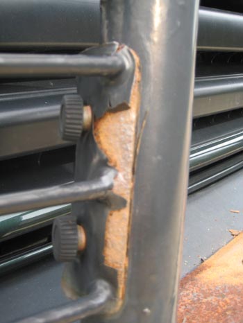

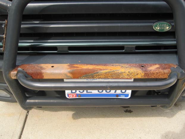

heres the brush bar. is this thing salvageable or am I wishing for too much. why it would rust so much being garaged its whole life I have no idea. And with such few miles. Im thinking maybe the local powdercoater can media blast it down to bare metal again then coat it?
its like the bar rusted from the inside out. The paint is thick like cardboard and wants to peel off away from the rust.

Thats exactly what it did was rust from the inside out, it is soup can material now.
You still have your headlight covers on, they are not water tight (they srew on), so rain water and condensation sitting inside there just rusted it out.
being garaged has nothing to do with it.
When I bought my LR grill gaurd (used) I removed the headlight grills and plugged the holes and then wire brushed and painted the whole thing while off the truck.
I think sand blasting it it will turn to dust.
Wire brush it and then paint it with Rustoleum and then look for a new one.

i figured it had to be a rust from the inside out job, but couldnt figure out how. i did notice those thumb screw type things on the headlight guards (which had since rusted themselves un-screwable).
Looking at the bottom where the bar is mounted to the car, it appears there are just two long bolts/screws on each side and thats the ONLY attachment point, though it does "appear" like the front of the bar sort of rests on the front edge of the bumper. Whether it rests barely on it or butts up against it, I guess I wont know until I get it off.

Well the good news about those thumb screws is if you take a pair of Channel-Locks to them they will snap right off and then the gaurds will come right off.
