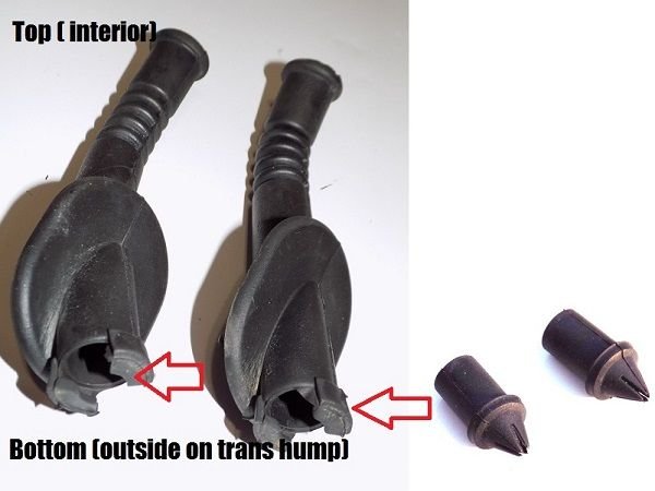

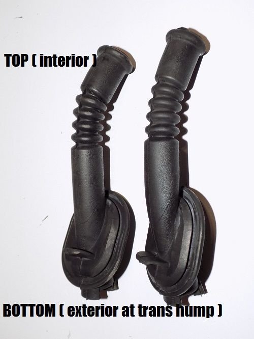

Old Jun 27, 2017 | 09:45 AM
OverRover's Avatar
Posts: 2,514
Likes: 656
Originally Posted by Luckyjayb
My driver's side has a hose connected to the nipple and the passenger side doesn't. I'll have to get a wire clothes hanger
Go VERY easy with a wire hanger to "clear" a/c evap drain hoses. OR use a small diameter clear plastic hose. These drain hoses are NOT a hard plastic like a sunroof drain and are easy to put a hole through. You can see in the pics that the hose is corrugated and that's where a wire will make a hole. It's also very easy to knock the hose off on the interior (top) with a coat hanger wire.
Also when you pull back the carpet to expose the drain, for piece of mind put a small amount of RTV adhesive on the top hose before you reinstall. Put some RTV on the floor grommet too. Works like a champ.
Keep in mind these drains usually only get blocked at the very bottom nipple like Best4X4 mentioned. I remove these as well on every RRC, DI, DII for years. Good Luck!
