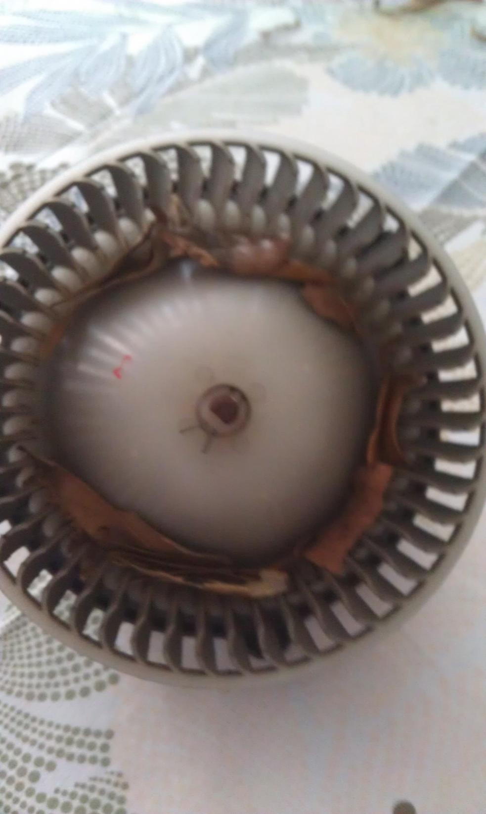

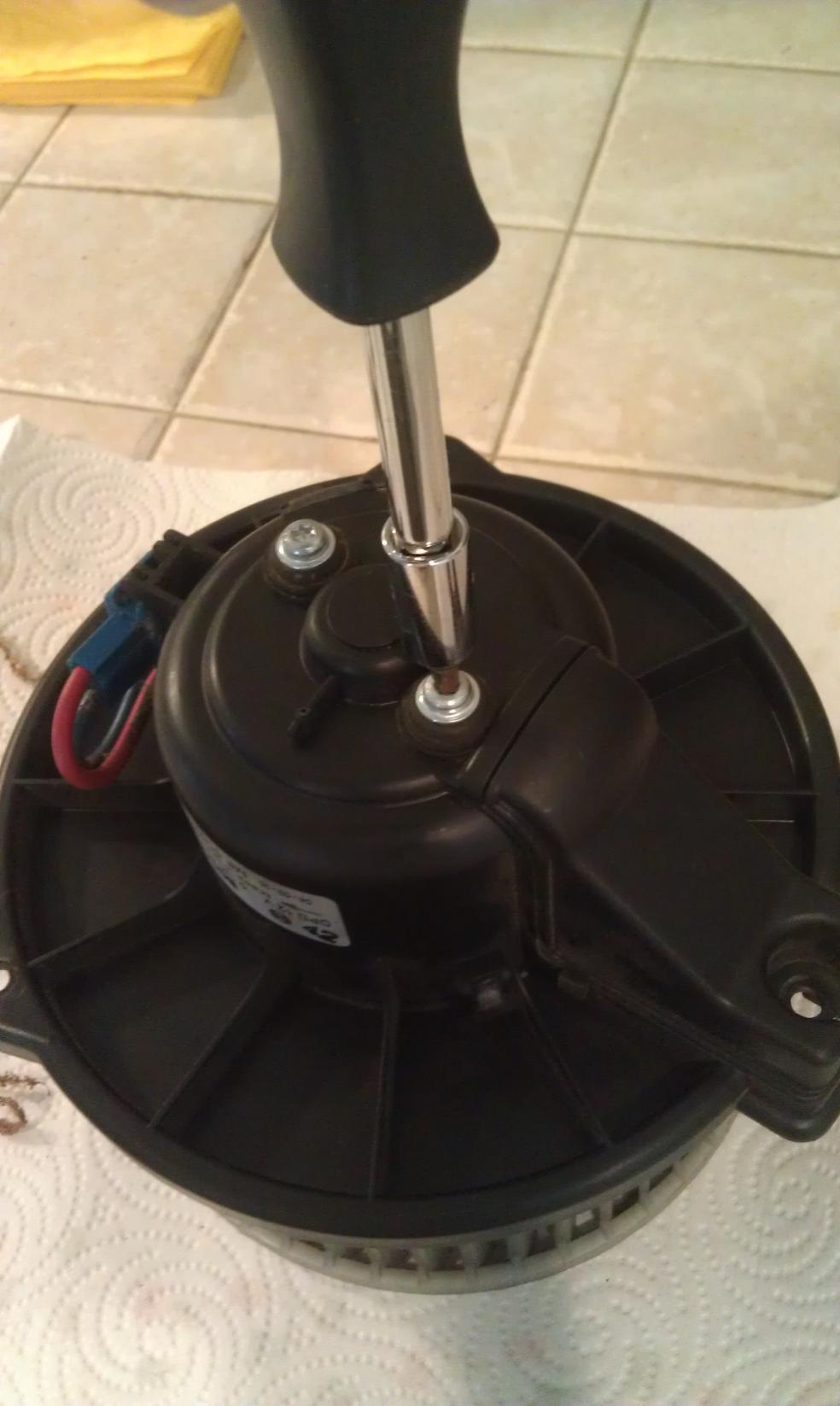

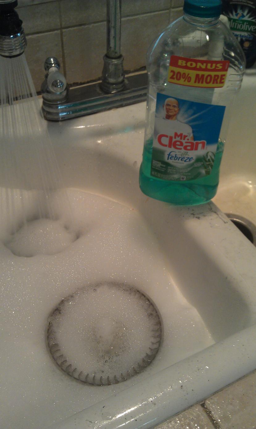

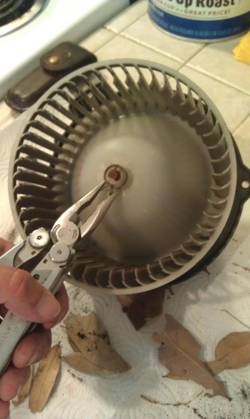

Thank for the write-up! Just did this and my fan was filled with leaves...
Also I soaked the cage in a Mr. Clean w/ Febreeze & water bath for about an hour then let it all air dry before putting it back in the truck. My a/c smells wonderful now Overall, this was a 2 beer job and would be ok with doing it annually.
