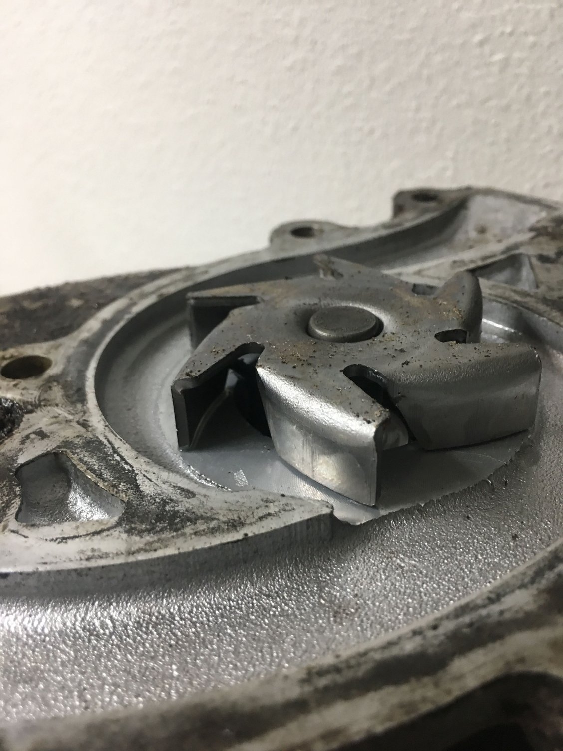

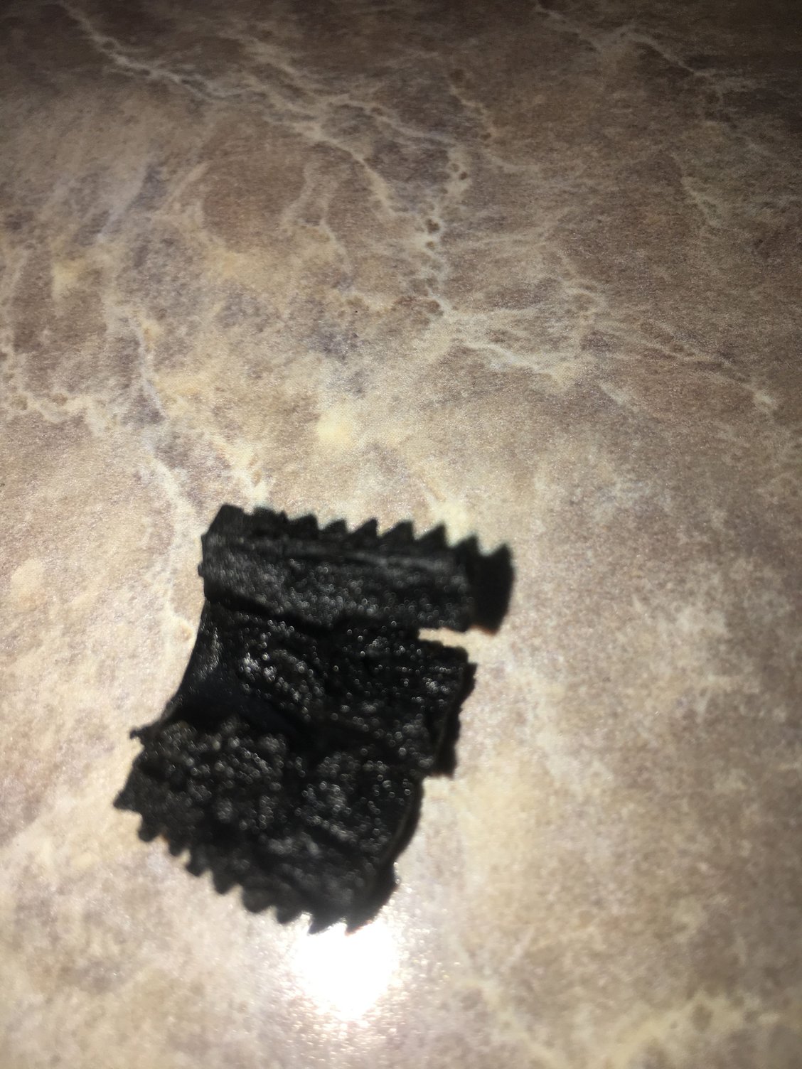

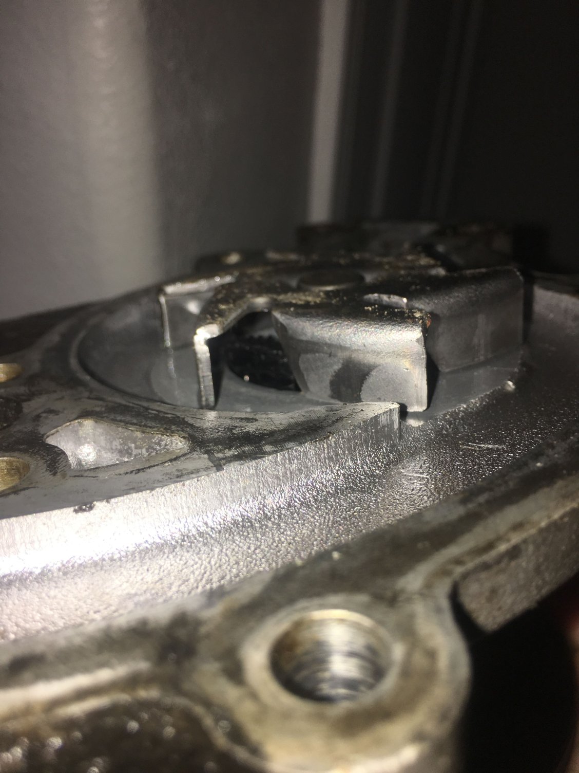

On my 97 XD I had noticed the WP pulley had a little play in it, and it also made a creaking sound whenever you turned the engine off. I ordered a replacement WP, and when I removed the old unit I was shocked to find an old D1 radiator plug wedged up inside of the impeller!!! There was probably 65% of the plug up under there. The XD has a new Nissens radiator so it’s from a previous radiator. I could only get one piece out and that was by prying it out with a screw driver. There is no way that WP was pulling the usual amount of coolant with that crap up inside the impeller!
On the Britpart look up inside of it. It should be stamped 78C. They’ve worked really really good for me!
