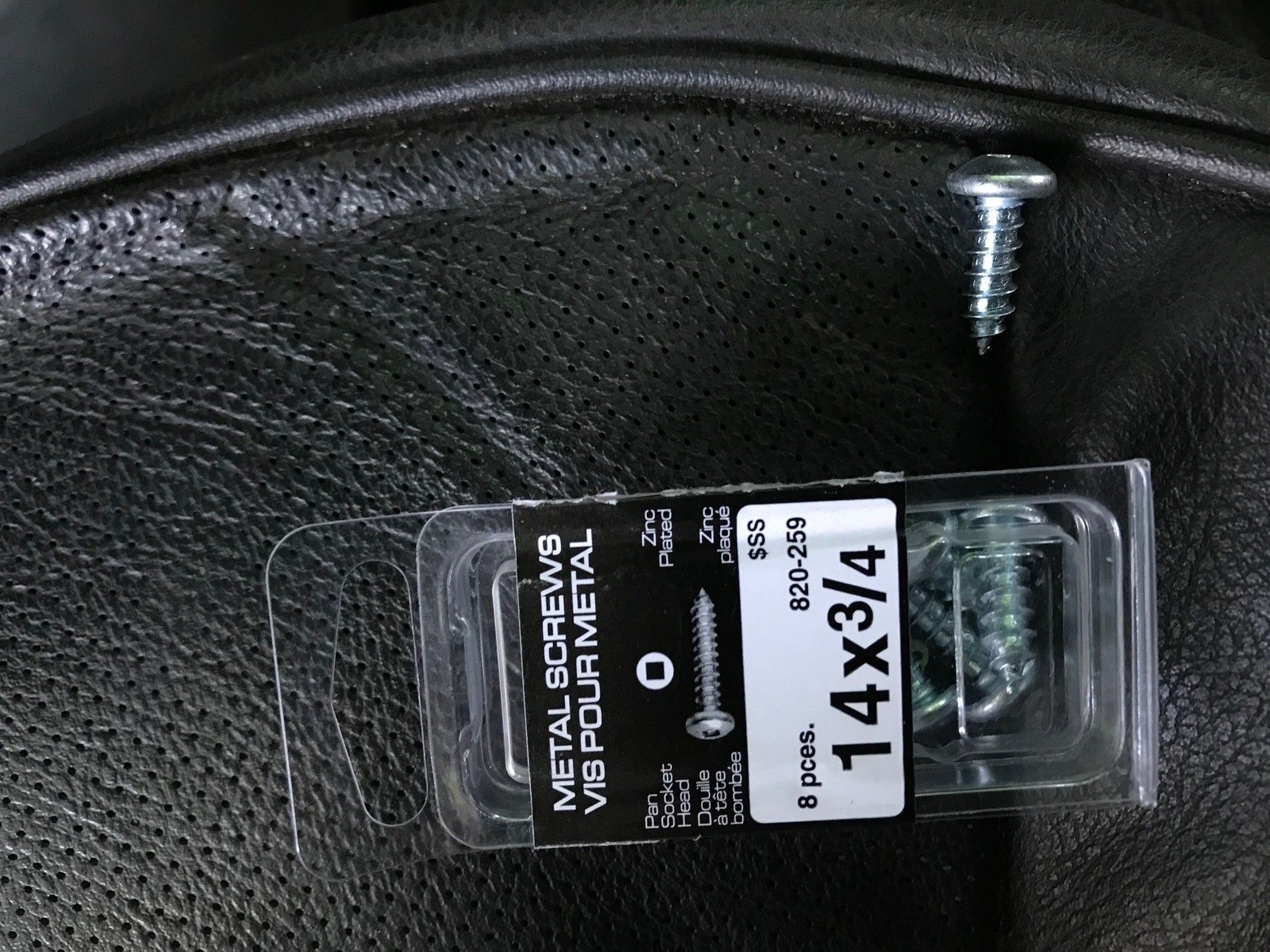

Use these mounting screws instead of rivets when you put the center console plate back together. I got mine at Home Depot. Makes it easier to get to in the future.
