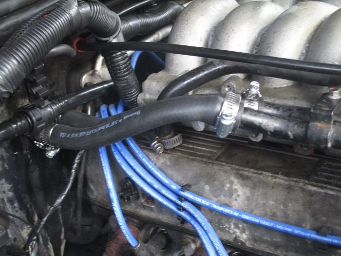

Was slowly losing antifreeze last few weeks, and hoping it was not the head gasket. Doing 55 down the road in a T storm last night and BAM! huge cloud of steam blocking windshield and coming through the air vents. 2 hours later, soaking wet and home after a tow (THX AAA!) went through the engine bay and found a ruptured heater hose (probably 20 yrs old!) Anyway, 5/8th hose, x4 clamps, and a jug of green antifreeze and back on road today! LUCKY!!! No overheat, no issues. Careful with the heater core fittings. They are thin aluminum.

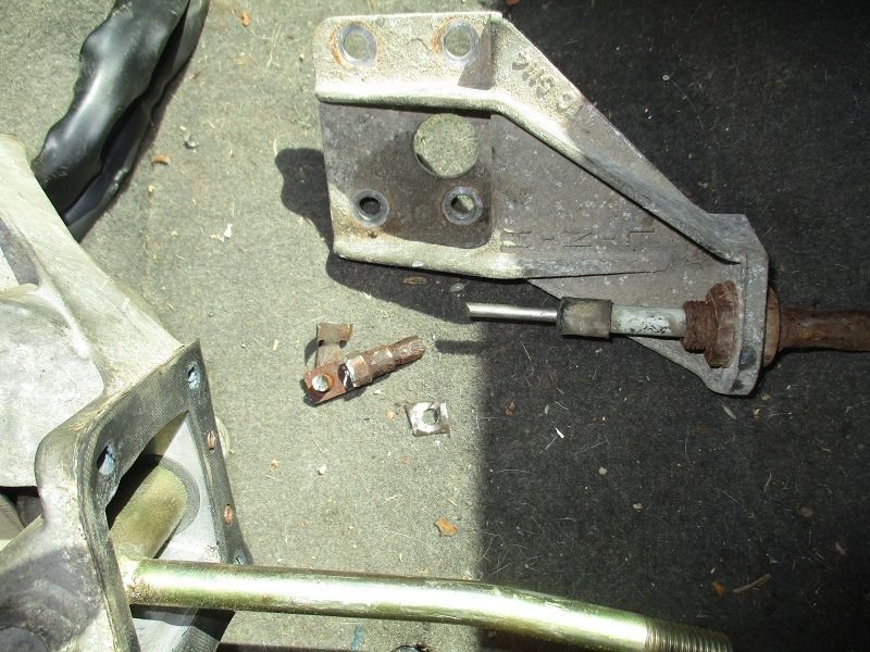

installed an 04 diff lock handle and cable. Not fun! Had a rusted H/L pin on the diff, and the H/L cable tie down 10mm bolt way on passenger side was a real PITA to get out. Had to dremel with a fiber cut off wheel all the rivets and the rusted cable pin. Someone was in there before me and quit half way through. Only some rivets removed and replaced. Front three were original. I machined out the cutout for the diff lock arm (just follow the old gasket pattern). Got it all mostly installed, and the diff lock works fine, and H/L works fine. The ABS/TC/DIFF lights came on so I know the diff lock switch works. Have to install my 2004 SLABS and see what happens....
So a few things I did:
-make sure you have all the new/old good parts ready to go INCLUDING all the clips and pins.
-10mm socket and mini breaker arm (no room for ratchet head) for the H/L cable passenger side mount.
-The four bolts for the H/L diff cable mount and the 2 bolts for the Diff lock cable mount are in VERY tight and thread-locked. Don't strip them, get a good 6 pt socket seated correctly. Going to need 3/8 strong flex joint to get a few of them out.
-I removed the neutral lockout solenoid front the diff lock selector
-Also, no need to mount the sheet metal shifter piece back underneath! Remove the old foam, add some single sided new 1/16 foam to the new 'bottom,' and with some stainless 1/4? self tapping sheet metal bolts(ace hardware), mount to the top of tranny tunnel. Much easier, and easy to open if needed. It raises the shifter by about 1/4 inch, which also keeps the selector cover from popping off so easily.

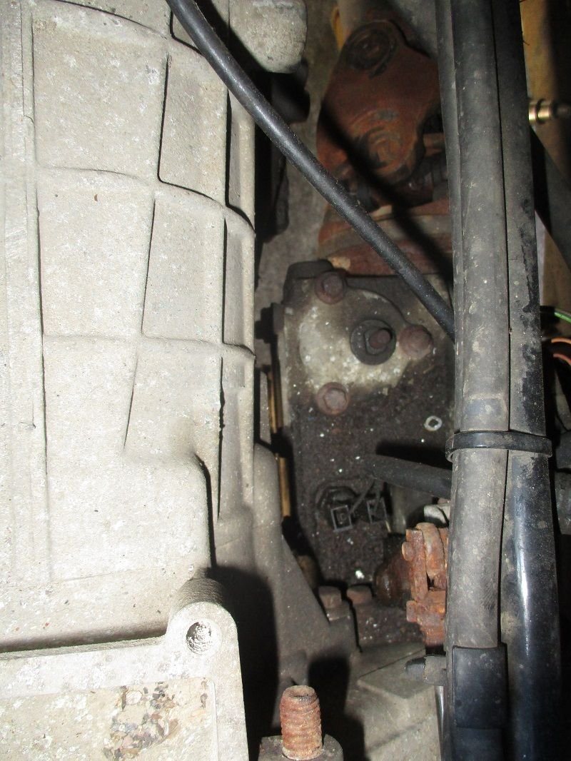

One question: There are three hard black plastic breather tubes laying on top of the trans/diff. One goes to the diff, one to somewhere mounted, and one is just an open tube (on top of tranny). all three are connected together by a snap clip.. I do not have a pic. Is the open tube normal? It had a smooth end and did not look to be broken off..... EDIT: Never mind, Found the answer here:
https://landroverforums.com/forum/di...eciated-80799/
it's a curved back breather from the transfer case and should be like it is....(see first pic ....borrowed from info thread cited above)

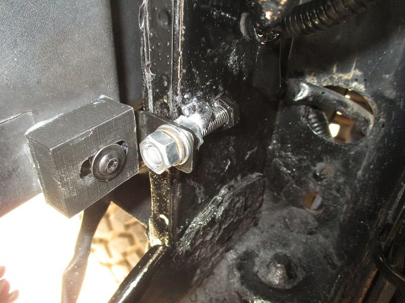

Installed my newer cleaner 04 headlights into the 01 body. You can still get the right angle brackets , mounting screws, and the plastic top adapters. I welded a bolt to the radiator support. Bolt head was flattened on one side so it sits flush against the frame. Now there is easy adjustment. You can see my 3D printed bracket. Using devcon plastic welder. great stuff. Did an oil change. Using 10w 40 high mileage Penzoil 'non' synthetic, and K+N oil filter. Went with K+N due to synthetic material filter, and allegedly having correct OEM bypass spring rate.

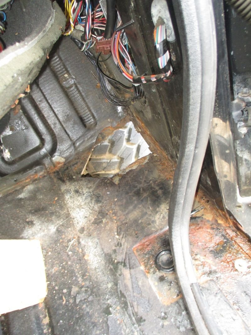

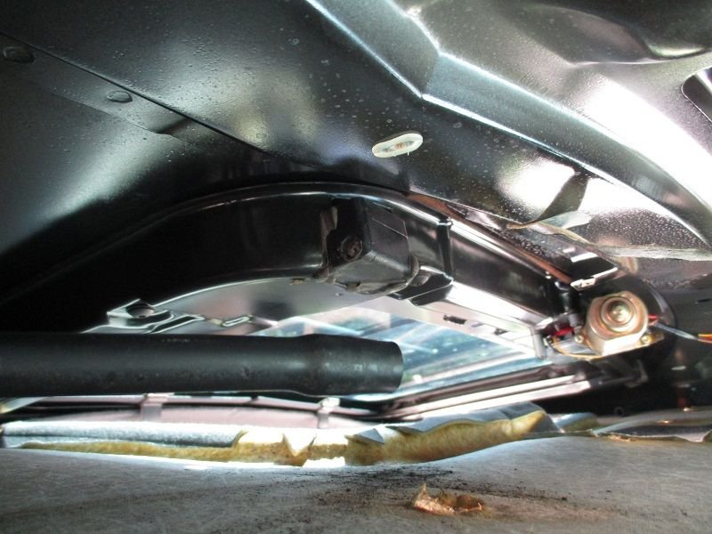

Started on the hole in the floor. Looks like the sunroof has been leaking for years. Did some rust repair along door sill with rust Mort (do not get it into cuts on your hand). Made a patch, not sure if going to weld in or use some self tapping stainless screws.
Also, I removed that black foam sponge crap surrounding the horns. Just soaking wet, and the passenger side front end body mount washer has completely disintegrated.....

both sunroof drain nipples broken off! Rubber drain tubes and sunroof gutters clean. Some thin wall brass tube (maybe 5/16?) cut about 2" long. 15 min epoxy, followed by extra silicone.
Pouring outside, so will see if it works.....
