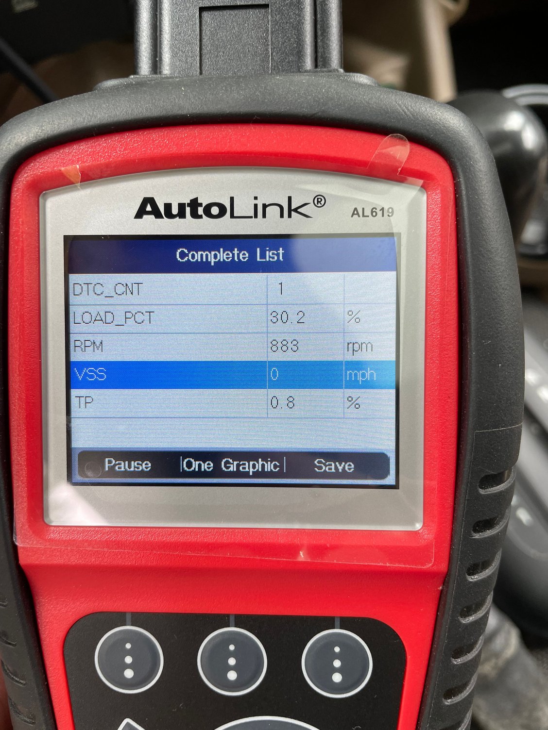

Could be, or could not be. Even with it running poorly that still will give you an indication. For example, you can expect O2 readings to be erratic, but O2 won't cause this because the ecu doesn't even listen to them when the truck first starts. On the other hand, erratic running won't throw off cam sensor readings or MAF readings that much, or at least you can expect how much it will throw them. You're looking for extreme outliers.

Bank 1 downstream showing 0v, FuelSYS1, FuelSYS2 fault.
