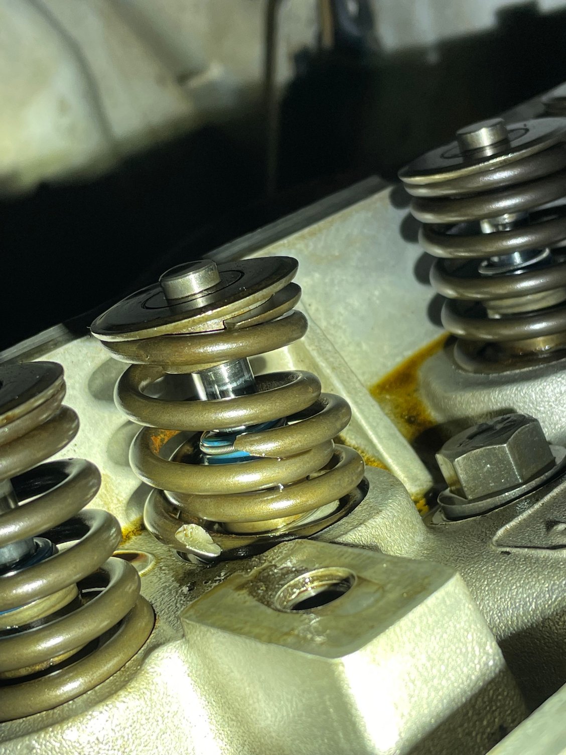

Didn’t find a solution but I found the problem.
ZERO compression on cylinder #4.

Found the problem

Yep! That'll do it! Thankfully shouldn't be too bad to repair long as the valve isn't damaged.

Damn. That's one clean looking head.
Going to attempt getting a new spring on with the head in place. Shouldn’t be too bad.
