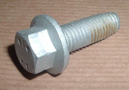

OE rear bolts (RYG101360 now / KYP500250) are M10 x 25mm. I don't remember the pitch, but I would guess 1.75 >
Get Grade 8 bolts. Good Luck!
