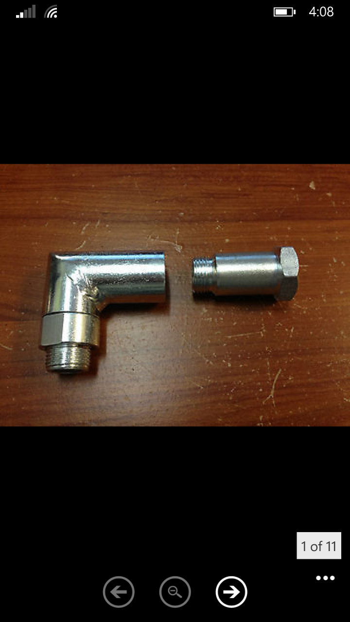

I'm surprised one that short worked for you. Your cat must still be semi-functional. I tried that length without cats and it threw a code. I went with this longer 90 degree type and no codes.
