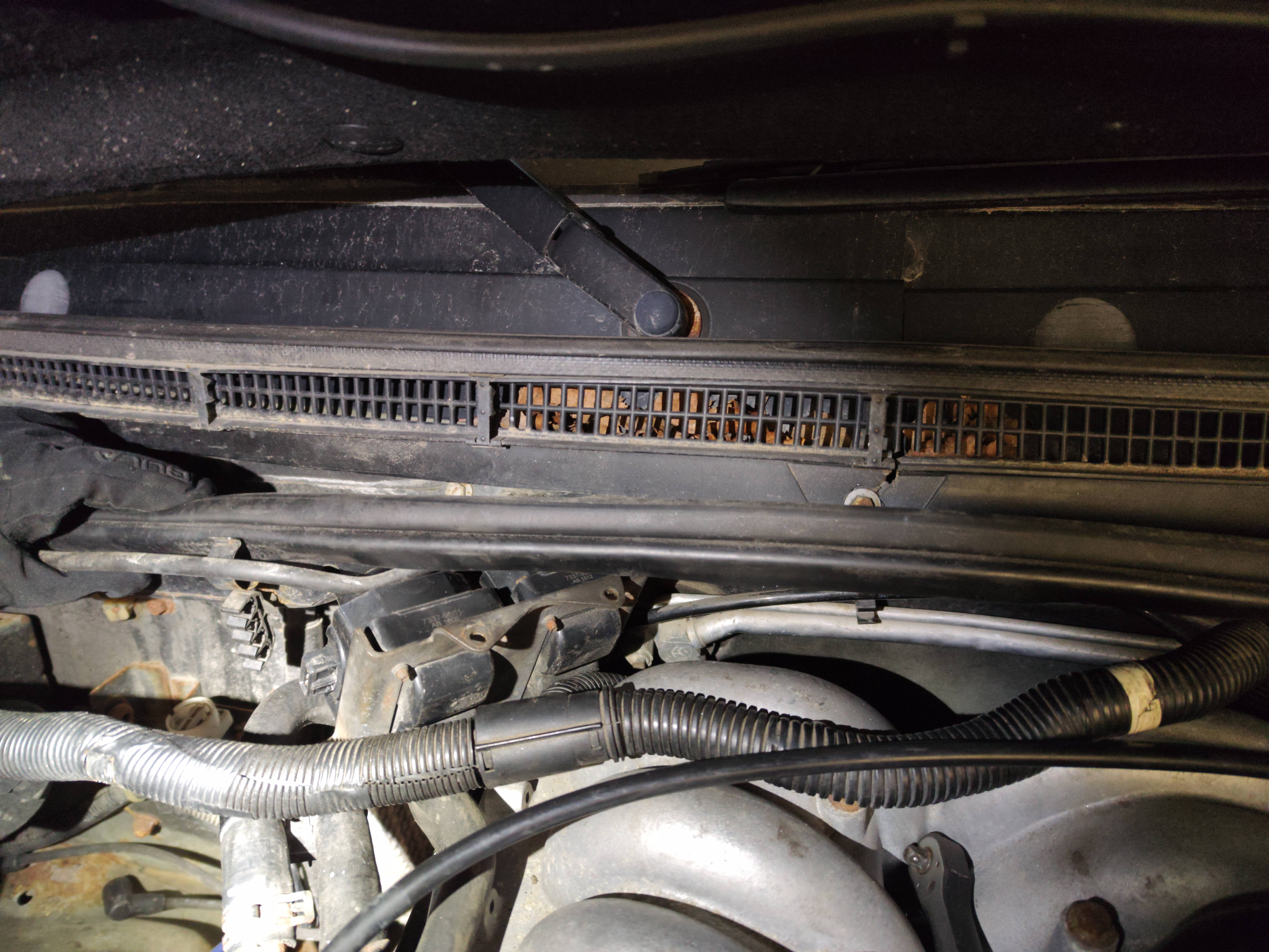

Do note that the coilpack and coils do fit to come out in one piece, no need to take the intake manifold off.
Just move the cables and pipes etc a bit around, nothing needs to be taken off.
It's a bit fiddly, but definately doable in a few minutes.

Originally Posted by redwhitekat
man those leafs man come on lol
HAH!
Haven't got around those yet. Had that truck for less than a month and there are a "few" more important things to handle to get it in driving condition and pass the MOT.
And the scuttle panel is in in many pieces....
