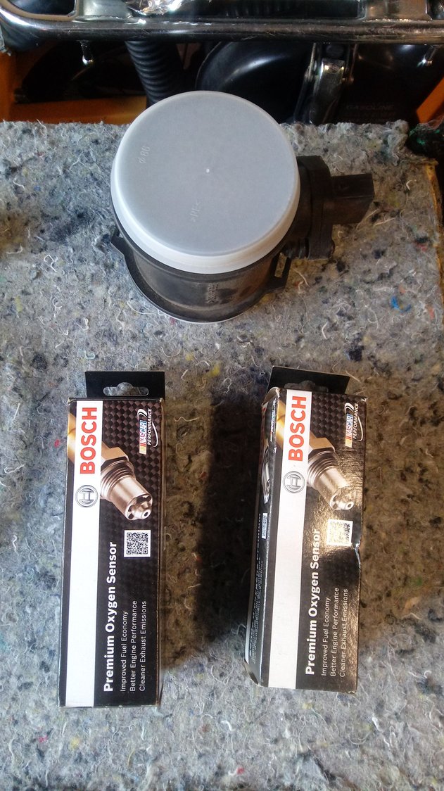

OK guys here comes my write up on the install.. I followed Gerry's directions to the letter and it worked flawlessly.. Thank You Gerry for the work and time you put into this project to help all those in the land rover community. This modification is going to help me tremendously as I drive across the country and live out of the Rogerrover. he only major thing I did differently is that I removed the coil pack from the rear of the engine completely. it wasn't easy. and I have big hands... I basically got the pipes to come out of the back. pulled them out the passenger side. then unplugged all wire from the coilpack. including the two coil pack harnesses. I then removed the coil pack screws from the base of each pack and pulled them out the passenger side separately until I had all three pieces out and a nice new large working area in the back of the engine bay.
after that I took my time and removed all plugs as well. I took engine cleaner on a rag and some hemostats and cleaned out each plug hole and the surrounding areas to remove any and all evidence of oils to be able to tell if a leak starts and I will know how to fix it in the future... I then did my old hot rod trick of drawing a vertical line on the plugs from tip to base telling me exactly where the spark is and when I insert the plugs I do my best to tighten them down enough to point the gap at TDC for maximum spark. which I believe was almost straight up. that was my guess. almost all plugs made it there a couple got to 11oclock as well.. then I ran the wires and carefully placed the ends in the coil packs first and set them to where i heard two distinct clicks telling me they were perfectly in each hole.. I put the numbered wire identifier clips Gerry recommended from eBay. On each wire then routed them back to each of their respective spark plugs in the order on the diagram.. then put everything back together. cleaning and cleaning and cleaning along the way and replacing any wire looms as needed also. and general cleanup under the engine hood. after that was done I replaced both o2 sensors up front. I had to fix bank2 on the passenger side the contacts were all corroded and wires funky. so I clipped em... cleaned em and soldered them and got em plugged back in. the car started right up... exhaust didn't smell like eggs anymore. and I ran it for about fifty miles and no more light... and no more codes.... I feel like a giddy school girl...
New coil pack, Plugs and anti seize
The Gerry Condez relocation kit with Magnecor wires, Wire loom holders and wire identifier clips
the Gerry Condez coil pack extension Harness looms
Air Flow sensor and o2 sensors
