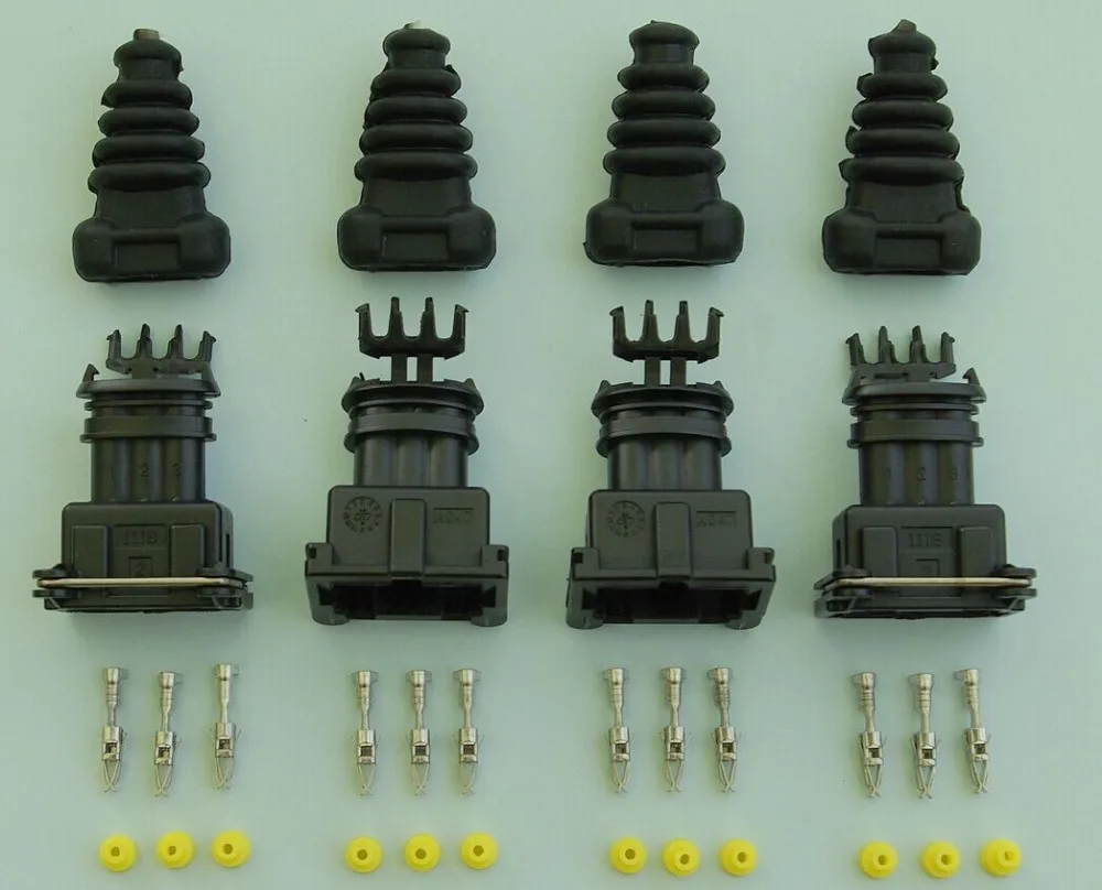

Those are just JPT connectors. Normally a boot and a sheath used to further seal them up.
http://www.mouser.com/TE-Connectivit...yzs6iiZ1yvsm2e

I understand that with even a little knowledge/skill everyone can do this task. But, I questioned myself during the entire process of building this until now, is it all worth it? Not even sure, there might be few working discos around to use it. Most, would like to keep the coils where they are. But, its me, I just have to finish what I started and its all worth it! But there are also things I thought that will make assembly easier for everybody because I am not familiar with the skill levels of individual owners.
My concern is TIME, waiting for individual parts, shipping, compatibility and at the end, it wont fit or match, TIME wasted. Some owners does not even have time to do all those and still would like to maintain their trucks. To complete a project like this is almost as long as this POST since it started. haha!
2nd, this is part of the ignition system and its extended. One small mistake, loose connection, weak solder and loose crimp will eventually lead to more problems especially with vibration. Please remember that the WIRE gauge they recommended is a gauge larger than the connector can use so some extra procedure made to fit them inside. Its professionally made.
3rd, the project should be able to handle daily driver and off road use so the wire maker told me that it should be water tight. This I had to consider as well because according to earlier posts, waterproofing was suggested.
4th, I'll just go nuts in shipping individual parts. LOL!
5th, All that had been made are for kits and I have no spare.
I am sure that this will meet its purpose with less aggravation to others during installation. If there are PROS and CONS about relocating the coils, just read the entire post again. I had mine installed since I got the HT wires and thats all.

Some Junior-PT connectors won't handle larger wires especially when extending them close to the front. If you remove those yellow seal, the wires will wobble inside and water can get in them. Securely fastening the wires require the plug. I got plenty, exact looking JPT samples but the clips and the rails are all different and some are too short to click (lock) to the other end. The nearest fit is this but the wires are soldered already (link below)
1999-2004 Land Rover Discovery Ignition Coil Connector Kit - Engine Electrical - Standard Motor Products 99-04 Discovery Ignition Coil Connector Kit - 278-05228209 - PartsGeek
Cheers!
I glanced at mouser and they have terminals down to 13 gauge and seals for up to 3mm diameter wire
http://www.mouser.com/ds/2/418/NG_CD...B16-647060.pdf

Cool, thats great. Just hope the outside rails, meaning the plastic housing can go all the way in and locks. I ended up getting a couple of different ones to match exactly the coil packs and the harness from behind the engine. I learned the hard way, they all look similar but variations wont fit well.
Upon learning that some china made connectors are slightly different because of some patent issues but im not sure if thats is true. All these connectors are way over the patent life. Cheers
