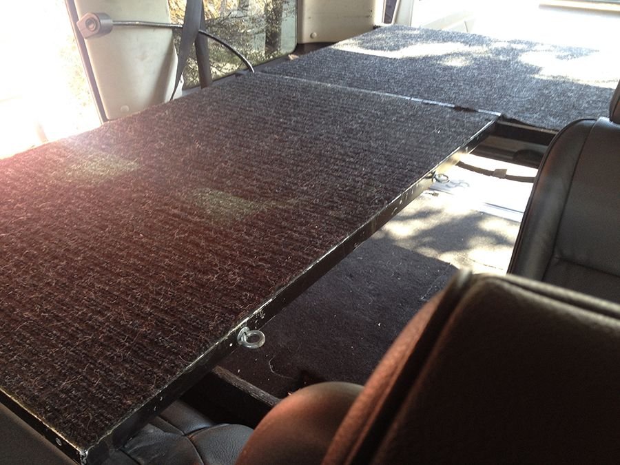

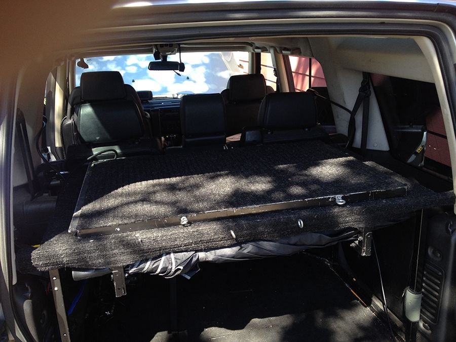

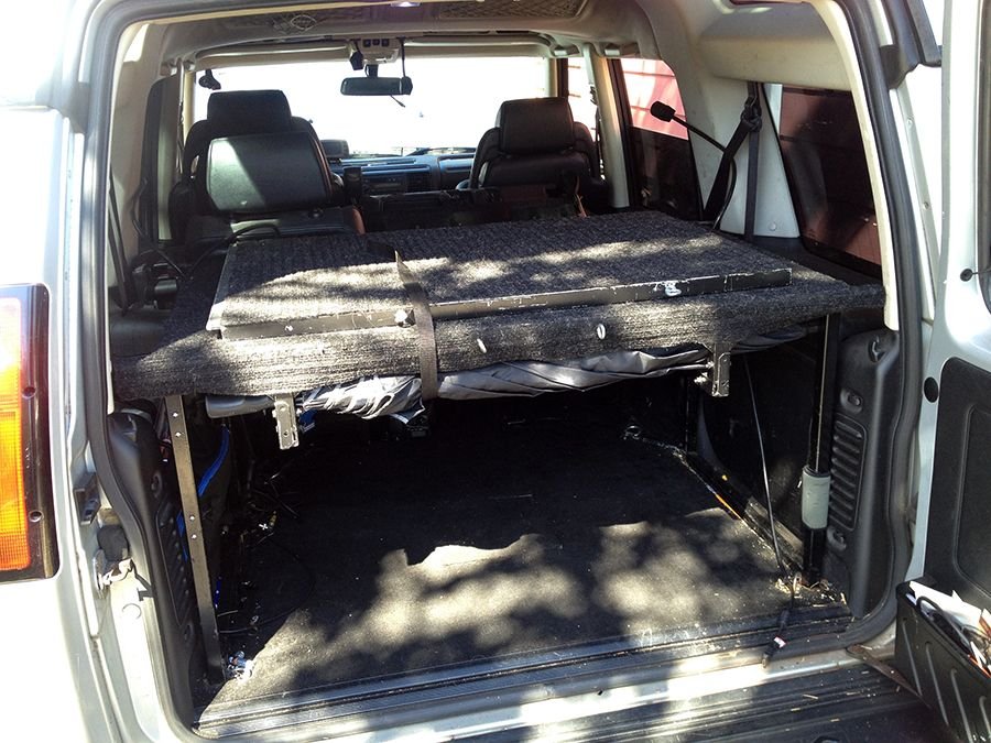

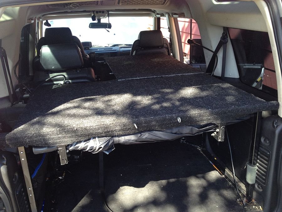

Here are some of the pictures of the folding bunk, Actually, I made this to carry more equipment. We travelled to Florida one time and my daughter slept on the deck the entire trip. I cut a rubber foam mat and a sleeping bag is the way to go. Also, Im only 5'7" I can fit under the deck while my son drives. We got all our stuff on the roof rack. Had this for years already and never been removed since.

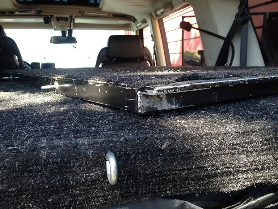

Image showing when the deck is folded. The entire unit is made of aluminum square tubing and welded.
3/16 aluminum angle to connect them together.
The deck connected to the rear cargo deck,

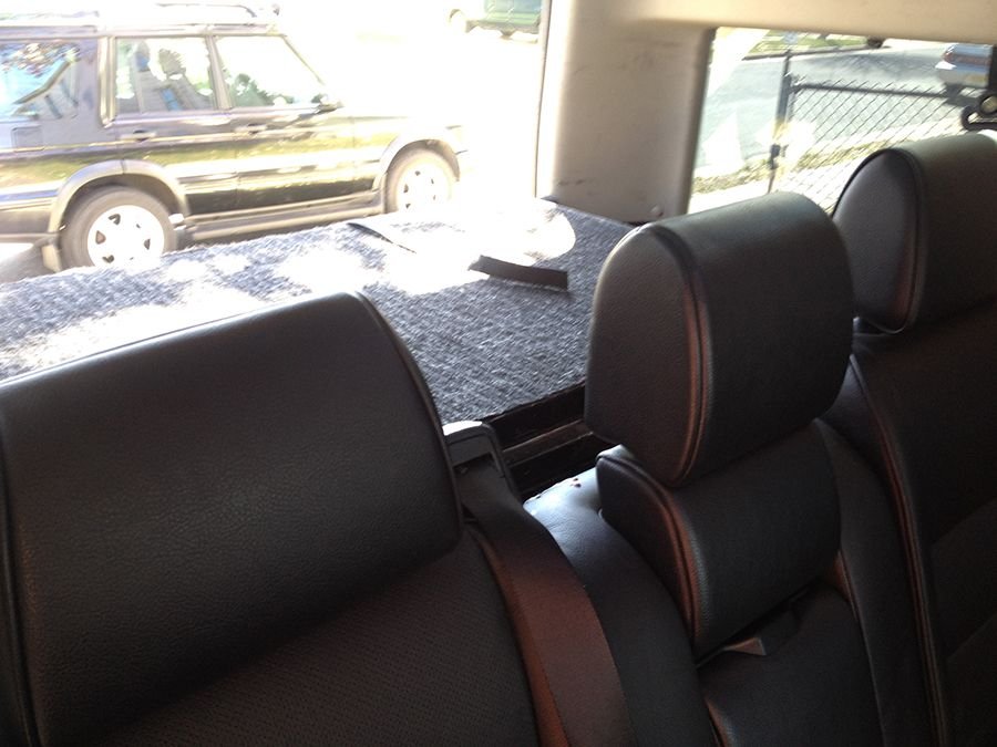

One of the rear seat can still be used. The deck is secured to the other end by the folded seat.
Plenty eye bolt all over to secure equipment when I work.

Nice setup LR03NJ... It looks almost like a sled with the rounded front on the frame... I assume it's bolted to the floor? Any side attachments? And it looks like you can still get into the side cubbies at the back, is that right? I was wondering about just taking those out with this kind of setup.

Robh, Its not bolted on the floor. I just used turnbuckles and cut one of the eye bolt as another hook and use the D-Rings on the floor. Even without them they are very secured. There are no space on the side. It fits exactly beside the plastic compartments. Yes, the side cubbies can be accessed. There is no problem taking it out, its fully assembled once I installed the deck behind.
Colorado David, The total deck long part is 5'4". That is from the front head rest all the way to the speaker board. You still probably have another 3 inches to the rear glass. You just have to move the seat 4 inches forward and use a big pillow so you can fit. LOL! barely. I guess it will work with your height.
Alex_M, If not too busy next week I'll measure dimensions in case you decide to add a deck. Actually, It can store more stuff in the back for easy access to luggage underneath.
