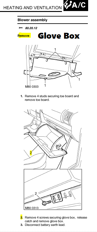

FIRST you need to remove the Glove Box (very simple) and inspect the Heater Pipes/Core(#16) especially at the O ring locations(#15). If the coolant is leaking with the Glove Box removed you will see it.

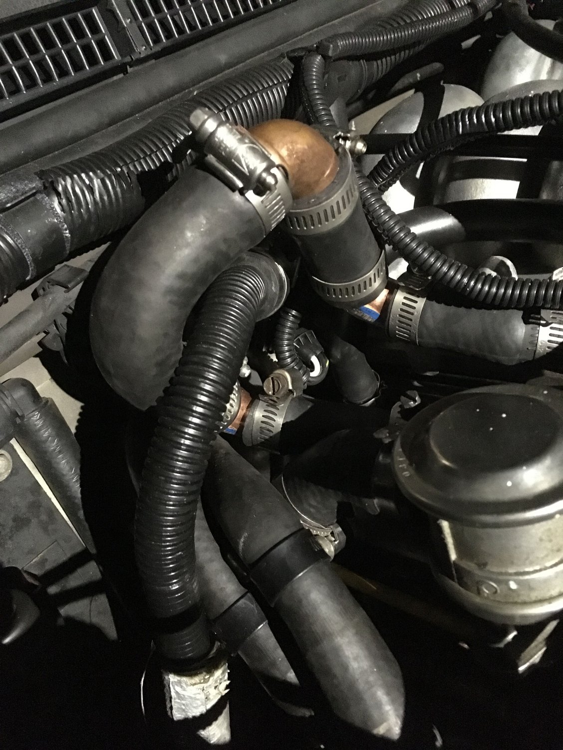

just a side note, you can bypass the heater matrix if needed till you get it fixed, this is how I did it for about $10 from local auto part store
Same here. Lol

To be clear, I anticipated needing to clamp the hoses when I replaced my heater matrix to reduce the amount of coolant dumping on the floor. That is why I have so much hose and the bit in the middle.

Thanks guys . This is great info . Especially with the picture . I just didn’t want to tear into anything without the homework. It has to be the heater lines. I will provide an update once complete.

You'll get it sorted real quick once the glove box is removed. It's simple, and this is all it takes to get it out.
