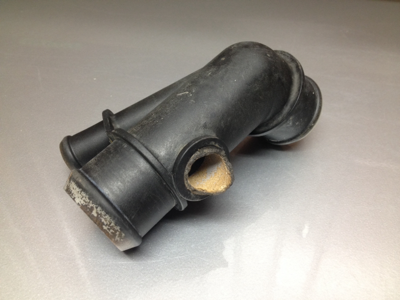

Here's what we found when we replaced the plastic union in my friend's '04 Sunday afternoon.

^that's what mine looked like 3 weeks ago. Cracked while I was replacing the waterpump in the parking lot at -8 degrees.

My upper t busted a couple of years ago. Replaced a radiator before I found the problem.
No more plastic for me.
