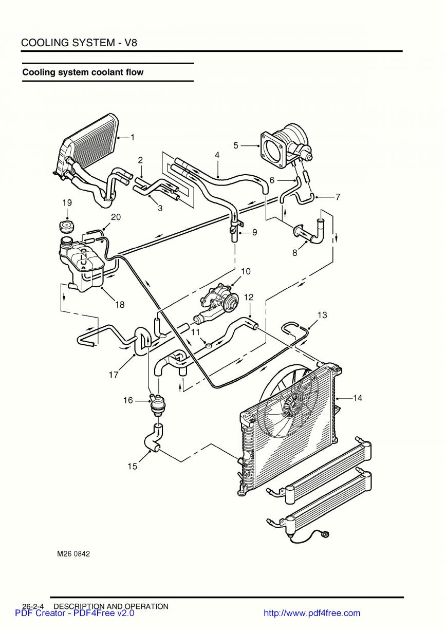

1. It has been overheating for a while possibly. The heat gauge is programmed digitally to show 50% from 130 - 240F. Only a scanner or Ultra Gauge can show you real temps. Which should be 180-200. At 212 the electric cooling fan should come on.
2. There is a throttle body heater that can be byassed in warm weather while you wait on the $25 repair parts. Number 5 on drawing. It keeps throttle from icing up in open position, which is no fun down hill from the mountain top.
3. That lovely orange color looks like Dexcool, it should be flushed out and replaced with green 50/50 premix. Dexcool becomes contaminated, and forms sludge, etc. You can test radiator for sludge by using an IR thermometer, measure temp on the fins top to bottom, in vertical line, after warmed up, engine off. If more than 10F spread, lower rows could be clogged.

Ok, I looked at the gasket and seems to be fine. The edges of the throttle body heater are clean. I think it's coming from one of the hoses going into the heater. I'm assuming its just clogged since Dexcool gums up everything. I'm gonna try and clear it out tomorrow.
