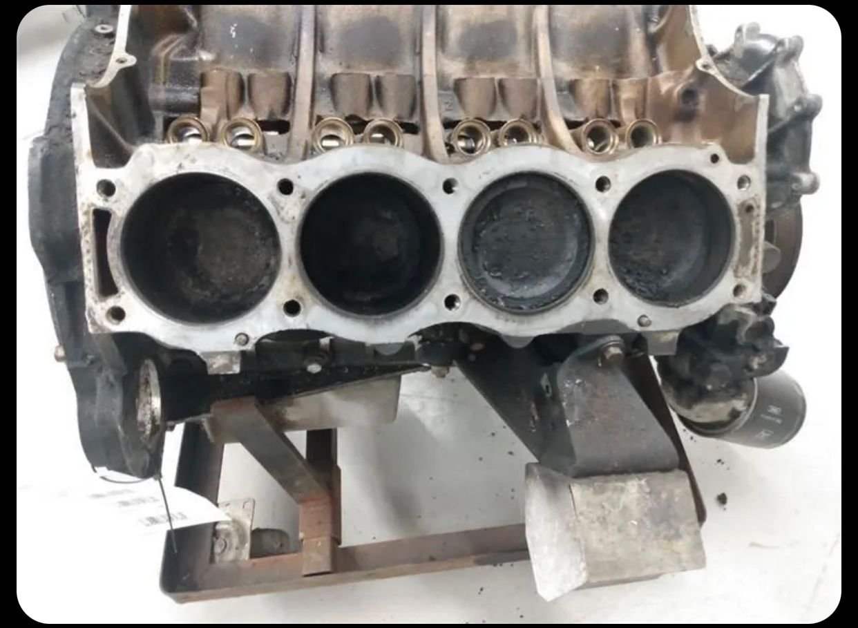

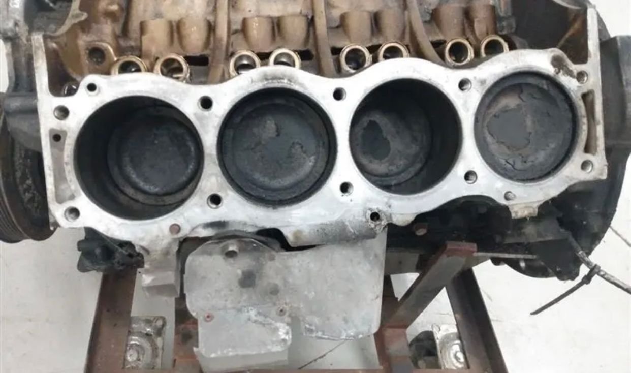

As well, to plan for the worst there is a short block available photo’d below and I contacted them asking if a pressure test had been done on the block and they indicated it had not been performed. Currently, it is listed for $1,300, however, without knowing if is another slipped sleeve or cracked block I think that is a steep price. The cylinders look sooty and not steem cleaned however, the second photo above cylinder 3 appears to have some interesting residue. I know these blocks cant be visually inspected for leaks but if I can get it for the right price maybe this would be a suitable option if I do indeed have a slipped liner or cracked block on top of my hg external leak?

If you want to do Leakdown and compression test then of course before disassembly is best. Sounds like you just have standard old age blown hg problem, nothing more serious so I would not assume it needs anything more than HG replacement. My lead the fleet vehicle currently has 260k on it running strong. If you do decide to replace engine completely I would look to source a good 4.0 block from as early a year as possible. I would contact Will Tillerey or Doc Heydary on facebook to get one, should be able to get a shortblock for less than a grand although maybe the market has increased recently. I know AB was buying every available 4.6 from breakers at premium prices. The option would be to source one from a wrecking yard, my normal advince is to look for one with significant body damage as that indicates it was likely running and driving decently at the time of collision - no guarantee but blown engines are not usually involved in accidents.

As it turns out, I just found out about AB buying short blocks at a premium just now. I called the place where the photo’d short block was located and it turns out that depending on the condition AB is buying short blocks for $800-1200 from wreckers.
