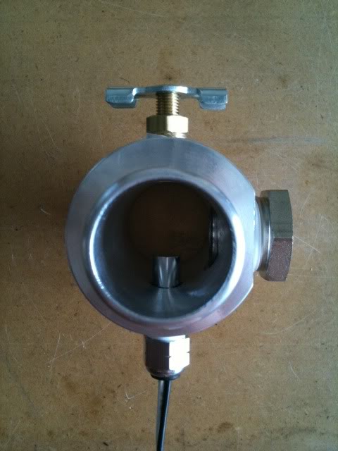

I got the bleeder valve with the site glass and the extra port for my temperature sending unit today... It's an impressive piece of hardware!
As you can see in these pics, I've already installed the temp gauge sending unit.
