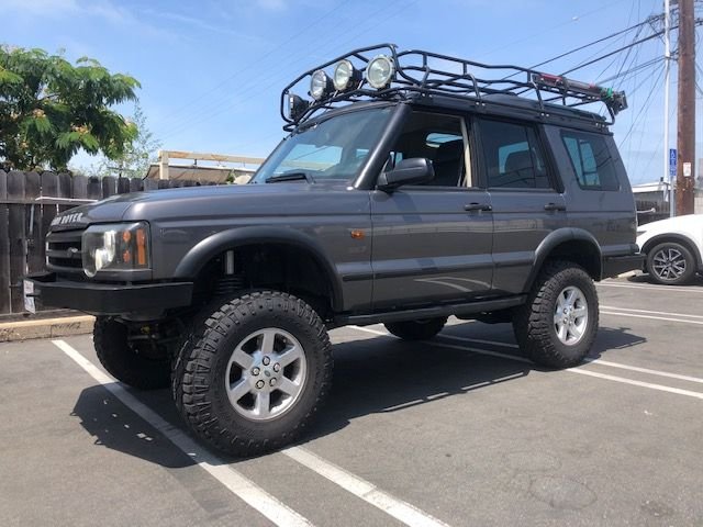

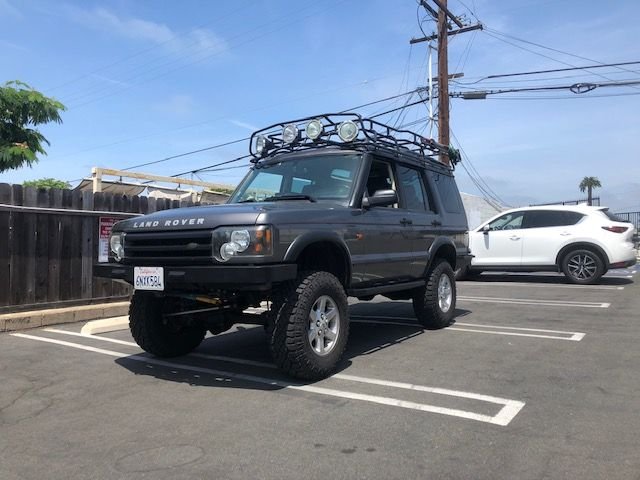

I bought a 4.5 lift kit from Simon last summer. Im happy with the kit. It came with front & rear , plus the modified Watts Linkage. So far its been good. Pricey but good quality.

Have any pics of your lifted D2?

Looks really good! Do you have a jack mount key lock?

Yes, I got a key lock from 4Wheel Parts.The Hi-Lift jack is locked on the roof rack.
