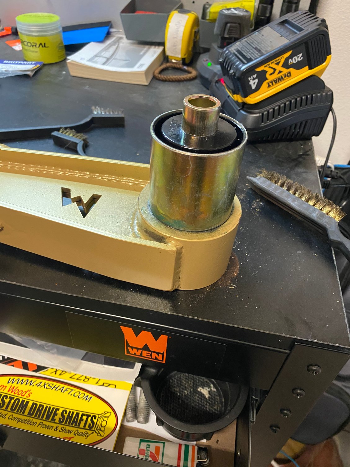

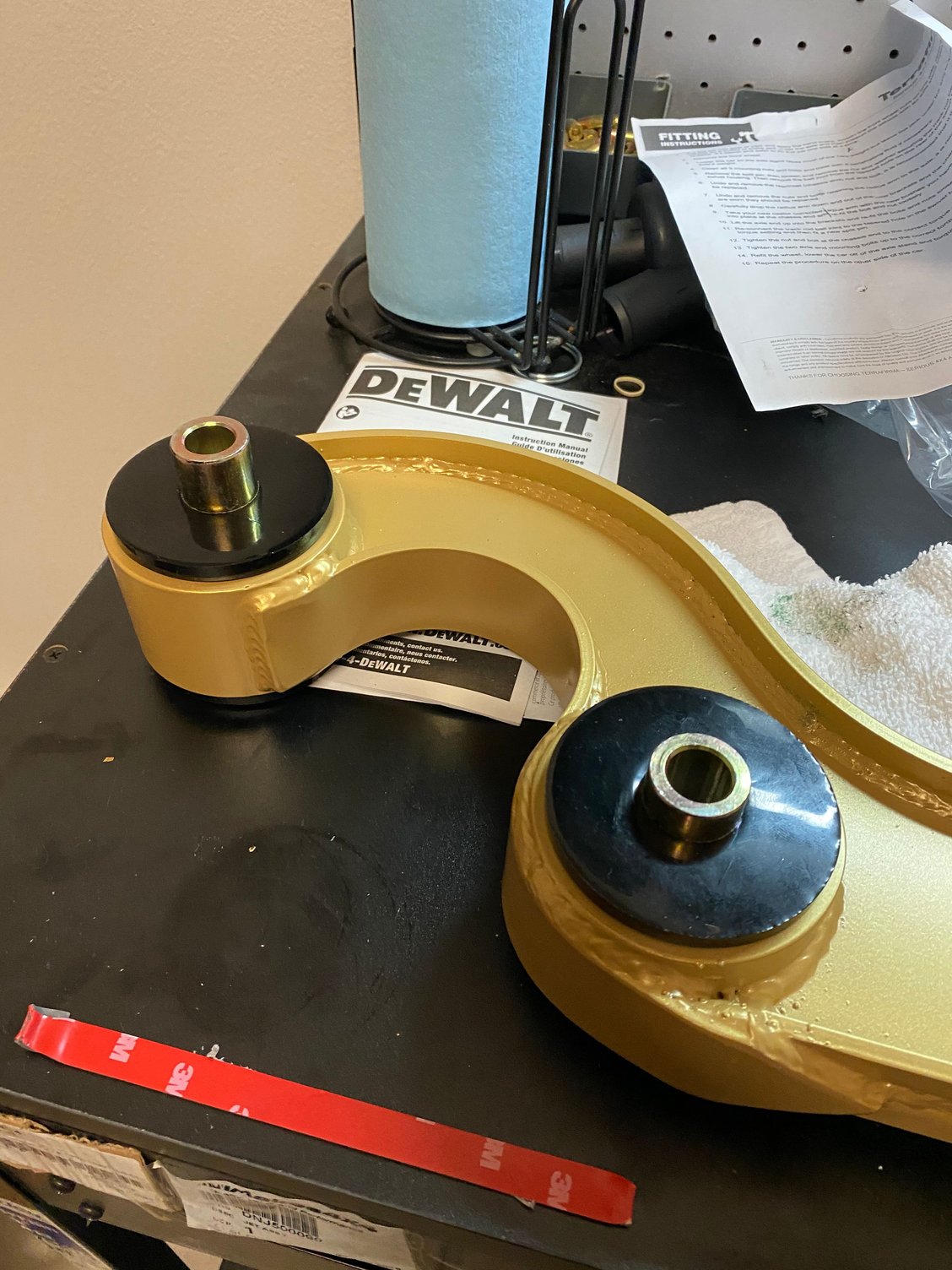

Just received my corrected radius arms from lucky 8, but I’ve run into an issue. Looks like the castor bushings provided for the chassis are slightly to large. I’ve tried cleaning out the radius arm hole and applied a small amount of grease with no luck. Lucky 8 is closed till Monday and wanted to get the project done this weekend. Any ideas?

I had exactly the same issue with these. Front aftermarket poly's were a bit loose and the rear bushings were way too tight. I ended up going with a set from adrenaline 4x4
https://www.ebay.com/itm/Land-Rover-...-/182197996232
because the terrafirmas rubbed badly with my slightly oversized tires and I needed 6 degrees. took a big press to get those bushings in. I still have the Tfirma set with rear bushings in the garage.....

I’ve put everything on old till I talk to lucky 8 tomorrow... they mentioned everything to should be able to be installed with out a press so I’m assuming they sent me the wrong chassis bushings.
as far a the radius arms go they look and feel very beefy.... I wouldn’t assume they would fail on me just by looking and holding them.

Anything with a metal sleeve like that needs to be installed with a press. The polys that dont have a sleeve can be installed without a press
yeah I realize that now, apparently the by hand pressed bushings are out of stock.... I’ve never had to press anything and considering buying a press 🤷🏻‍♂️
how many tons do you all think it’ll take to get that bushing in?
I’m open to other suggestions if y’all have any.

I have used threaded rods sockets nuts washers etc in the past. It works but it's a pain.
Harbor Freight has a couple nice press choices for $100 ish or less range.
think 6 ton would do it??
Yep, that's more than enough
