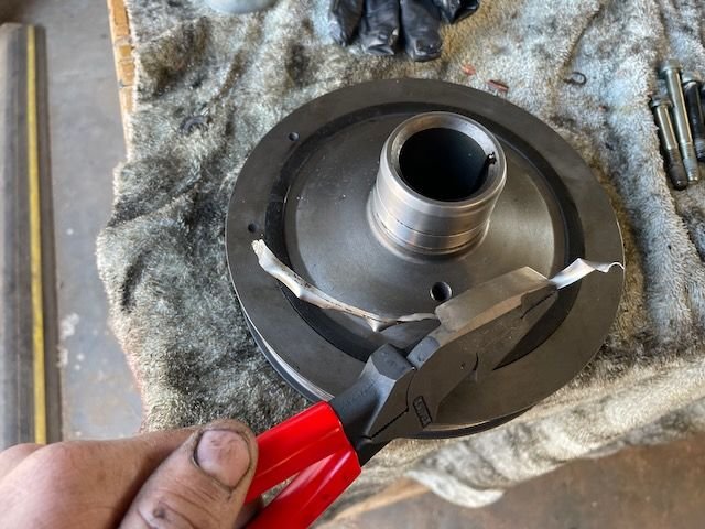

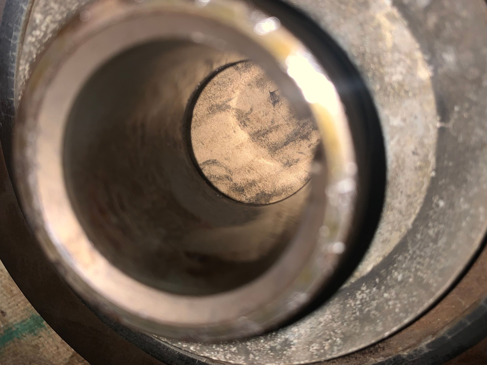

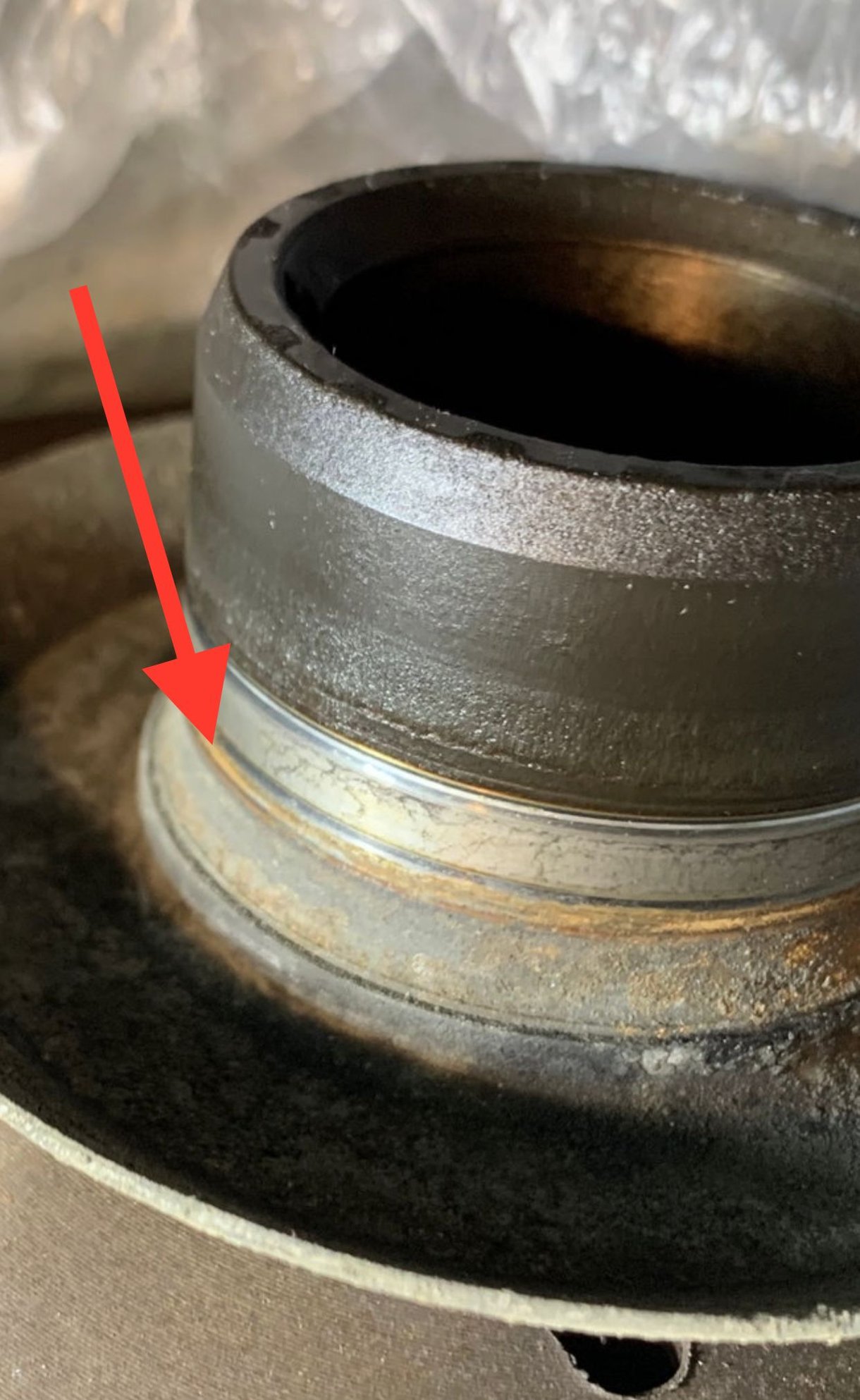

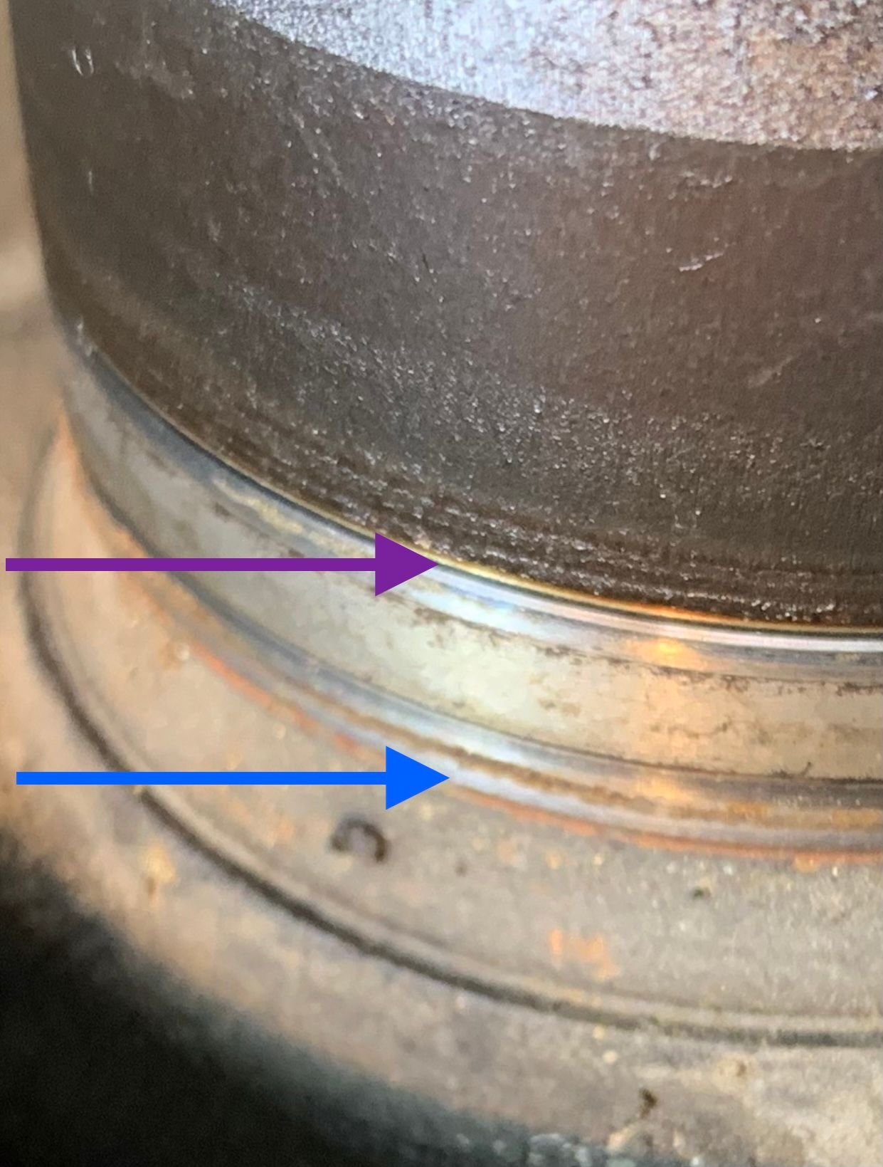

Please see the images I’ve taken from views all around. I was told that I might need to install a sleeve and that this view would help determine if that’s necessary. I have the sleeve already in case I need to do this. Can anyone tell me if it looks necessary? The front cover is being replaced and I put a new Corteco seal in it. I think the old one might’ve leaked some oil out of that seal. I’ve also done the PCV mod in this engine.
If I need to install the sleeve, would you use black high oil resistance silicone or blue loctite?
Thank you

There is a pretty significant groove in that one, if you have the speedy sleeve I would use it. Clean the oil residue off of your existing one. Put the balancer in the freezer and the sleeve in the oven, should drop right on. Speedi sleeve is designed to cut the flange off, but I put the flange to the balance side and don't bother with cutting it off. You want the sleeve centered on the existing groove.

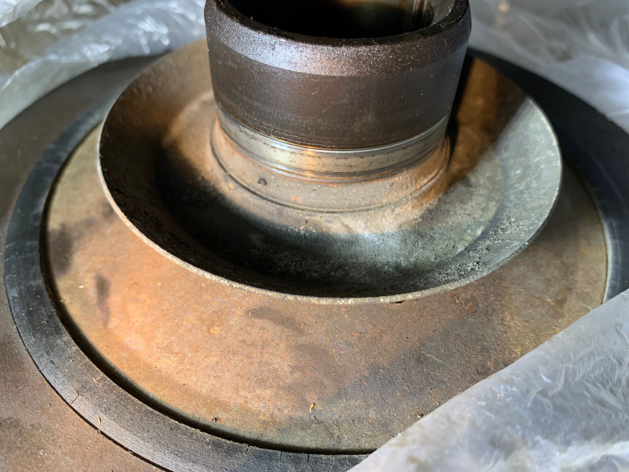

Thanks, so I want the flange to get to this point on the harmonic damper shaft? You don’t use any loctite or silicone here? About how long and hot should I cook the sleeve? Is it bad to just use the tool and hammer it on cold if it cools down and the damper warms up by the time I get the parts together? Also, can the spacer that’s on the damper between the bolt be put on either way or is the direction specific? It fell off while pulling the damper off and I’m not sure exactly which way it was on although it has a shiny mark around the hole through it on one side - I'm guessing that side faces the crank.

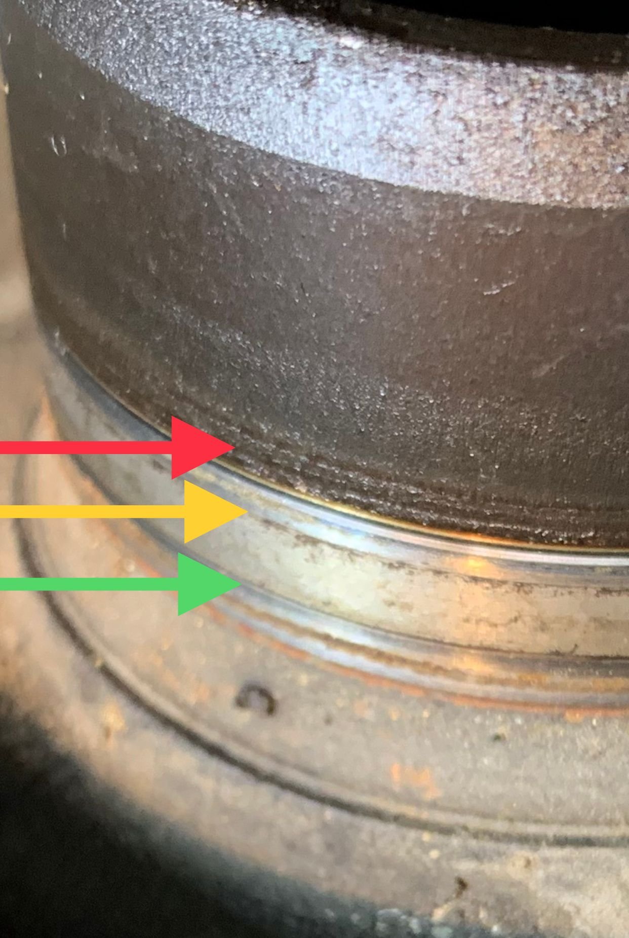

Maybe this image is better. Can anyone tell me about how far down the flange on the sleeve should go using these arrows? Just so I have some idea… I figure it’ll push itself down further as the crank bolt is tightened, but only if I don’t use loctite or silicone on the groove where the sleeve will go, so I’m guessing I don’t want to put sealant on there.

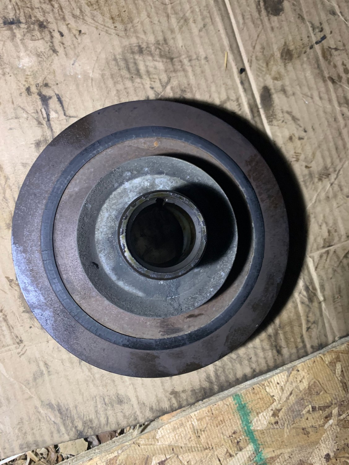

Maybe this image is better. Is it more important to cover the shiny area closest to the pulley or the area closest to the crankshaft bolt? I’m not sure how much area the sleeve will cover, but I’ll try to take a look and estimate what can be done, hoping it’ll cover all of the wear marks. I’m afraid to push the sleeve on too far if the worn area closest to the bolt is the most critical.

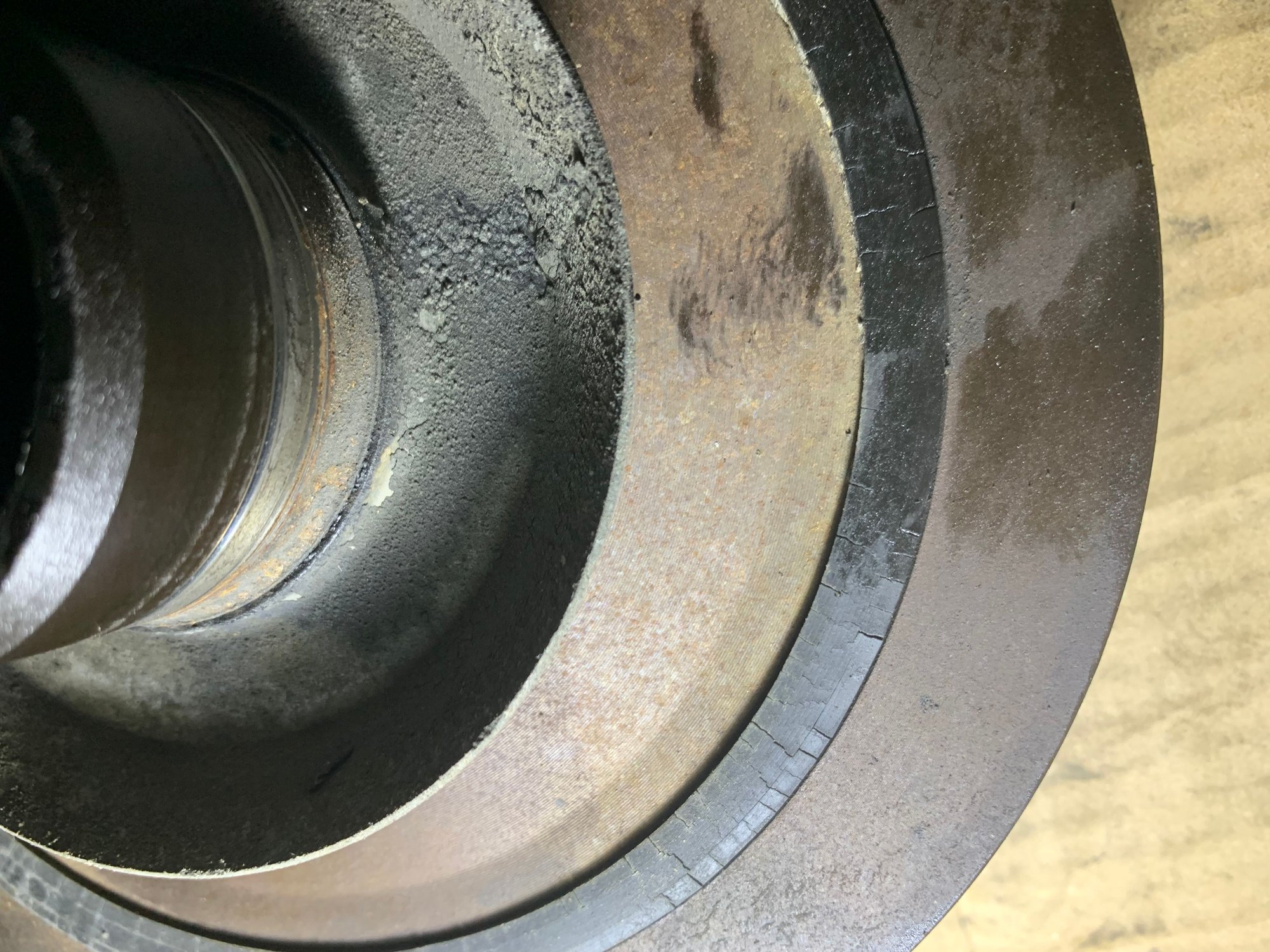

Was the rubber on your pulley cracking? Mine is…

I took a good look at the harmonic damper today and I’m wondering how to get that dust shield off without bending or breaking it. I have simple green, but I’m not sure if that’ll do it or if I need to spray it with penetrating spray. The build-up seems to be holding it on pretty well. I could put it in a bag and soak it in SG for a bit, but hope the rubber won’t get trashed as it’s already cracking.
The grooves on mine are definitely there, but not sure if I want to mess with epoxy. I think I might use a thin smear of black silicone to try to seal anywhere the seal could have a gap in it, then tap the sleeve onto it. I’ll try removing the flange as well so I can be sure the sleeve is covering both shiny grooves (the one closer to the pulley and the one furthest from it). It looks like the sleeve is exactly the depth of the seal, so I’ll really have to get it right. I’m not sure if one side of the worn areas are more important to cover, but I’m guessing it’s the part further from the pulley to block oil from coming out there. Hopefully the seal I installed on the new front cover meets up with the sleeve alright… Lots to worry about here.
