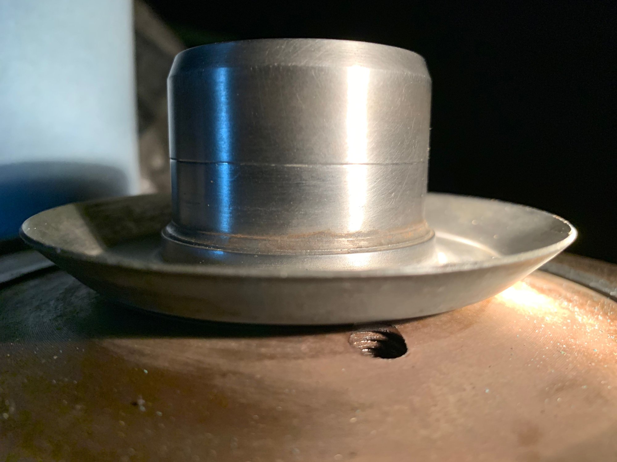

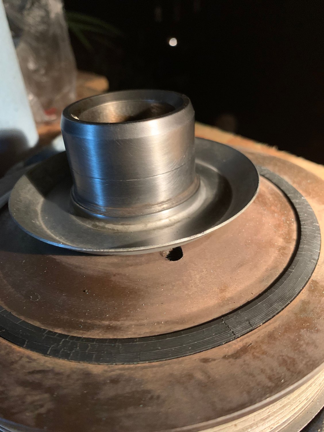

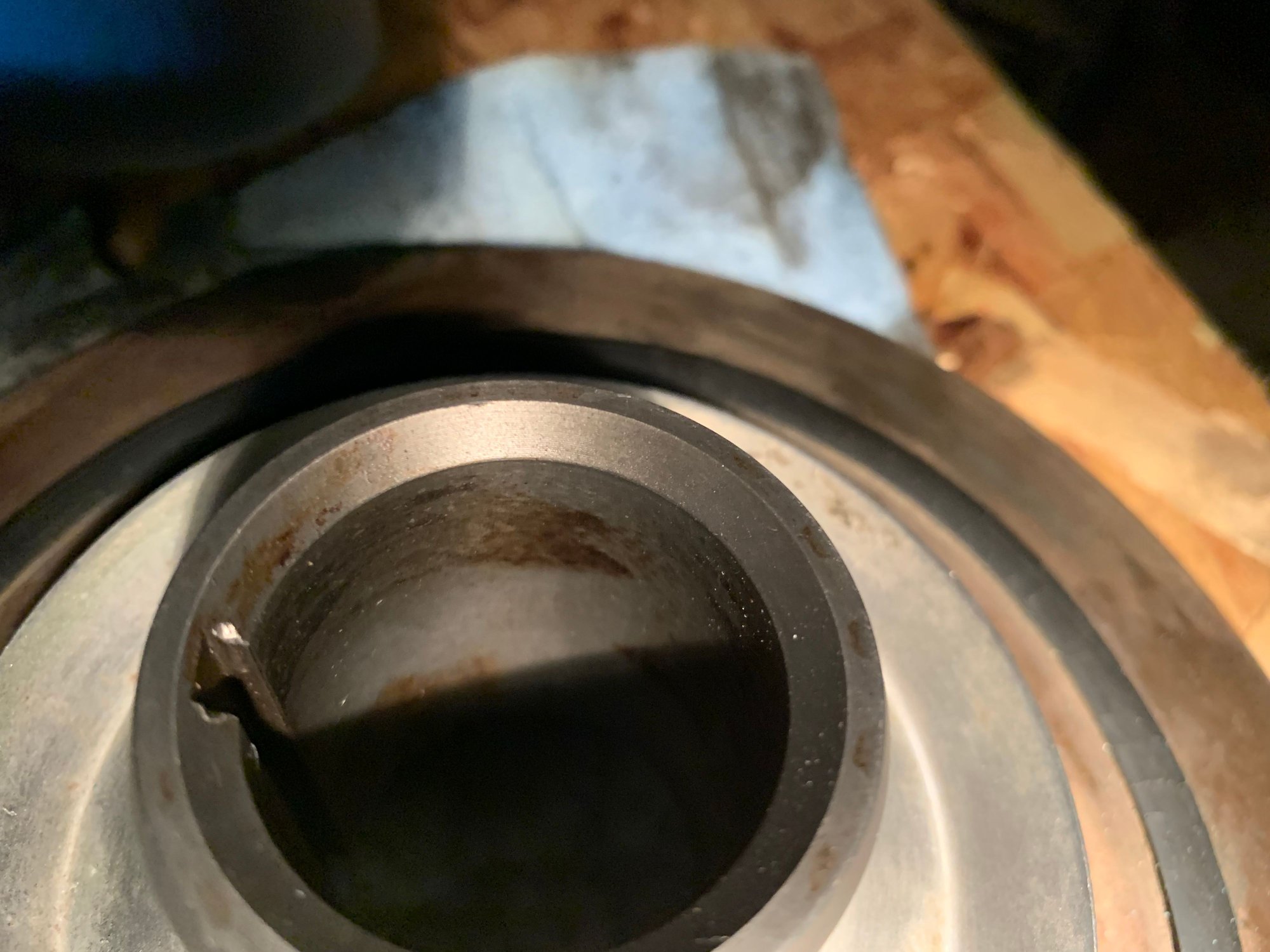

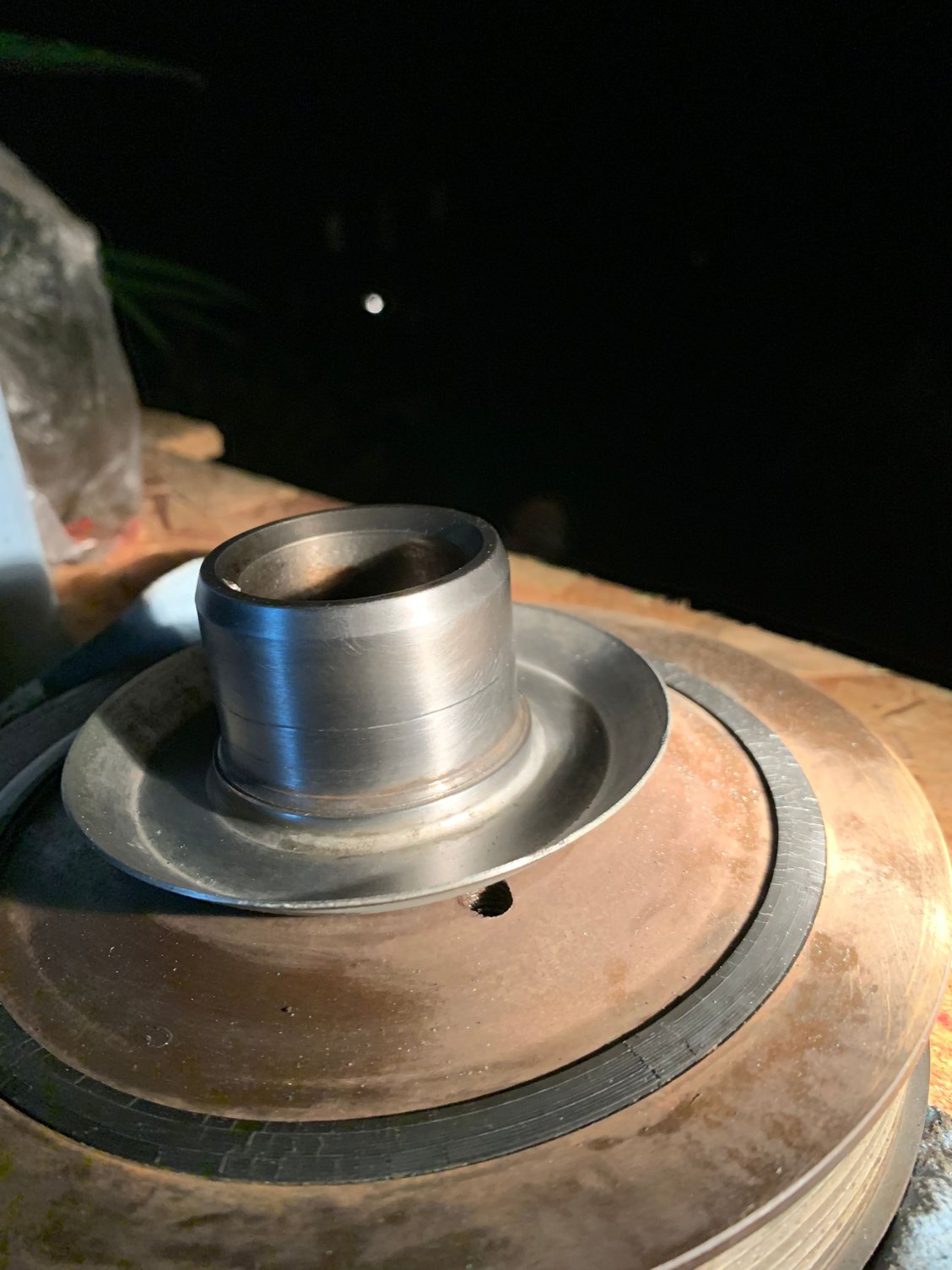

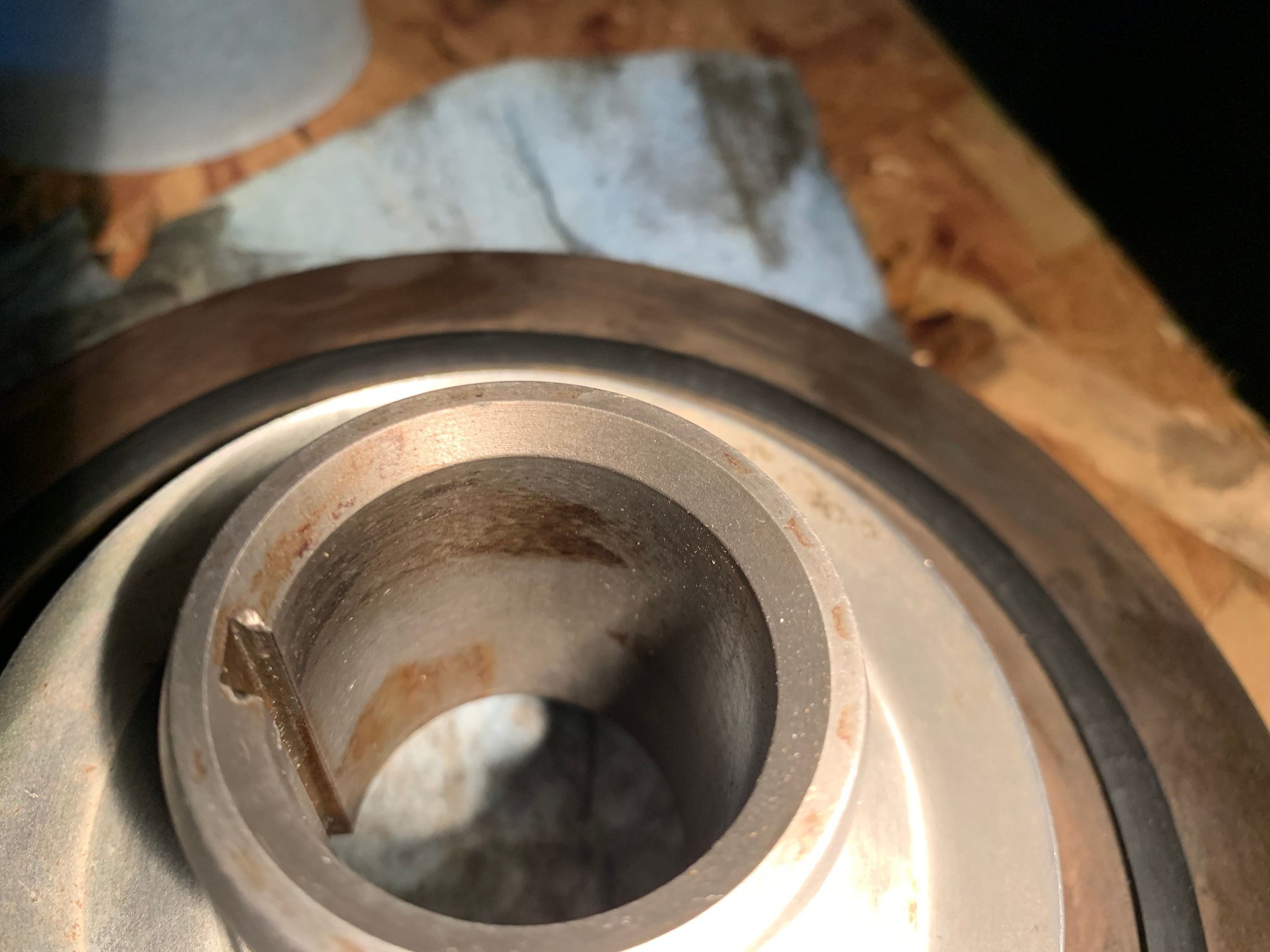

Sorry I didn’t get these images sooner - here’s the harmonic damper after cleaning. It’s not that clean… I just used simple clean and scotch brite - a bit of tooth brush, brass brush and blue shop towel too. It’s hard for me to tell exactly where the sleeve should go now and once everything is out together again, it’s going to be really hard for me to try to adjust anything. I don’t have a seal puller and really want to get this right the first time. Since I have a new front cover with a new seal I installed, which I just tapped in all the way, I’m hoping I did that right and hoping it’ll sit where the sleeve will be. I know it’s supposed to be simple, but I’m very concerned about accuracy since it really seems like there is hardly room for error here.
Is this clean enough? Should I spray the rubber with silicone spray to condition it? I’m hoping to prevent it from cracking. Should I shine up the pulley? What about the residue or whatever it is inside of the shaft? I have brake cleaner, carb cleaner, mineral spirits, simple green, brass brush, scotch brite, toothbrush - I’m not sure how to clean these parts.

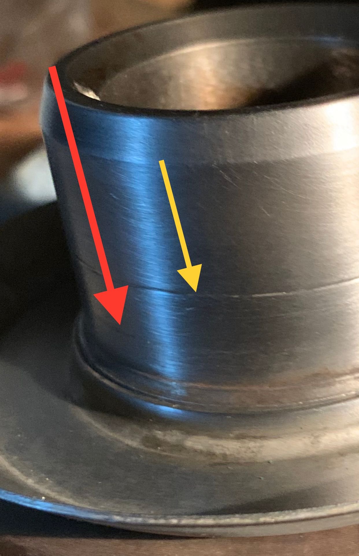

Thank you, is this (red arrow) the groove I’m trying to cover with the far end of the sleeve? I’m just confused about exactly where to get the seal now that the grime is gone, even trying to compare it to the old pictures. There’s a big line above it (yellow arrow), but I’m not sure what that is - yours doesn’t seem to have it, but I can’t tell for sure. I don’t want to tap it down all the way to the dust shield and miss the part that needs to be covered, unless that’s what’s needed - or getting it about 2mm away from the shield? Please help me get this in the right place.
