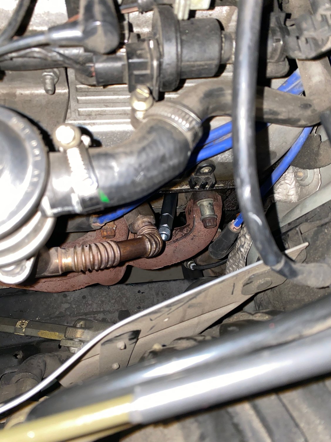

I’m at a loss been at it for about 4 hours
can I remove my secondary air?

Step away. Start again tomorrow. Yes you can disconnect the SAI but make sure you have a properly sized crows foot and don’t overbend the tubing.
if this is not a daily driver, take your time.

will that tubing bend... it feels solid.
i was thinking of disconnecting it from right at the spark plug well and slighting hammering it out of the way.

Quick update: removed the secondary air tubbing, aligned the back tap (slowly carved the new threads), and Inserted the plug.
now seeing that there’s hope, I pulled the plug back out and started the engine for about 5 seconds to alow the cylinder to push out any debris.
reinserted the plug by hand and tightened it up with a ratchets. The plug took a few mins to align but it’s in...

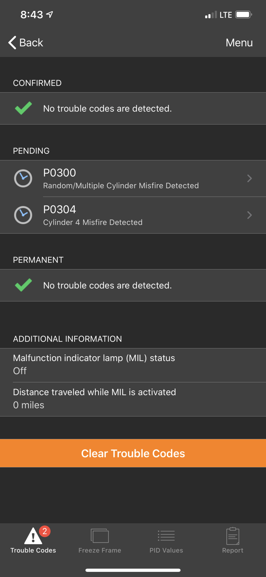

finally got a code.... misfire cylinder 4 the same cylinder misfiring in the first place.
its such a small misfire that the check engine light won’t come on. I decided to hook up my reader anyway and read two pending codes. (I didn’t even know that was a thing)
could it be the coil considering I placed a new plug in? It’s such a light misfire that I’m stumped.

I would suspect a plug wire before the coil(assuming the plug is good). What does the plug look like? Oily, black, light brown? Is the gap correct(It would need to be way off to misfire).
And it would be unlikely(but not impossible) for a 4 coil to fail on only one.
Have you checked the compression in that cylinder?
