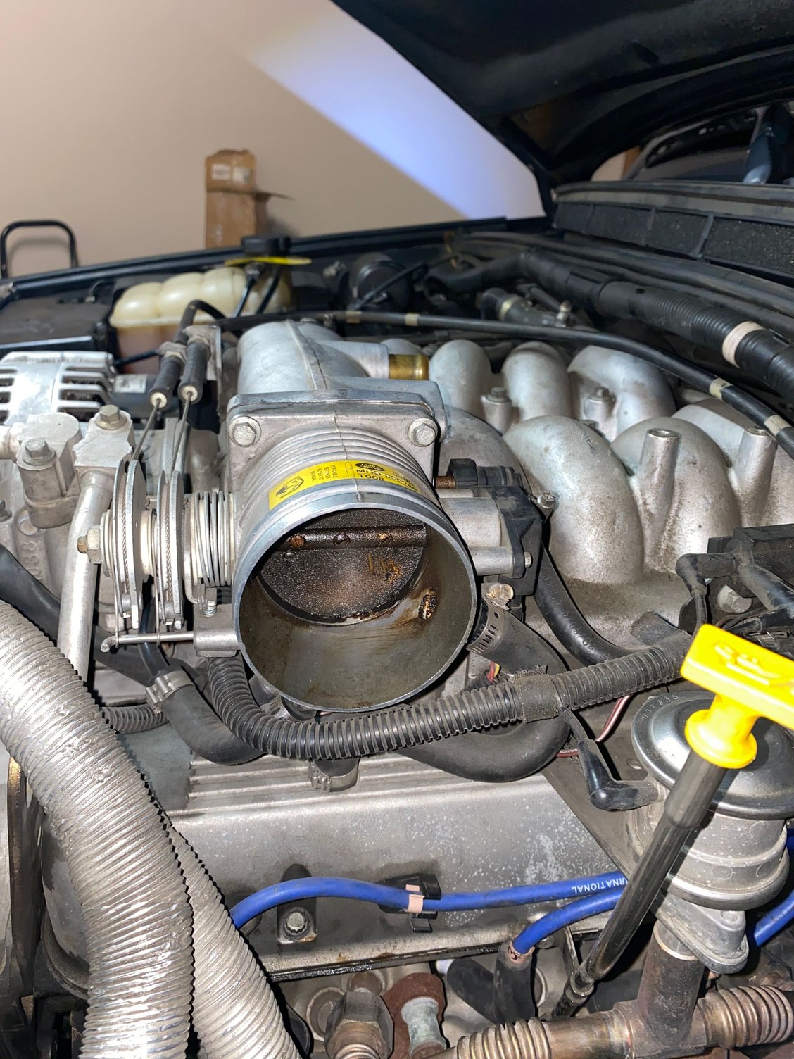

From: Dallas Texas
Thoughts.... could this be the culprit?

From: NYC
That hose from driver's valve cover to air intake looks terrible. The fitting on the valve cover as well.

From: Dallas Texas
it’s been cleaned
