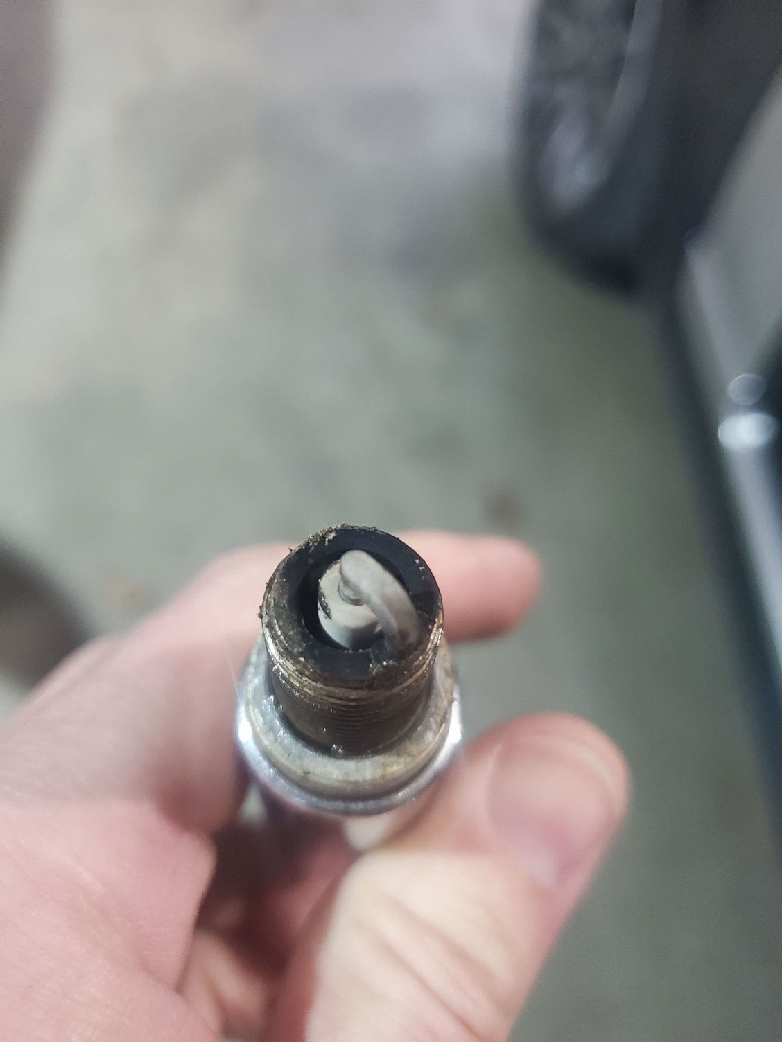

I am getting a P0305, cylinder 5 misfire. The engine does stumble occasionally, and there is an exhaust smell that smell like power steering fluid.
The plug looks fine, they were replaced about 10k miles ago, 18 months ago. Unless someone else can read it differently.
I pulled # to swap the plugs, see if that changed it, put I disconnected the electrode, I jammed it back on and that seems to work for now. Is the #3 wire one of the tougher ones buried under the coil pack? I think I have a new wire in my future. They were pretty new. So I dont think I need to get them all.
Any other places I should look besides the plug and wire? What would cause an occasional burning smell?
I should add I do get the occasional P1412 for bank 1 vacuum leak, a smoke test does not seem to show anything. I wonder if it makes sense to pull the intake and the replace the gasket while I am in there.

Plug looks fine, my guess is the wire was your issue. I generally recommend swapping the plugs first (#5 with a different one), then the plug wires, then the coils left to right, then the injectors). (99% of the time it is one of those first three.

I’d say the plug on its own looks fine, but I would generally compare it to the other ones to get a better idea.

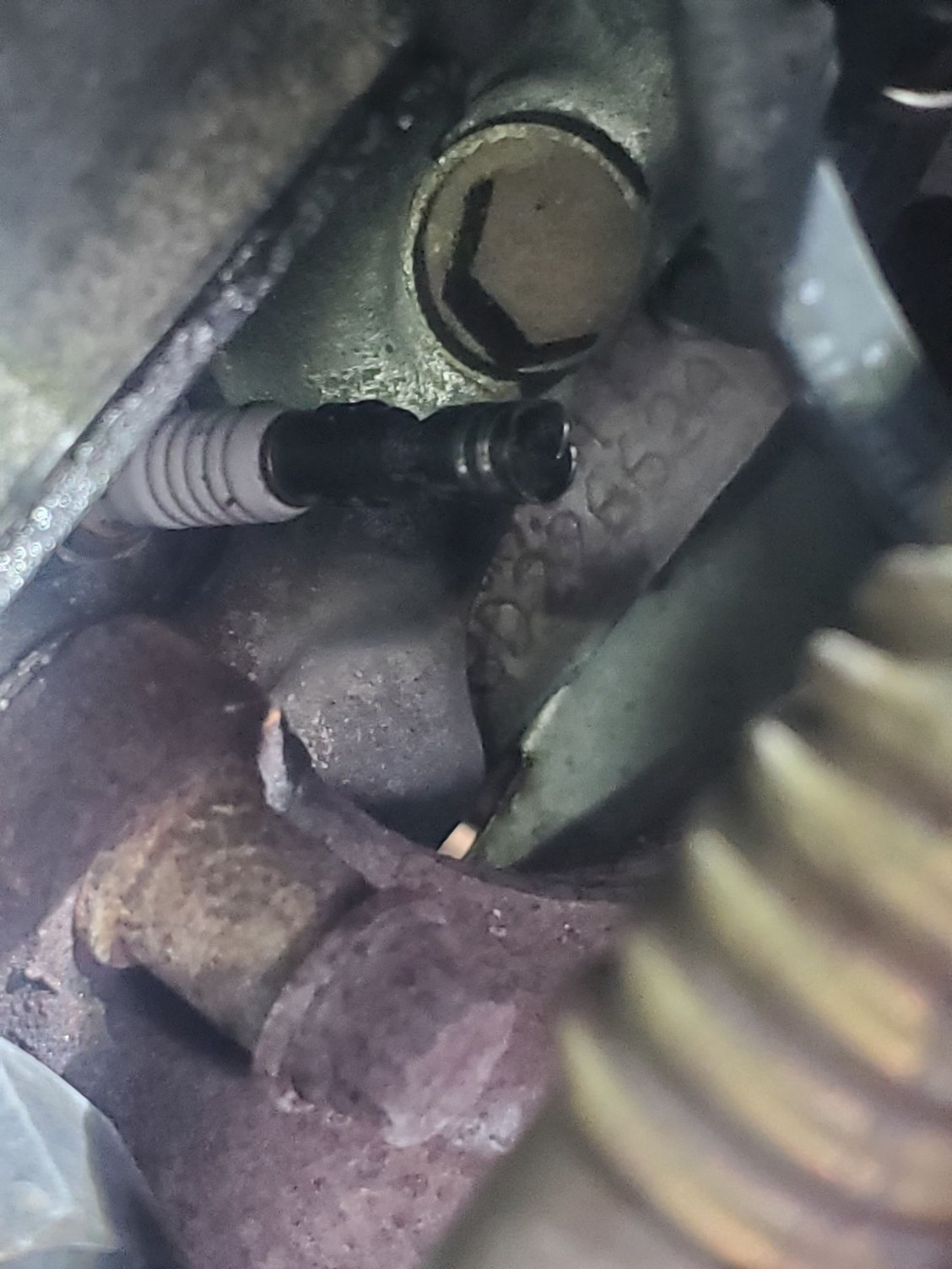

Thanks for the advice. I tried to pull the 3 wire off and it stuck to the plug. I got a set of wires tonight, will replace 5 and 3 (the busted one) swap the plugs and see what happens.

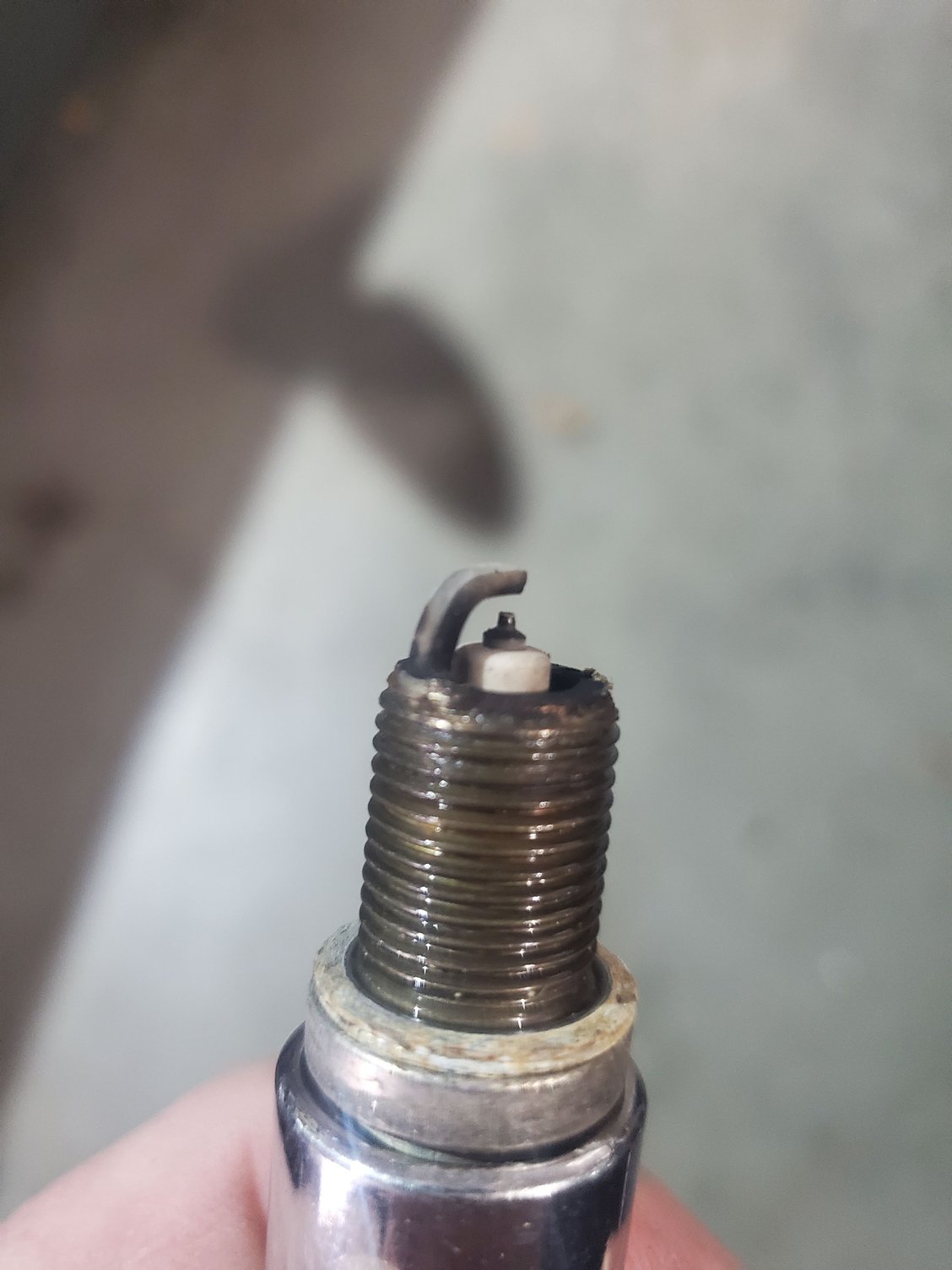

Swapped 1 and 5 plugs. The same cylinder 5 misfire. Which is surprising bc the 3 wire is actually broken, the other pic shows a piece of the electrode stuck to the spark plug.

I have no idea how anyone swaps wires without pulling the intake, i cant even see back there nevermind get a hand back there.
What are the odds that it is the pack, not the wire that is my issue. I would hate to get it all together and still have the code.
Is it a might as well replacement? S
I suppose I could plan on relocating the packs and leave them accessible. Most of the relocation kits include wires, which I already have.

If you install new coils, it's likely to NOT need new wires or coils for many years.
There's only a few plugs wire manufacturers that are quality.
The eBay and Amazon coils seem to hold up well and are cheap.
Before going that far, just for kicks do a compression test. Verify #5 is getting at least about 120 psi cold. If it's sub 100psi you could have other issues. Below about 90 psi she will set off a miss fire code.

You swapped plugs or wires? Or both? The idea is to do one at a time, so you can determine if it is the plug, the wire, or the coil. Now you know why I make a kit to relocate the coils (wires not included, but available if needed, and our kit uses the factory wires so if you already have a set no need to buy another one). Coil could be going bad, best test is to swap left and right.
