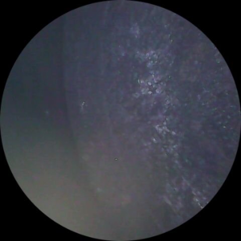

Pulled all the plugs, got 150-155 psi on cylinder 1,3,7
Wet tested cylinder 5, got 30 psi still, also holds that psi for a while. Maybe if I were more generous w the oil it would be different?
Does that Engine Restore do any good? There was a thread on here where someone used it to fix their cylinder 5 misfire. Clearly a temporary fix, but might we worth doing?
Plugs 7 and 8, below have some dark residue on them, the other plugs look great.
Photos below are cylinder 5, does not look steam cleaned, I suppose that only means coolant is not getting into the cylinder. I suppose a blown head gasket could still be on the exhaust side? Is that just a massive carbon build up on the piston? I generally run premium fuel for what that is worth. I did not pull photos, but it looks like the cylinder walls were evenly hatch marked. I could not see any unusual scoring.
Any thoughts on next steps? Pull the heads and see what I have? It currently runs, albeit poorly, if it is more than the heads, I think I need to get it to another shop, if it is the rings or other cylinder issue. Which raises the question of do I source another engine? We just replaced the rear frame and everything works, so I am all in on this truck. To a reasonable limit. I just bought a new Range Rover, which is pretty nice, I still love the Disco.
Is it worth tracking down a leak down tester? If it appears to hold the 30 psi?
I have tracked down a few machine shops to see who would be willing to take a run at these. I imagine it only makes sense to do all the valves? Should I bother with the passenger side, or just do the drivers side? Any repair kit seems to include both sides anyway. Or, it could always be something worse. From the above comments it looks like it is the head gasket. I have been waiting for this. 10yrs+ of discos and never had the head gasket job to do.

Time to pull the head. I'd go ahead and do both. Just had a small shop machine both my heads for 160 including refacing and sewing valves. That's price for the set.
Adding oil will boost the numbers if it's a ring issue.

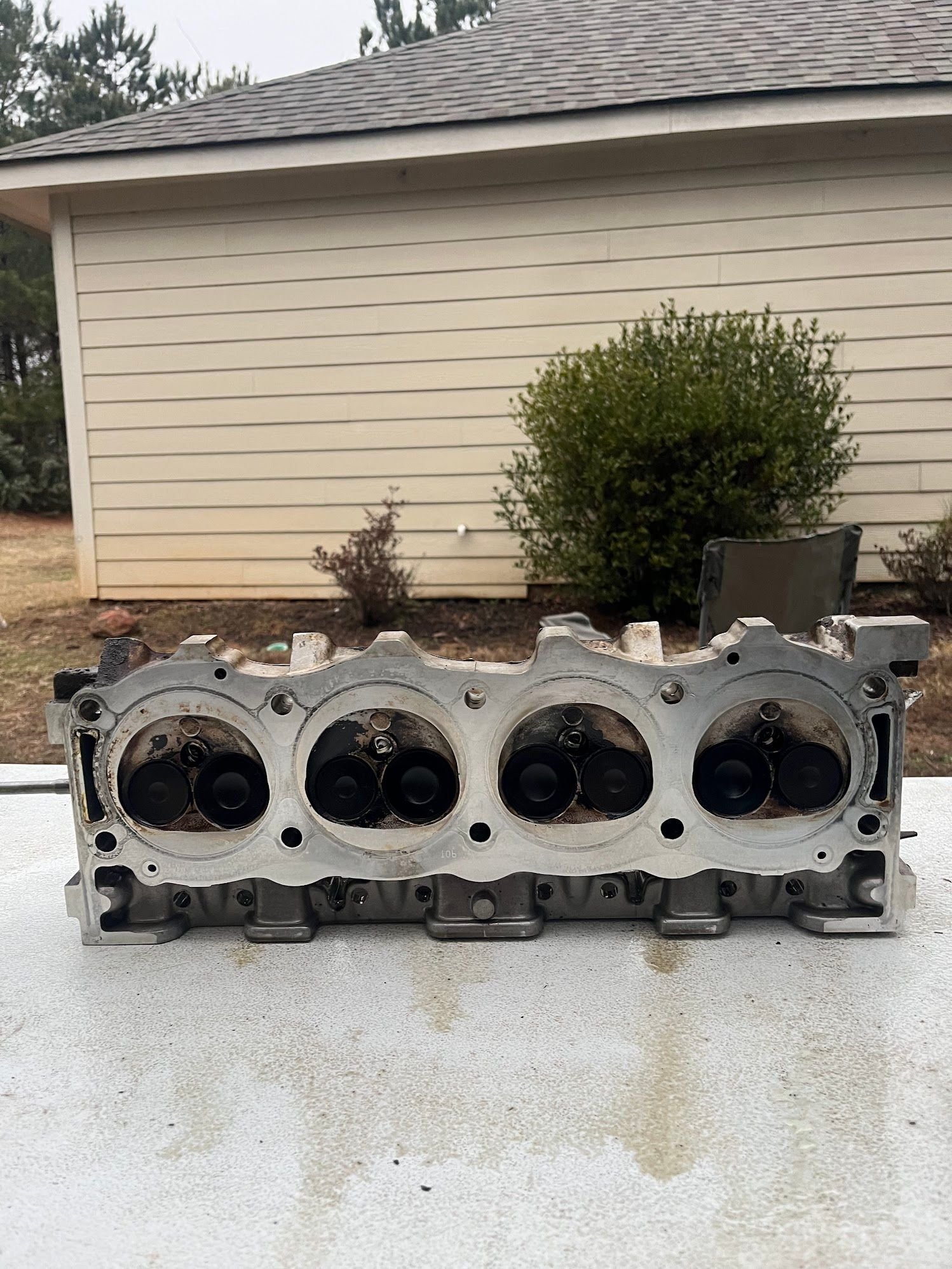

There is no water jacket passage between the head and block for the middle 2 cylinders on each bank, see photo below. It could be the exhaust side. You would probably be able to feel it if that was the case and you held your hand down there while running. But the blow could very well be between the cylinder and valley, see other picture.
