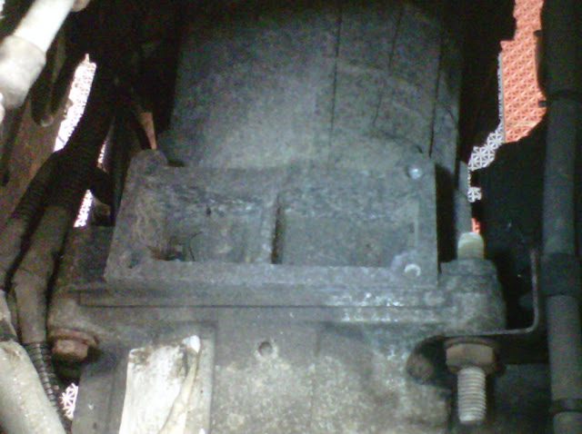

Hi All,
I'm in the middle of installing the D1 CDL into my '99 D2. I have the complete CDL, but just realized that I don't have the bolts to actually mount it to the 4 bolt holes on the top of the transmission. Anyone know what size/thread these bolts are? I'm guessing they're M8 x 1.25, but wanted to see if anyone who has run into this knows for sure...

Correction....I have a bolt that is M8 and (I'm pretty sure) 1.25 thread...that thread seems to be wrong. If nobody knows, I'll just run out and grab an assortment of M8 bolts with other thread sizes...

OK...it;s confirmed...I used 2 M8x1.25x40mm and 2 M8x1.25x30mm to mount the CDL shifter to the tranny. I also made sure to clean up the threads in the holes with a M8x1.25 tap before installing the CDL shifter...
