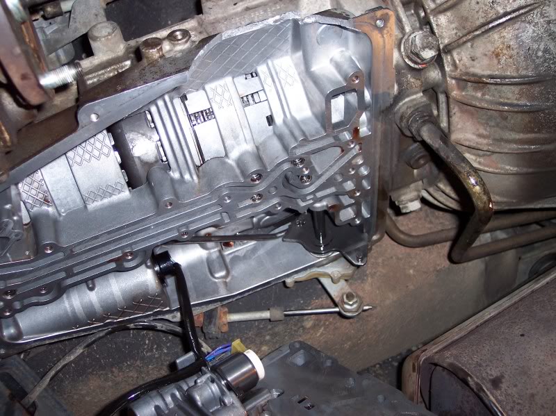

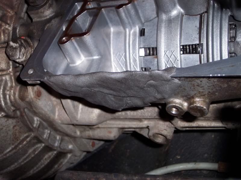

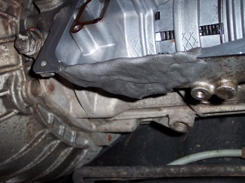

Ok, as some of you know, I decided to take the hillbilly route, and attempt to repair the hole in my transmission with JB Weld. I had to remove the valve body to get all the loose shards of aluminum that were still in there, and to have room to work. I started last night, and got the hole about 2/3rds repaired. I quit at dark, went to work this morning, and when I got home, went to repairing the rest of the hole. I used 1 1/2 sticks of JB Weld, and here is what it looks like:
Here is the before:

And here is after:
Now, there is some finishing to do, filing the edge down, and making sure the pan will seal correctly, but the hole is patched!!!

I am going to file that edge down a little bit and make it smooth. Hopefully the rubber gasket makes good contact with that JB weld. I might take some more and make the bottom edge a little more broad if it leaks. It was a PITA to get that valve body lined up right. I couldn't believe that I didn't lose any of the screws, and that they all got back into their correct holes, lol!
