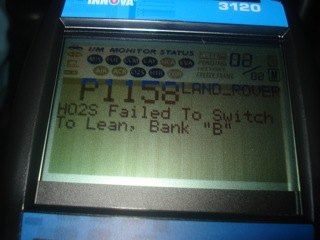

The truck was tuned in the last 60 days. New plugs and wires. New coil pack.
I use 93 octane gas. truck has 132k miles.
O2 sensors are original.
P0304 - Cyl 4 Misfire detected
The freeze frame data shows
STFT B1 -3.9%
LTFT B1 6.2%
STFT B2 3.9%
LTFT B2 6.2%
Eng RPM 2377
Speed MPH 62
P1158
HO2S Failed to Switch to Lean, Bank "B"
Old May 18, 2010 | 10:39 AM
osolupo's Avatar
Joined: Apr 2010
Posts: 13
Default Screen Shots of error codes P0304 and P1158

add coolant dye to the system and let it run awhile and check the plug for the presence of coolant in the heads. if it is there the engine block is ruined.

time for new o2 sensors
