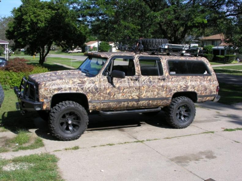

Here's what I Daily drive now which I build from the ground up! as you can see luxury and class is not why I looking for a LR, Guess I'm just getting older and what something more streetable but off-road capable. Will end up selling the beast and starting over with whatever I end up with.
