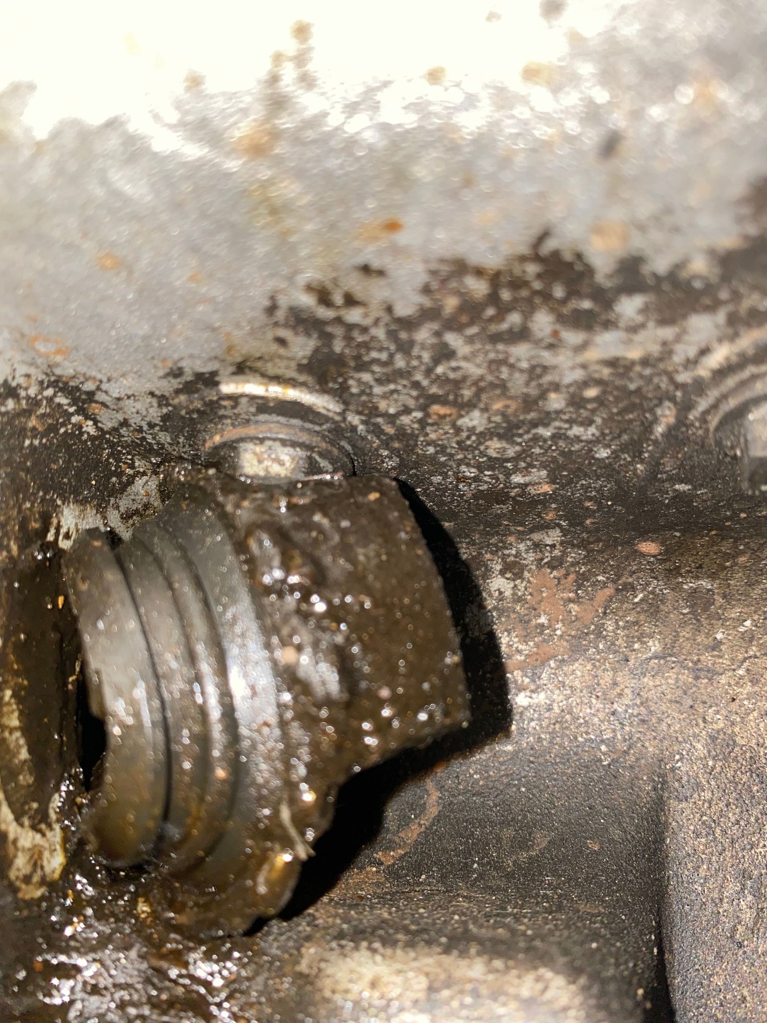

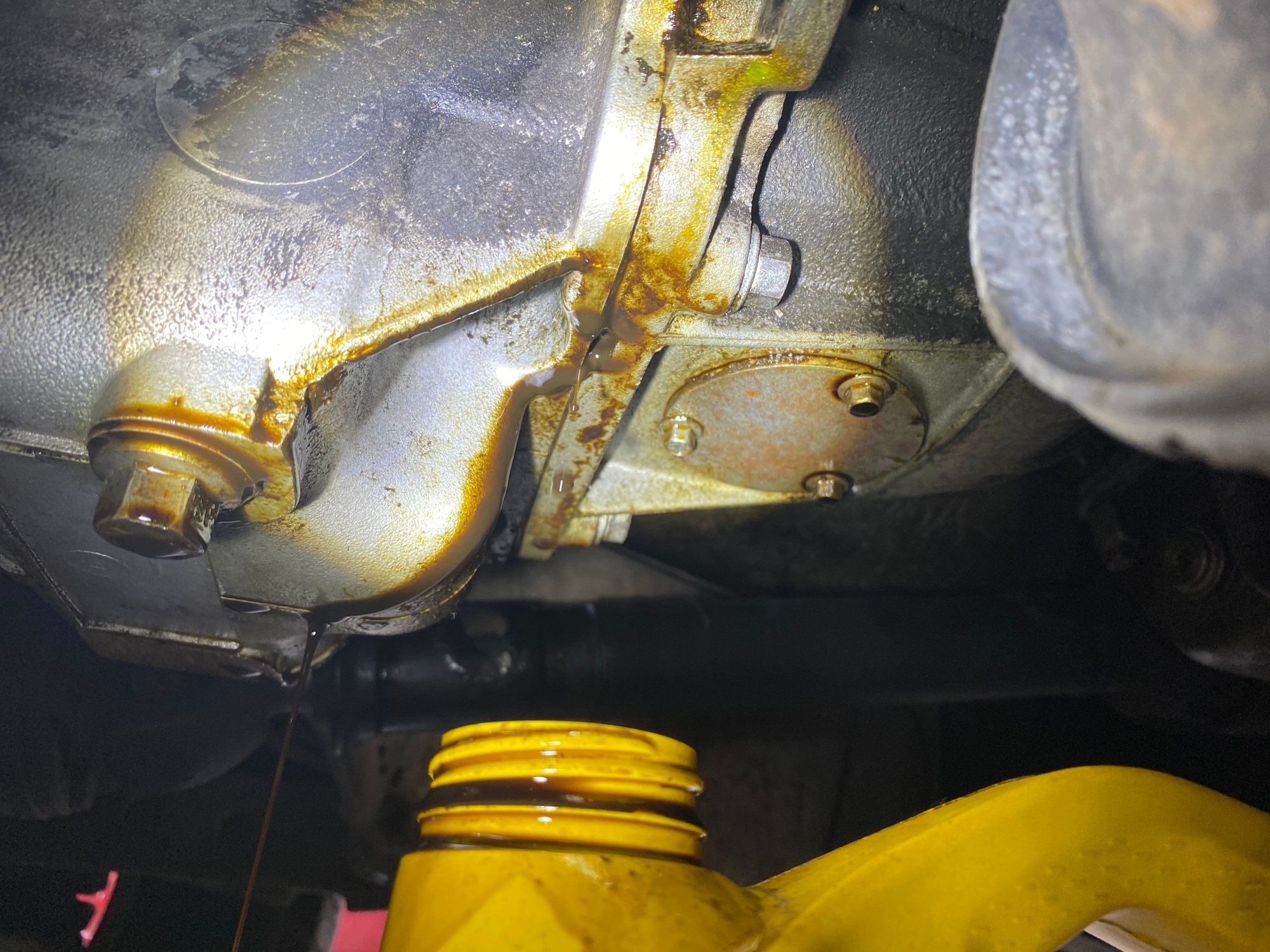

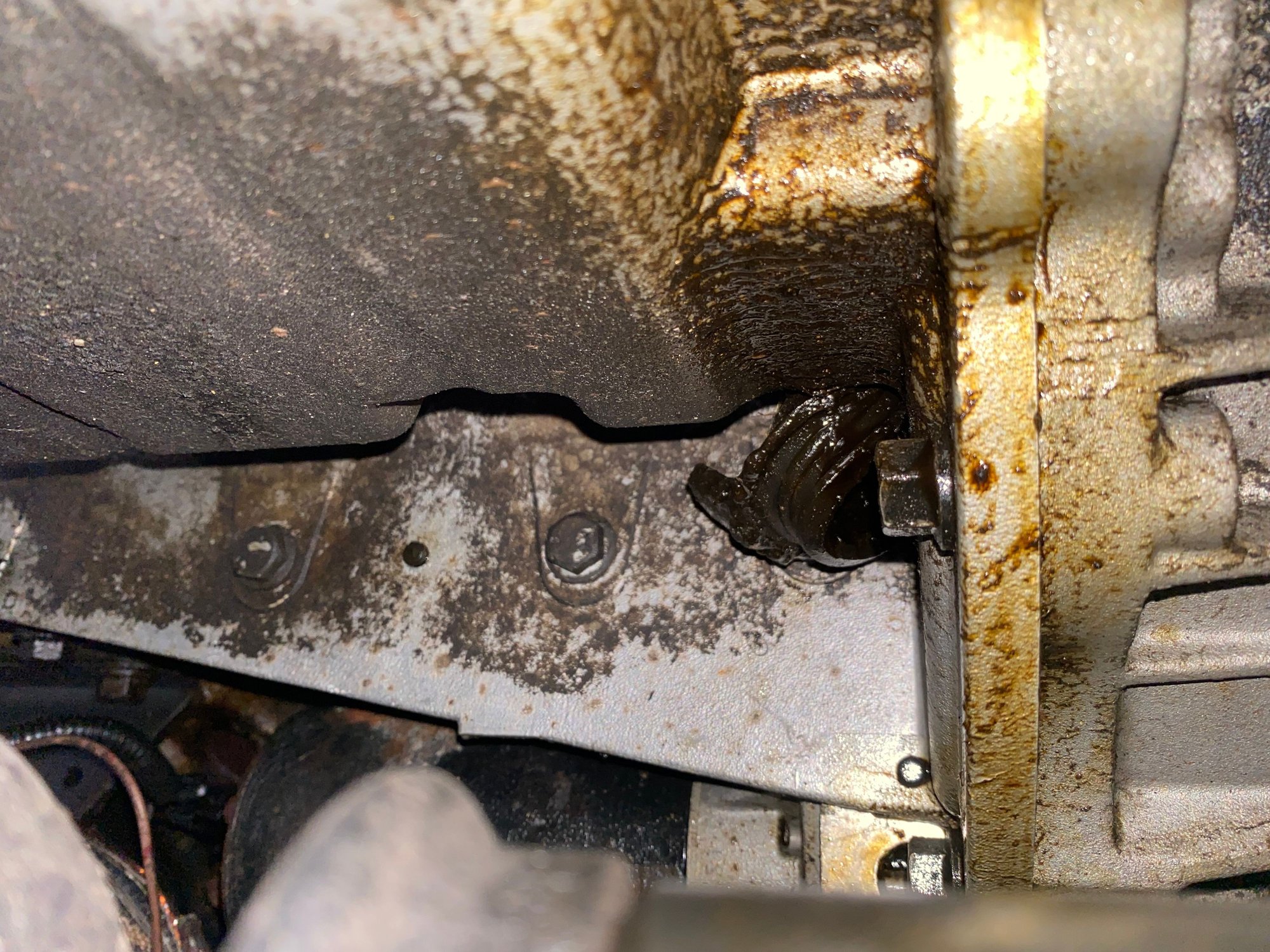

Posting for a friend. He bought a D2 a couple weeks ago and we are pretty dang sure the engine is toast now. Dumped oil out the bottom and it wont crank over apparently. He sent me these pics. Trying to find a cause but I know for certain the oil level was good as we had just checked it a couple days ago. I believe these pics are near the interface to the bell housing. Not sure if the cause, random part, etc. To me this looks like a random rubber boot of sorts and unrelated. I feel that maybe the rear main seal blew as the back of the engine was always oily but since it was also up high I assumed valve covers. Will head over in a bit and look at the truck myself I suppose. And I guess he is looking again for another cheap Rover project.

It did start but we feared low/no oil so we killed it fast. Not even long enough to see how she idles. Got it back home and added oil. Owner assumed it was out, dip stick was clear, and added 3 quarts and that actually put us way over. So not empty of oil but now with way more oil than needed and we found it pouring a small stream out the back. Of course did not start it again with that much oil. We pulled one spark plug on each side. One side was charged deep black the other pretty black, so lots of carbon fouling going on. We do know that the wires are arching in multiple locations, he checked the night prior cause of poor idle all of a sudden. I also noticed expansion tank for coolant was empty.
Suspect rear main seal and maybe a double whammy with head gasket blown. Either way its dumping and apparently consuming oil. If bad arcing can cause such a poor idle to carbon the plugs, then maybe just rear main.
Thoughts?
Edit: Found an Atlantic British vid on oil leak out the rear of the engine. This is the 4.0 V8 I believe. I think I will have him check the crucifix seals, can those be pulled with just an oil pan drop or is there more to it? It was not leaking oil before all this happened, at least not much. It sat for two weeks and there was just a quarter sized spot of dried up oil.

The first pics are just an inspection plug. It's not an oil seal.

Thats what I was thinking, especially now that I have been underneath.
We are going to use a scope later and overfill the oil and to see if it will rival the leak, depending on how much of the back end we can see with the scope. There may be some good news though, we think that *maybe* the truck died because of the poor idle which could be a separate issue. And when he tried to restart it he thinks in the panic he did not put it in drive. Got out and saw oil and assumed it was something big that happened. Fingers crossed. Also since this rough idle came up a dat or so again there is a strong fuel smell. I guess I will be learning all about these 4.0s...

  2. Remove the round inspection plate - the round plate in the last image if you have a blown remain or crucifix seal it may be fairly full of oil
