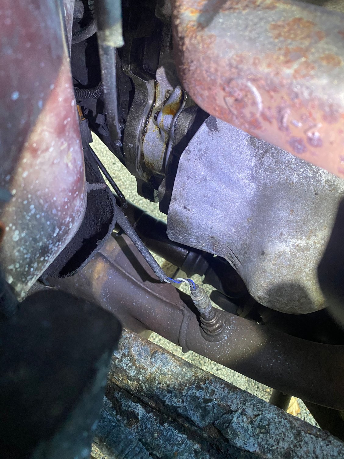

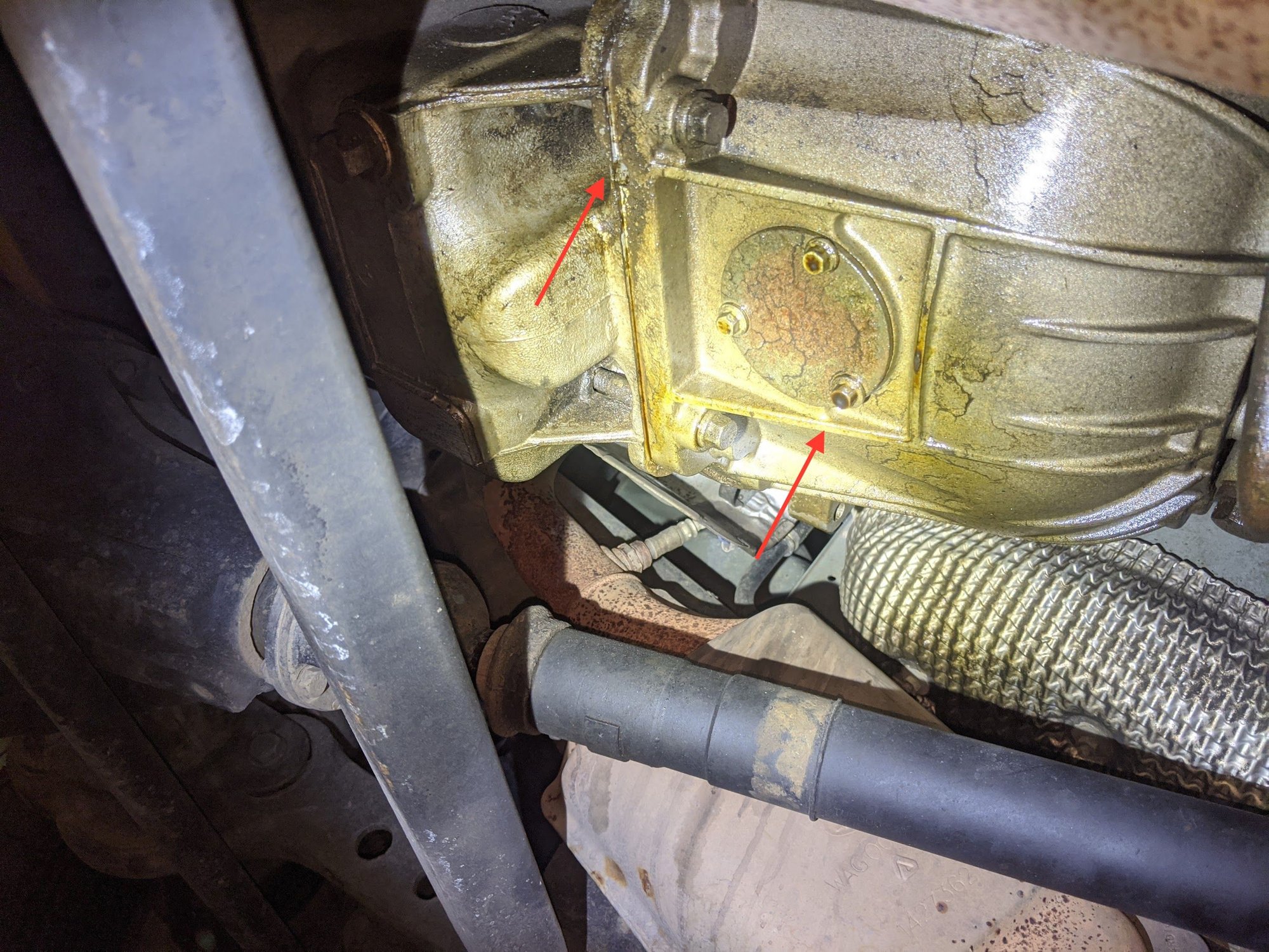

Can someone help me identify these items in the pictures below? I have what looks like slowish two leaks. I'm not super familiar with rovers yet so a diagram might be useful as well. I added arrows to show where I think the drips are coming from but I'm not sure if they are the source. I'm going to wipe everything down tonight and take it for a drive to see if I can get a better idea.

The first looks like the TC. Mine does the same, drips down onto the crossmember and gets blown back to the brake drum, and everything else to the rear. You’ll prob find that nothing is leaking inside the drum, it just collects there and drips down.
Next one is engine oil frame somewhere above. Valve covers, cruciform seals, etc.

Clean everything under there and see what comes back.
Have you done the PCV mod? Start with that to stop the valve cover leaks. Clean, clean, clean. Smell the fluid, engine oil is different and that gear oil.

Sorry I missed this. One smells like engine oil for sure. Looking up top I can see the valve cover is seeping a little bit. The P.O. had the valve cover gaskets changed less than 3000 miles ago so I was thinking about checking to make sure they are torqued to spec. The P.O. also did the PCV mod as well. Gotta pick up an 8mm star deep welds first.
I can't tell where the second one is coming from on the transfer case. Might have to drop the whole thing to figure out. I'm kind of waiting for my front prop shaft to get here so I can take everything down at once.

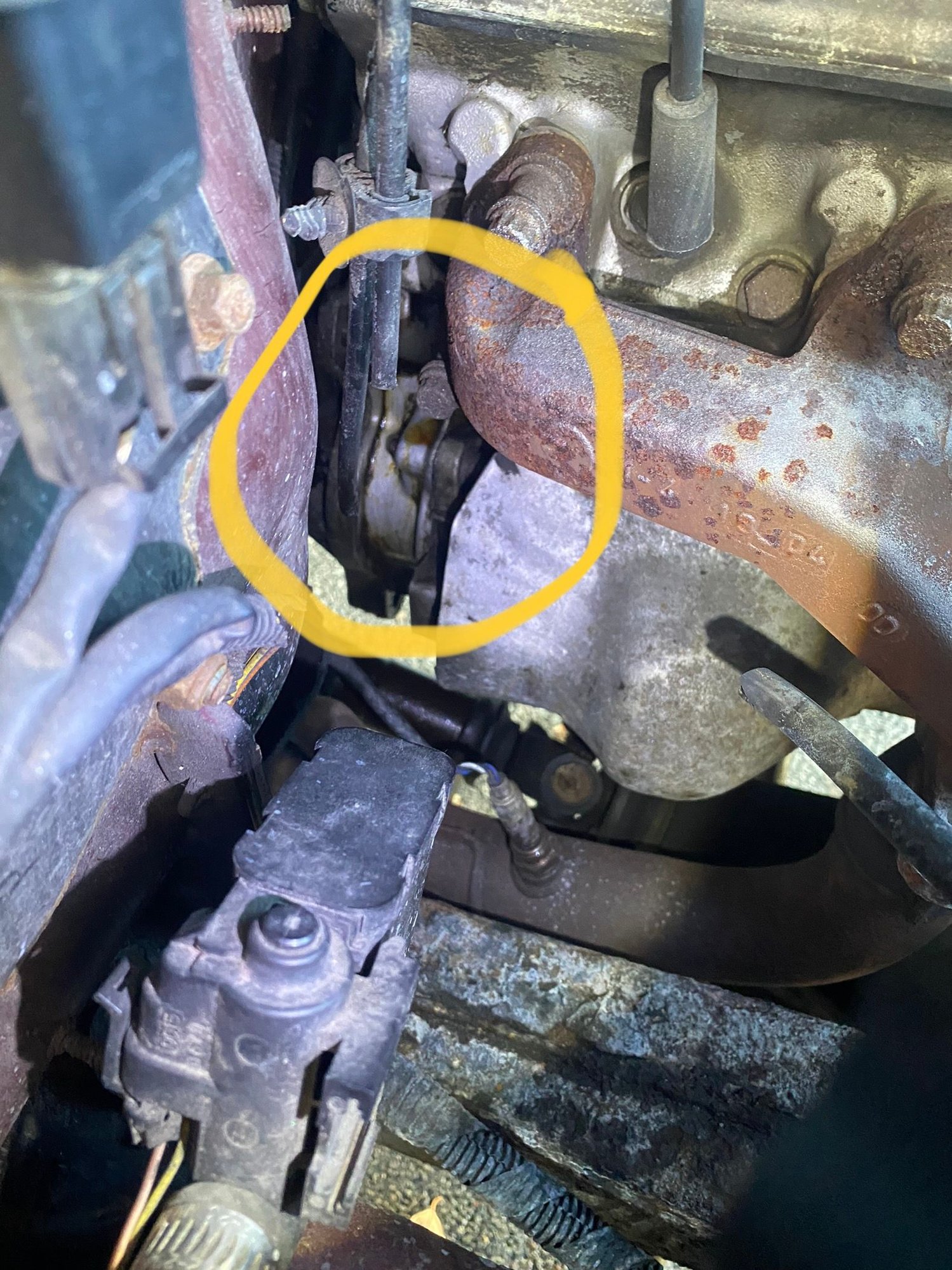

I have one circled in yellow. Someone kindly sent me a rave manual but it freezes when dl on iPhone. So until I get to a desktop, any help on what this is exactly. Seems to be oil.
