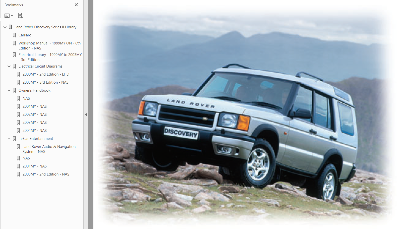

Originally Posted by Jon.P
ok but they are both in the rave 🤷🏽‍♂️
If you use the index system in the RAVE, it's an easy assumption that some of them are probably earlier editions, maybe kept for reference but not linked because the later editions have updated information.

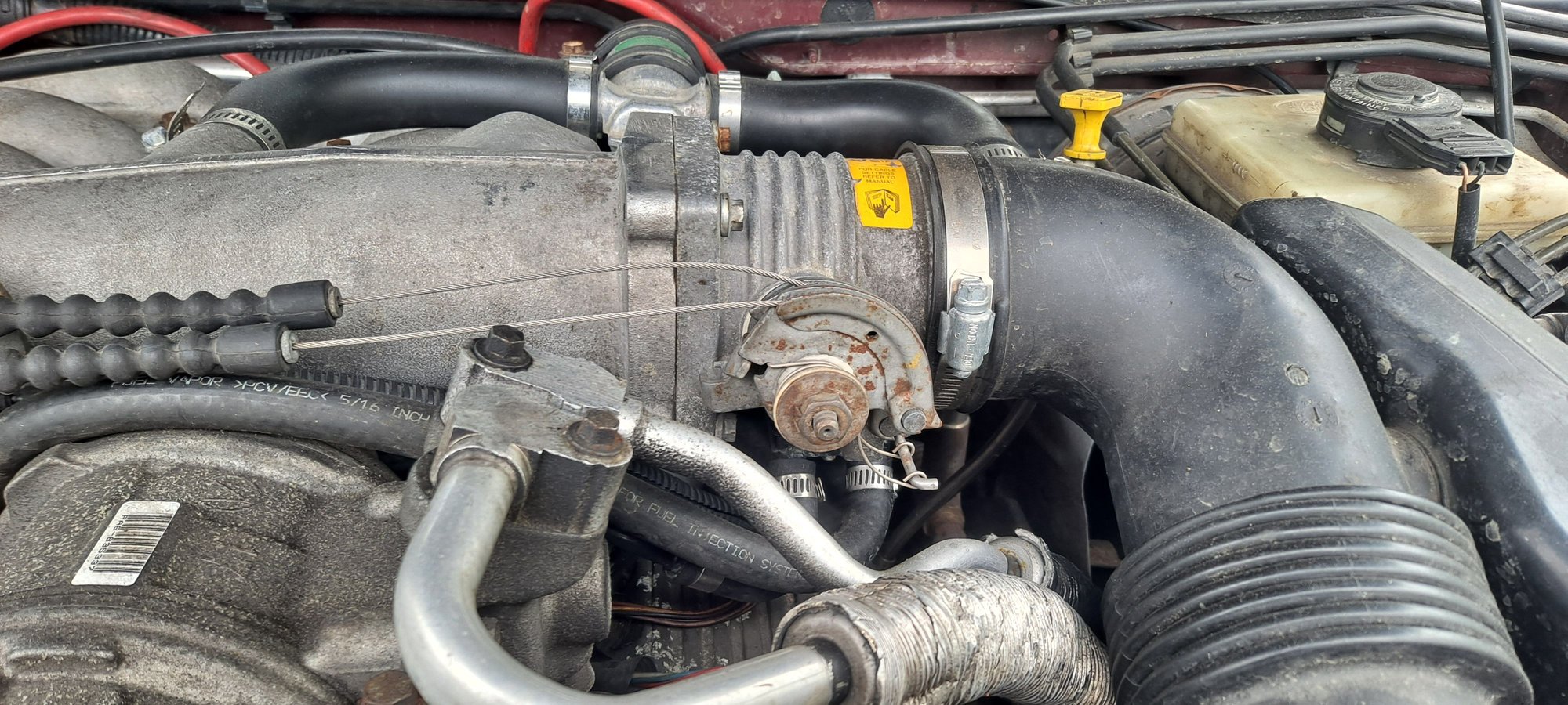

As I already said, I think the 4-4.5mm specified in the manual for the cruise cable is way too loose. I have mine about as tight as the throttle cable -- basically no slack at all. There's a little bit of surging at some speeds but nothing drastic. If it bothered me, I would play with the adjustment until it improved.

I have not taken it for a ride yet, but I think I figured out why the Cruise Control is not working.

Yep. There’s your problem.

yes, I had some work done two years ago to cure a running lean condition I could not find. The guy had to remove the enture intake and replace a gasket. I guess he never tightened up the CC cable. I rarely used it before because it would surge, but now I need to give it a test to see if it works smoothly or not
