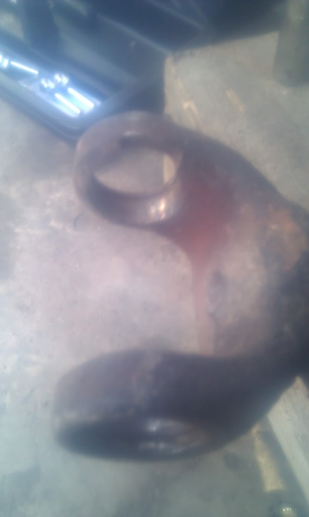

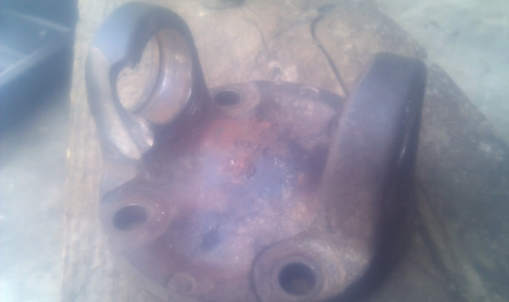

Howdy, I am from Dallas and own an 03 Disco SE with 80K miles. Bought it used back in late 08 for a steal and love it. When it works it's an amazing vehicle, but when something goes wrong, it really goes wrong. I recently felt a very violent shaking whenever I was accelerating. Due to some reading and my dad's help, he figured out it was the u-joints. Today we took the front drive shaft off intending to do the rebuild that is discussed in depth on this forum. As we inspected, we noticed the slots that the u-joints go into on the yoke and the carden joint are broken. So after calling around we discovered that these parts are not sold separately. I have decided to go with the Tom Woods conventional double carden drive shaft.
My Landy:
The problem shaft:
As you all can see, I am very lucky to have caught this when I did. This was right on the verge of causing a tremendous amount of damage. At first I thought it was steering wobble.

Hmm my 98 D1 suffered the same prop-shaft failure! Wonder if these stock shafts should be recalled?
