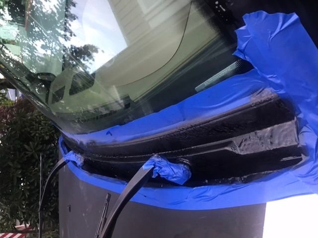

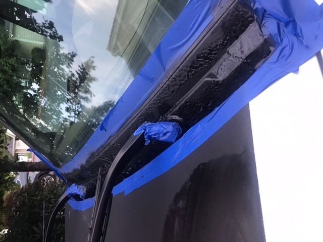

so the cowl has a crack down the middle. Which is likely where the water is seeping into the passenger front footwell.
being on a budget (other car project is jumping priority). I decided to use the Dupli-Color bed liner spray. It turned out as expected. And the crack/gap is now sealed.
pics are from tape up. To Tape being removed. Took 30 minute to apply.
Taped off and bed liner spray applied
Another angle
Removing the masking tape

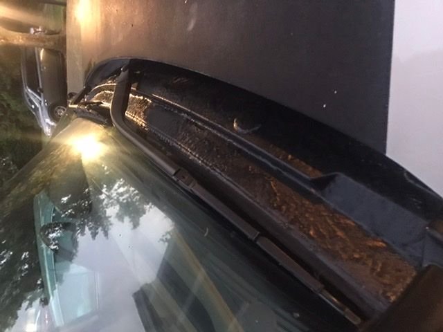

Passenger side. Light reflections at Dusk, showing the expected wrinkles
Summary:
2” wide masking tape roll.
2” wise gorilla tape (covering crack/gap)
1 can of dupli color bed liner.
1 small tube of black window/door gasket.*
(used the gasket as the foundation of the gap/crack, then put the gorilla tape over it 20 minutes later after it settled). Then applied the bed liner..
$30.00 repair until I can order the replacement cowl & new retro D1 wiper arms.
