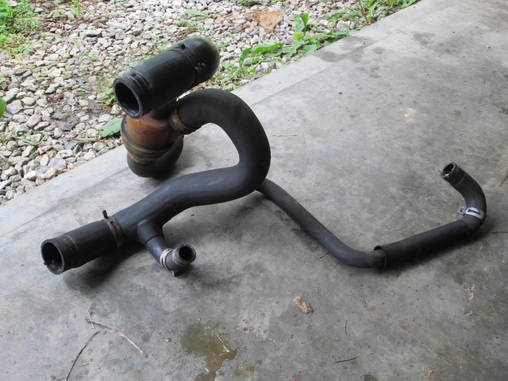

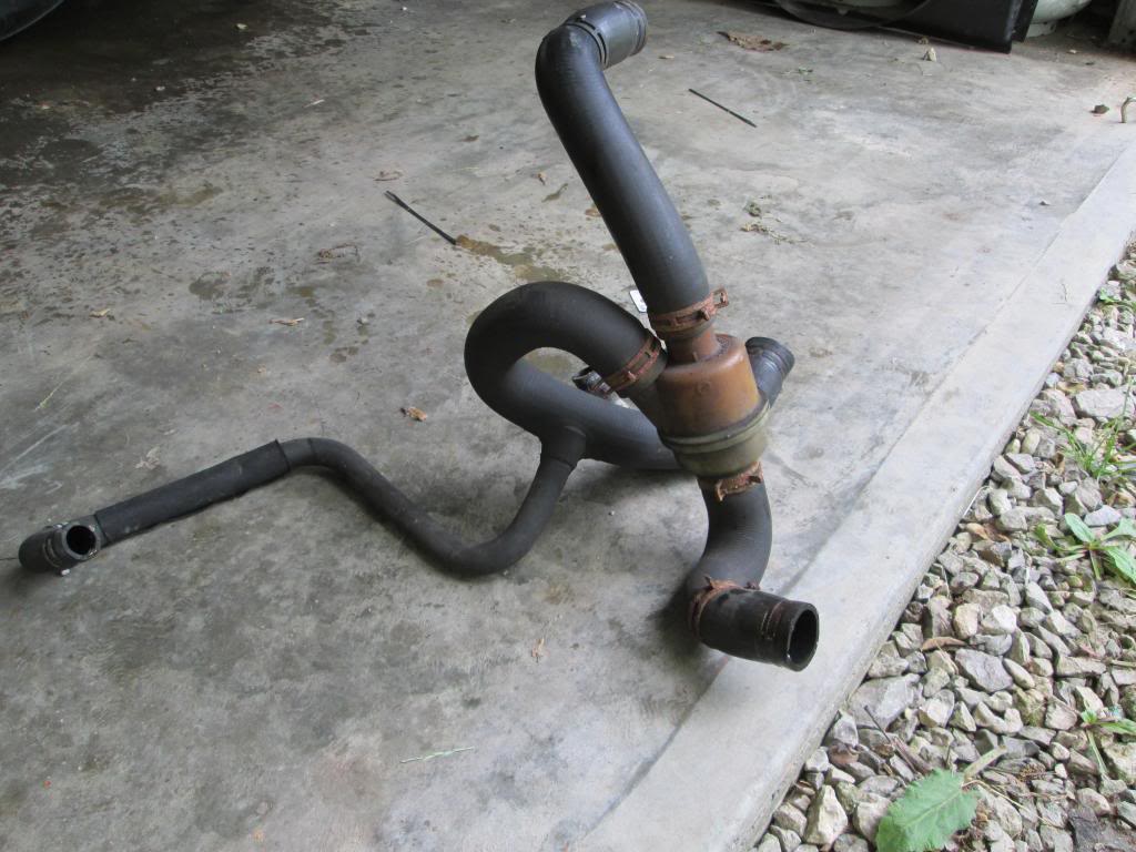

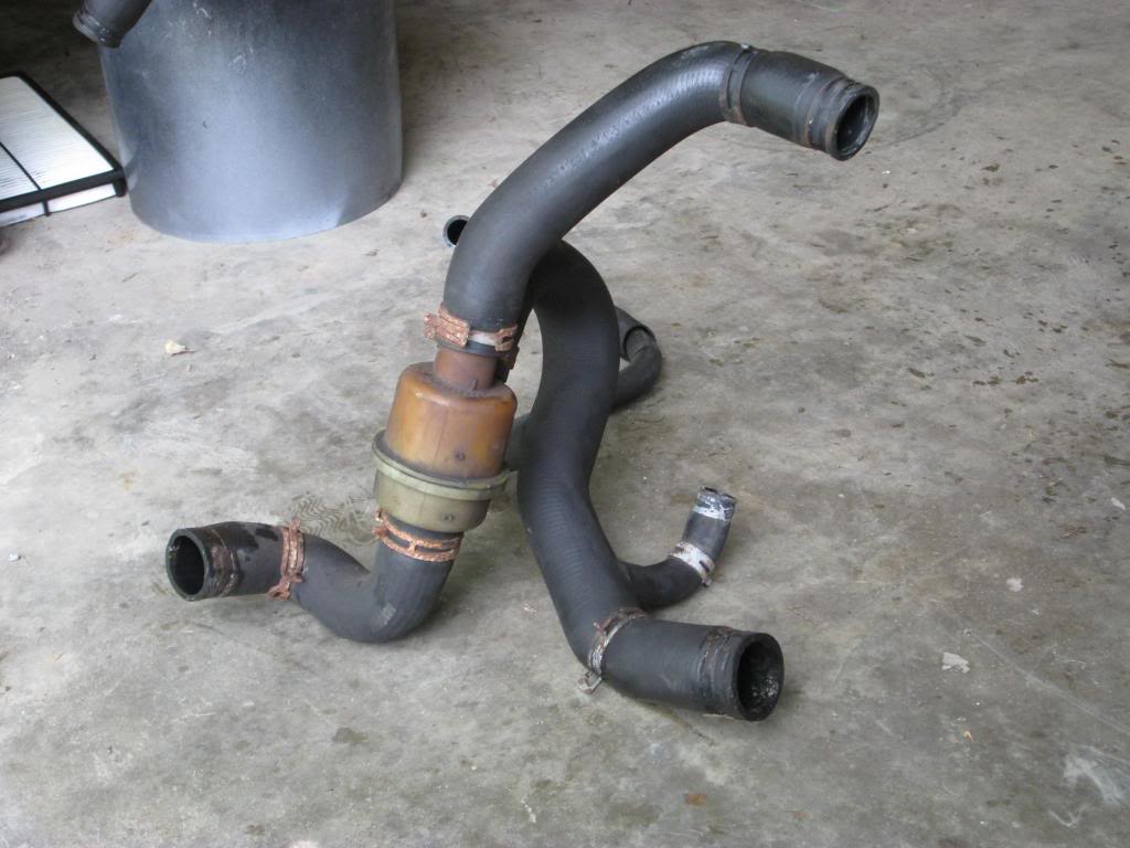

I hate to bring up an old thread but I have one small issue with this mod.
I ordered the parts based on this page that discusses the mod.
Inline Thermostat - LAND ROVER CLUB V.I.
I decided to spend my Sunday completing the processon my 99 Disco 2.
So I tore into things only to realize that my disco is missing a vital part to this modification.
As you can see from my assembly I do not have the plastic splitter manifold thing shown in this pic.
I have not really looked at it too hard yet to see if I can make something work.
I thought I would check the nets first and see if anyone else has found a solution.
Obviously the thing to do would be buy the "tee"/"Y" thingy but so far I have not been able to find it on its own.
It is part of a $100 coolant hose assembly.
I would prefer not to do that if I don't have to.
Anyone have any ideas?
Sorry for the sideways pics. Photobucket really blows these days and I can't make them show up straight.

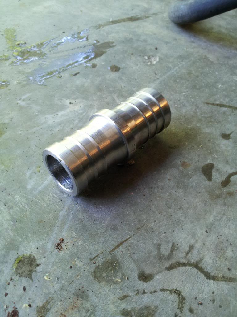

I bought this piece from McMaster-Carr
It is stainless so corrosion will not be an issue but there was also an aluminum version available.
I got the one for 1-1/4 ID hose.
It is a little small but I think it is big enough to work.
This one cost me $27 but the aluminum one was only $16 and I found a stainless one on ebay for 5 or 6 bucks but I did not want to wait on it to ship so I had the one I got shipped overnight at work.
Anyway it fits where the stock T-stat was.
Like so...

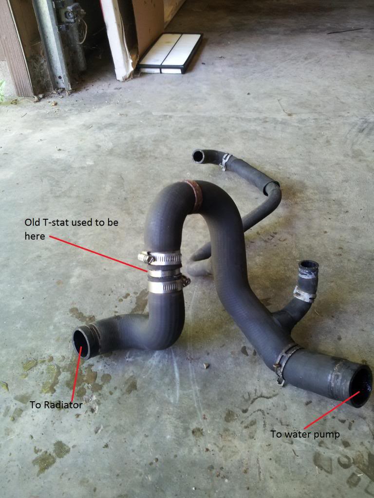

With this you can skip the BMW hose that is needed in the other write up.
I have not worked on the upper hose stuff yet but I will either use the left over lower hose piece and the BMW hose I already bought along with the stock upper hose and fit it all together or I will go to the local parts store and find a suitable hose that has a suitable bend in it to make it all work.
As usual I will post up pics when I get there.
