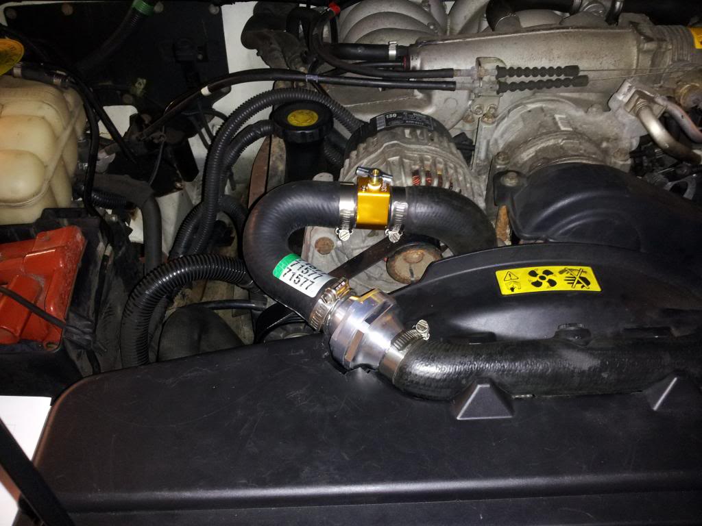

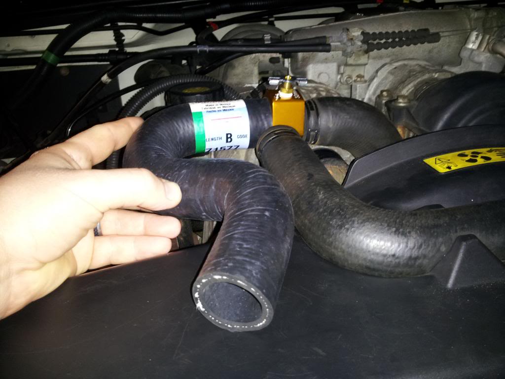

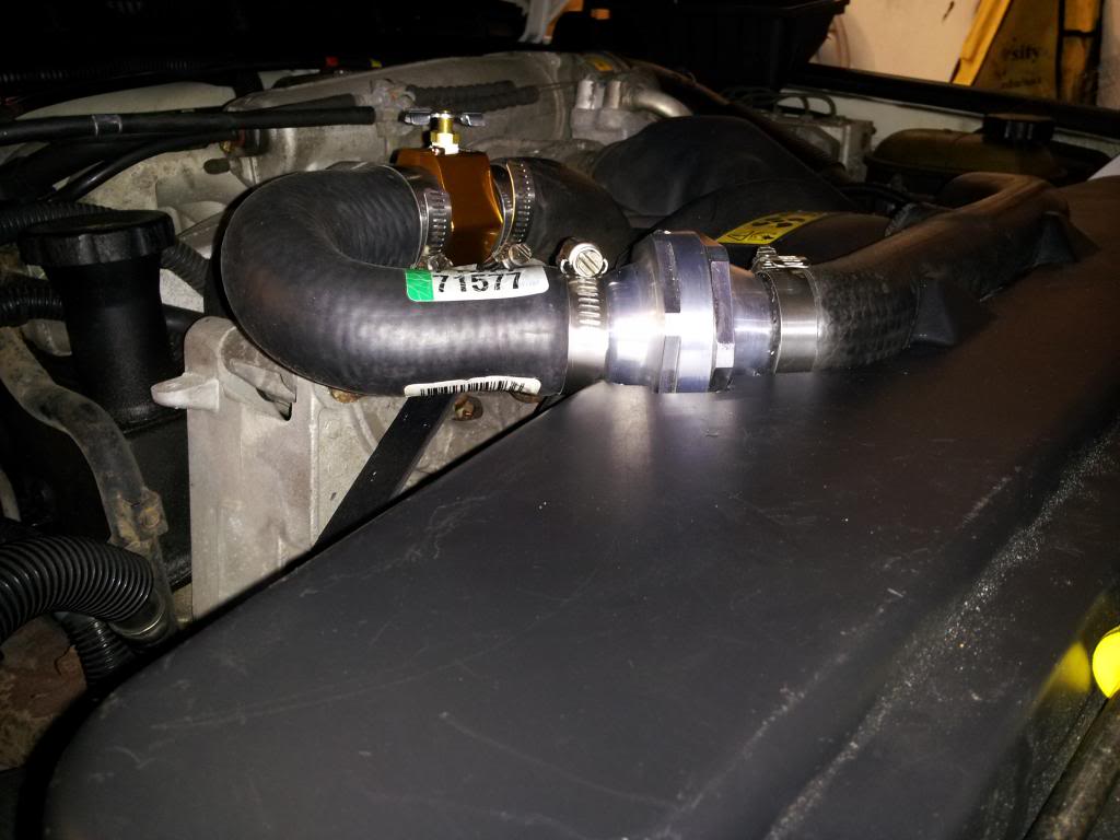

Ok I wrapped up my version of this mod.
I did have to buy a hose that had the necessary bend in it to complete the upper hose section.
It is Dayco Part numer 71577
Oddly enough I cannot find what vehicle this hose is for.
It just seems to be some generic hose.
It cost me about $14 at advanced auto parts.
Any way I cut this hose as well as the factory upper hose and put it all together like so.
I put it all together and took it for a spin.
So far so good.
I guess only time will tell.
