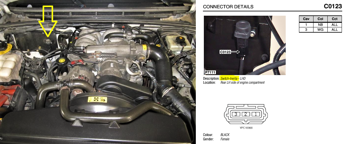

Try resetting the inertia switch ( just press the top down ).

I just tried and there is no change. i forgot to mention that the oil and battery lights are on, the oil mostly spilled out when it was upside down and the battery is connected firmly and testing well
