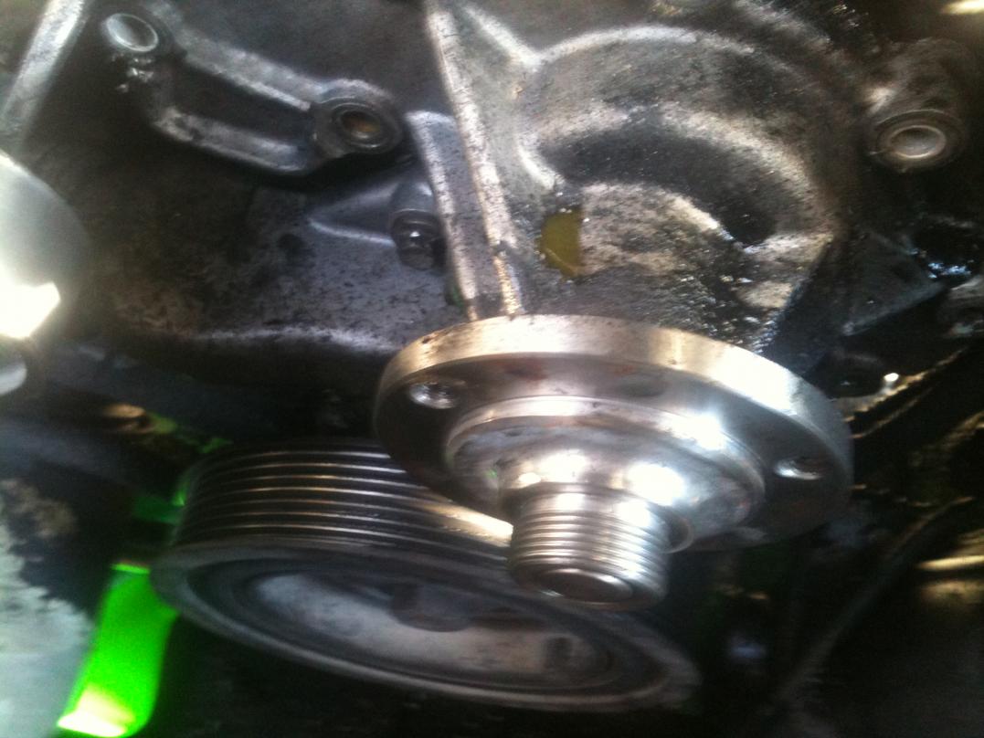

Gents, I've managed to strip the head of one of the bolts holding my water pump in. As you can see from the picture, it's one of lower 10MM bolts, just to the left of the pulley. Not much room there to work.
What tool do I need to purchase in order to get this bolt off? If calling is easier, I'm at 339.293.9352.
Picture on its way.
Here are the pics:
Attached Thumbnails Dangit!! Stripped bolt while removing water pump-img_0733%5B1%5D.jpg   Dangit!! Stripped bolt while removing water pump-img_0732%5B1%5D.jpg

no pix. Right angle drill and easy outs? Or take off entire front cover leaving some of that stud still exposed so you can grab it with vise grips etc. May have to remove radiator to get some extra room. Or parts store for one of their highly prized and seldom used tools. Obviously, if there is something still sticking out that gives you something to work with, along with Deep Creep or PB Blaster, maybe even some heat. Relax, you'll have it back together by Christmas.

Not funny! :-) I'm trying to get this back together before sundown. Just put the pics up. What are one of those highly-prized/seldom-used tools that you referred to? What are they/is it called? I'm ready to head to Sears. I don't mind a few esoteric tools in my toolkit. I've got tons of them, now! Stuff my Dad used when he was alive.

Get you a torch and heat the head of that bolt hot it will soften up enough to beat a smaller socket or wrench on to it. Then give it a little cool down time and try to take it out, remember as you heat and soften the metal that to much force will snap or twist the head off the bolt so be gentle and take your time. If you do twist the head off the atleast you will be able to get the pump off and then get a grip on the stud itself with some vise grips and turn it out if there! If infact you do break it off let me know and u will send you a replacement bolt if you can wait or if not go to hardware store to match up a new bolt. Good luck and happy holidays my friend!!!

lr2001silver, the torch/3/8" socket did the trick! Sadly, I realized once I got the water pump off, that it wasn't my problem....I'm officially in head gasket Hell. Thanks for your help, bro!
