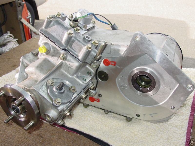

Here is a picture of your t/case, look for the round plate, held down by 3 bolts and the shift nipple in the center of it. If you have that you can hook up a linkage and engage the CDL, without it you can't use lockers although you can add it to your current t/case.
As for the T.T.'s front and rear, they work well together and cost less and don't require any HD axles other the stock 24 spline.

Forgot to send you the pcture, let me know what you find.

Just had her up on a lift, and the CDL is not fitted, the t/case is flat and NOT machined out with that flat that the CDL is bolted to.
Is it a big job to fit a CDL t/case or is it a job better given to someone that has done it before?
Also, do you happen to know the part No of the CDL part of the t/case so I can startt looking.
