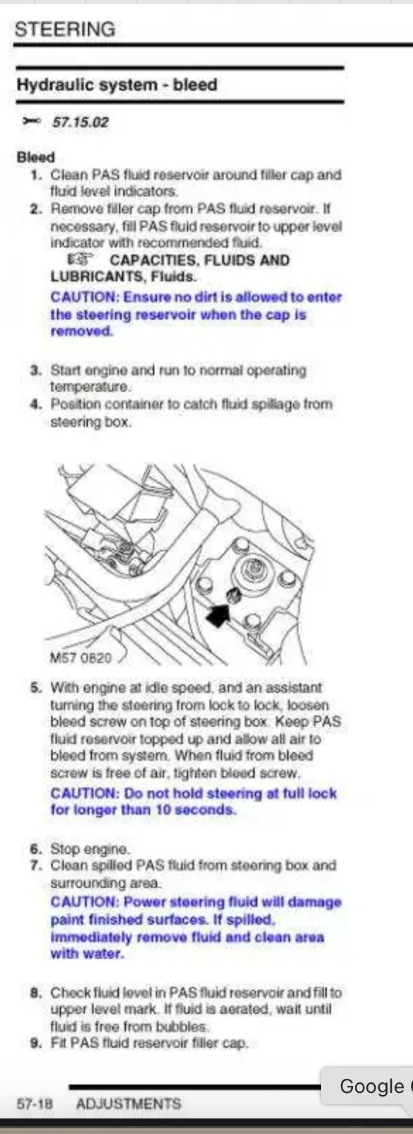

You did bleed the air out of the nipple right? I seem to remember that will cause it to not work well at idle RPM? The nipple on top of the steering box. Instructions below.
If so, There are bad pumps out there.
I think a collapsed hose is possible but -- hoses usually collapse under vacuum not pressure (or if kinked or bent).
Failing all that. Thinking about what might have been jostled from changing the pump...
-- Is either of the supply or return hose perhaps kinked in a weird way?
-- the serpentine belt def routed properly / pump turning the right direction (not even sure if possible to do it improperly but I do know on some cars it is indeed possible to go the wrong way round idlers and components and the belt still fits
