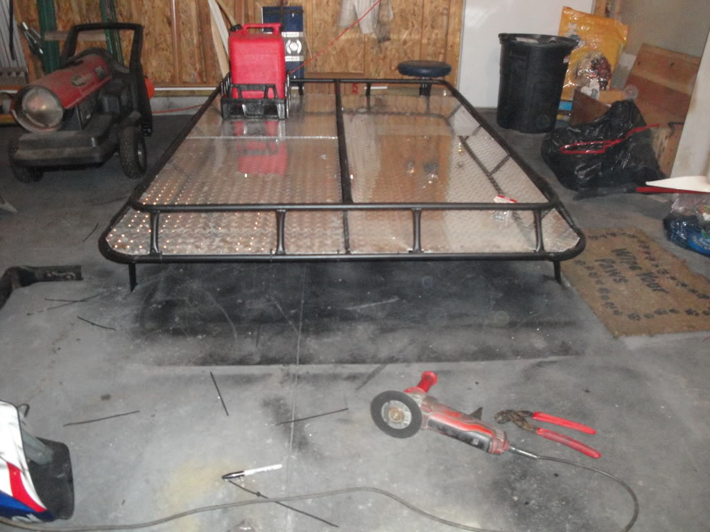

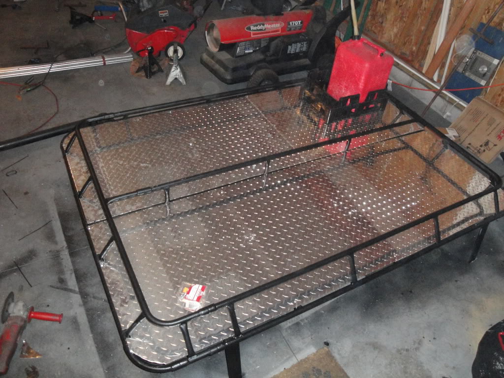

hey guys.
as you might have known... i've been making my own roof rack/basket... things rely picked up when i found a pre-made basket in a junkyard for 40$ and after i welded the mounts to the baske i decided i'm throw a floor on it... i was debating between steel/aluminum extruded fence or diamond plate... i still need to paint the rack but you'll get the idea...
you can tell which one i went with

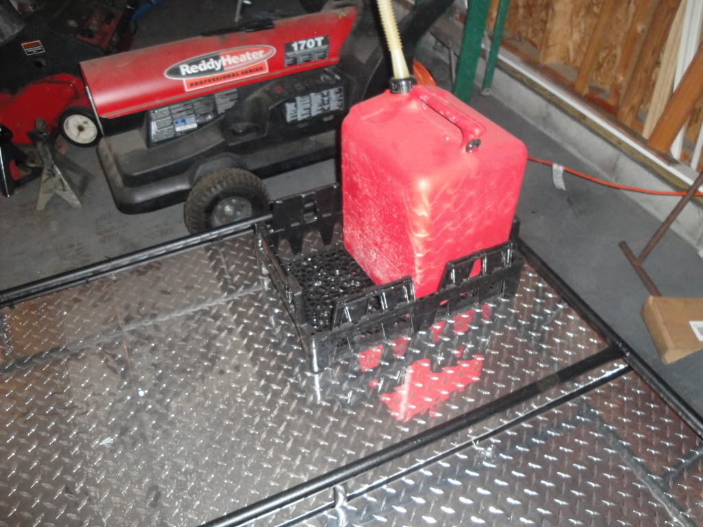

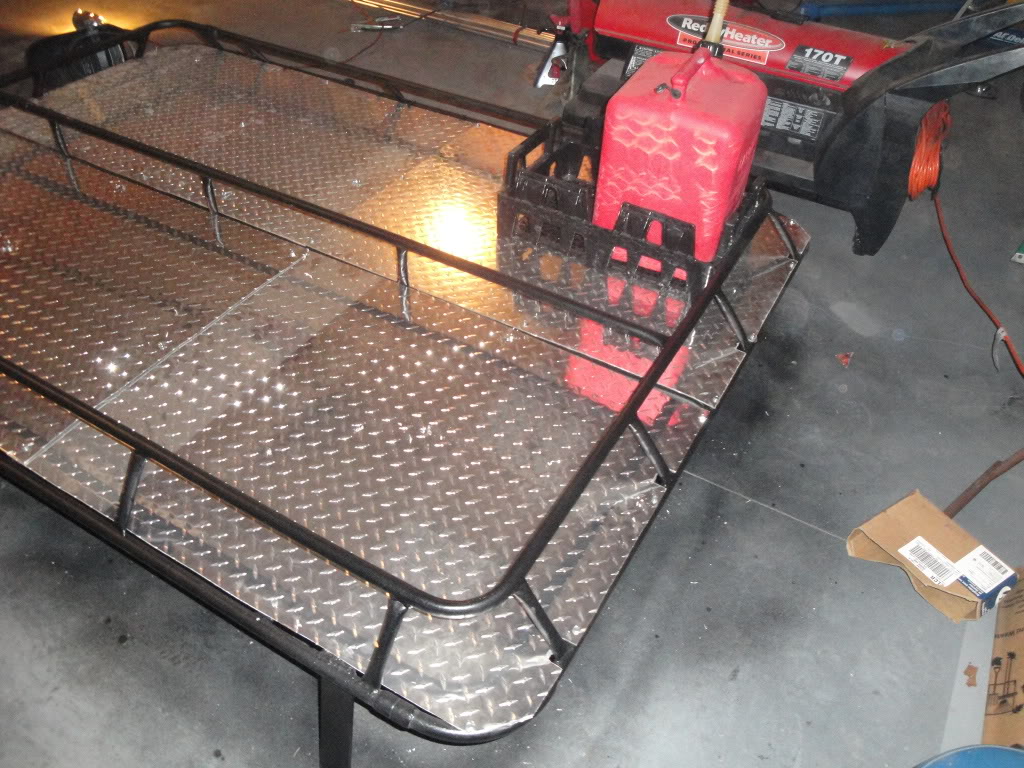

here is the finished product as of 4:40am wow these late night projects make me feel sick ... maybe its the paint fumes? BTW the gas can holder... is a container i got from the backend of a CVS pharmacy!! its made to hold pop and such... but it works for my gas cans also... enjoy

Well, it looks very interesting. I would point out, however, that you have just created a very large wing. You may have unexpected results at hwy speeds. You may have noticed that other "commercial" racks have wire floors - I think there is a reason for that.
My thoughts exactly when I saw that diamond plate. You may want to rethink that flooring on there. I've actually never seen a rack that didn't have woven wire flooring.
You may also see a significant decrease in gas mileage as well!

well its 180 $ worth of metal ... so i'll try it out... but from what i can tell the metal floor isnt moving!!!!

I don't think you're gonna have any trouble when it's loaded, but yeah, when it's not, you're gonna get some serious lift off that thing. You should really be careful before you get it up to any real speed.

just cut some vent holes or slots in it.

+1 cut holes in it... not only will it let the wind thru but it will give you some areas to attach things. another reason people use chicken coop flooring so they can strap stuff down to floor
