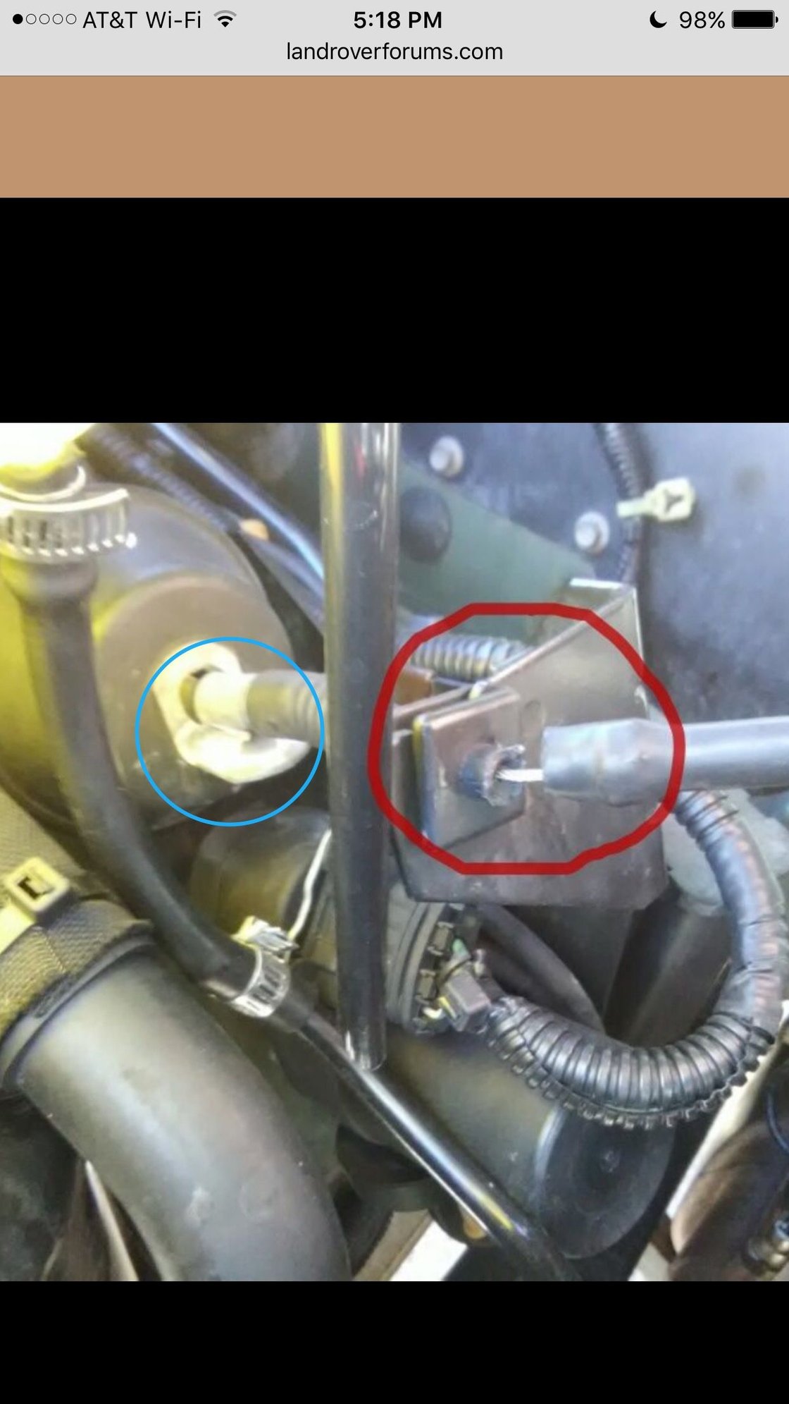

The blue circle shows where the final end of the linkage attaches to the cruis control actuator. That "L" bracket is held in place to the rubber actuator by 2 plastic pieces. That's where mine broke. Have you checked the actual cable by the throttle body to make sure the springs and all are still ok?

The cruise control linkage is on the left. The return spring could have broken or came loose
